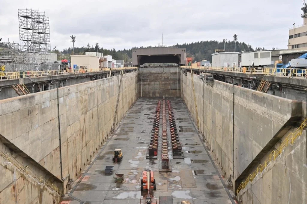

      The hull was mounted on 45 keel blocks, as opposed to "railroad ties" which always look cheesy - especially on the expensive "high-end", "museum-quality" models.
      Can you elaborate on the Nautilus models "keel blocks"? I'm familiar with the detachable keel blocks on the Hunley, but not on the construction of the Nautilus keel.

        Here's a keel block shot for my latest 1/72 hull:
        The hollow centerline blocks are also topped with pads to prevent the hull from being scratched and when compressed, look like another layer of old wood. I run two fasteners through the centerline blocks to keep them hidden. This looks a lot more realistic than square railroad tie-looking pieces of wood placed length-wise across the beam. I've seen high-end models where some don't even contact the hull; at $60 to $80 an inch, they need to up their game.
        Here's a shot of the drydock at Trident Refit Facility, Bangor, where I used to work, showing the keel block arrangement for a Trident class submarine. Getting the spacing right is critical before the ship floats in or bad things can happen. Cleaning the remaining fish out of the basin was always fun for the Tank Blasters. Lugging heavy equipment up and down the built-in steps when crane support wasn't available was always a work-out!

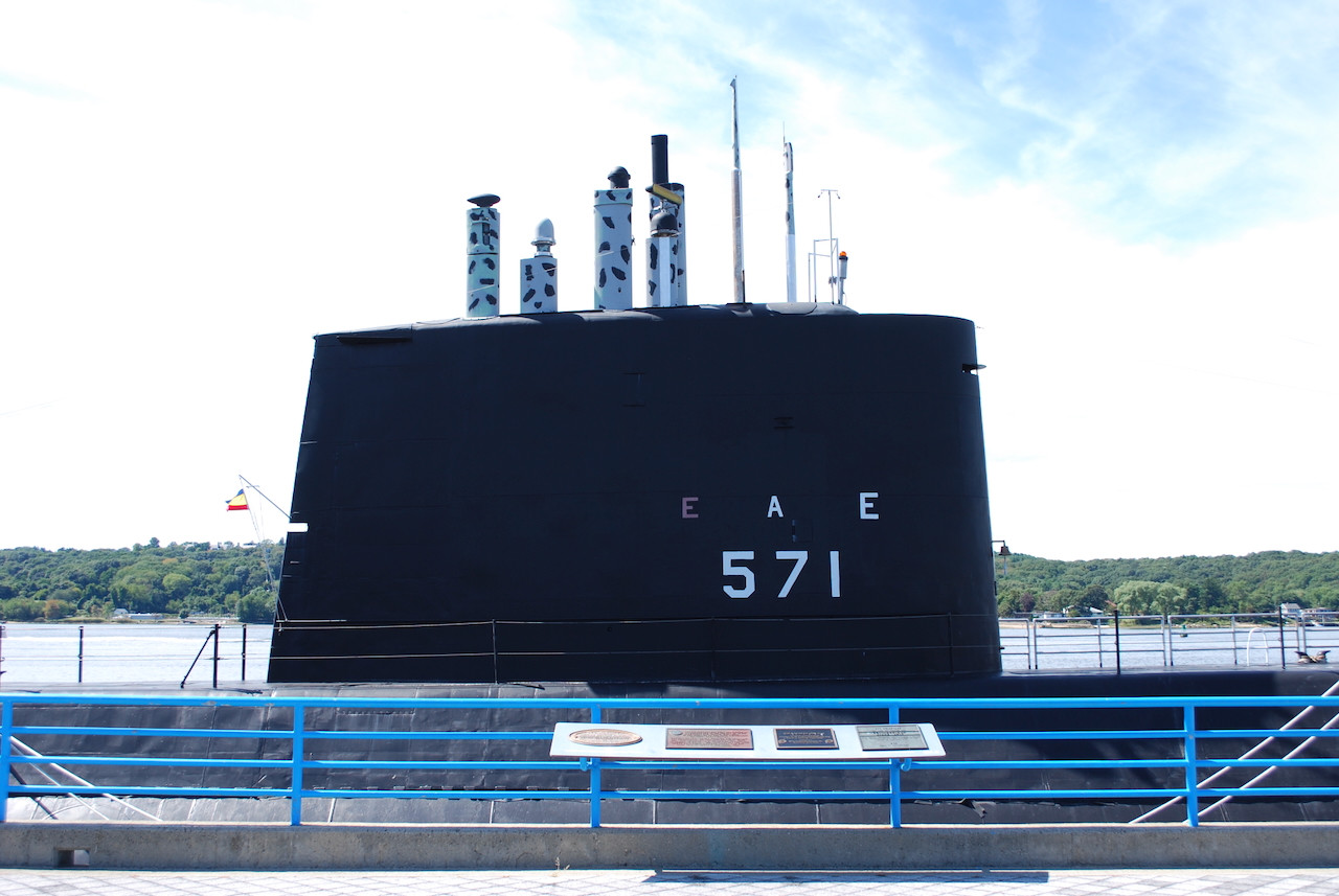

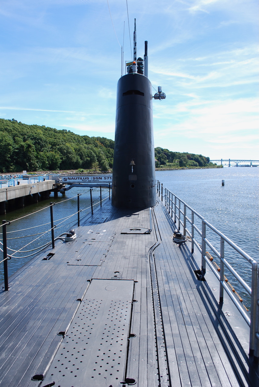

          These photos may help with the masts on Nautilus. This is as Nautilus is now as a museum ship. The version you posted is of the much earlier outfitting around the time of the Polar Transit.

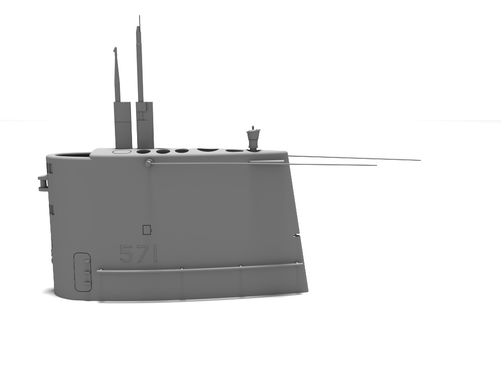

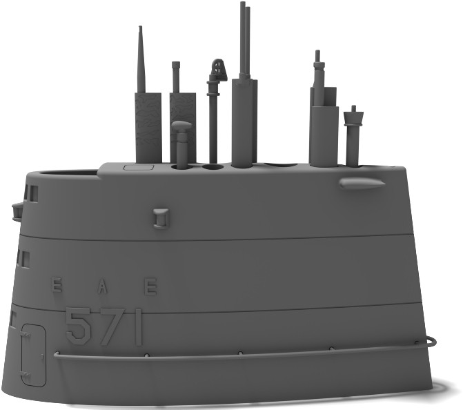

            Just found these old renders showing the sail revisions to better match my references. There were multiple changes to the sail in a short period of time, culminating with a collision that peened over the front/top corner.

                Thanks for the photos. I'll be doing the North Pole transit configuration. Regarding accuracy for the polar transit time period, what do you think of the masts/periscopes, etc. on the 3D printed version that I posted? Also, is the 'cover' for the bow upper sonar array correct for this voyage?
                          Are these in the "Operation Sunshine" configuration?
                          Have you considered offering a corrected resin sail replacement? I would of course be interested!

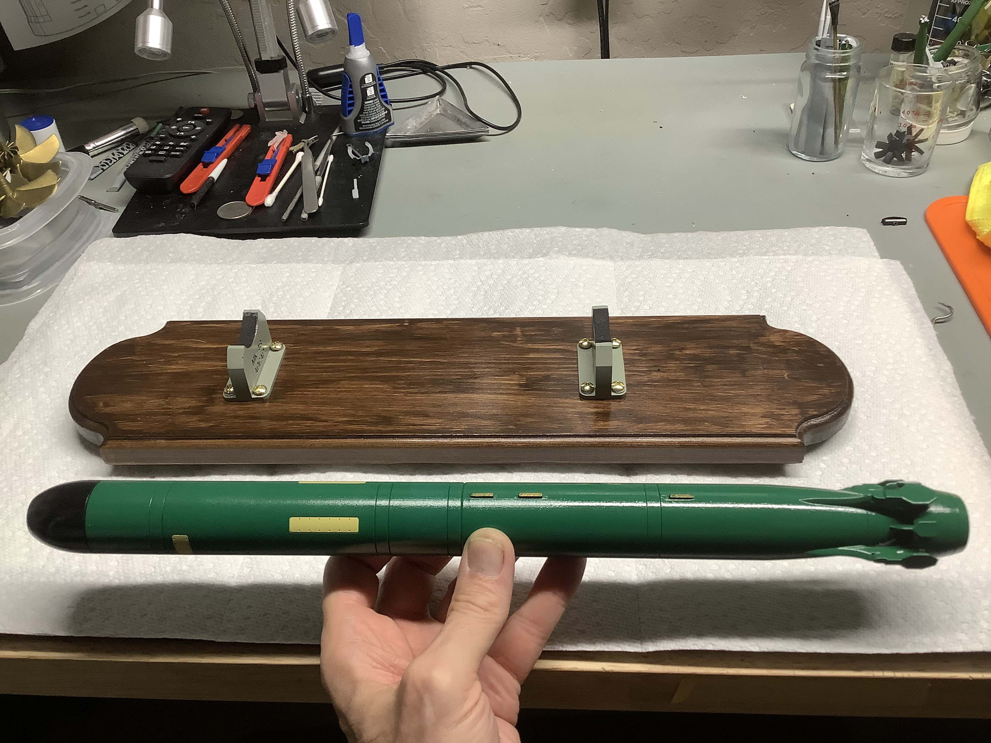

                              Here's a MK-48 I delivered last week for one of our STEM school volunteers. It has round, stacked magnets fore and aft that correspond to a stack in each support block, to enable it to be removed and passed around. (I oversized the control surfaces for younger student handling.) The magnets were bonded in place with resin using the UV wand. A cure station would not have worked in this case.
