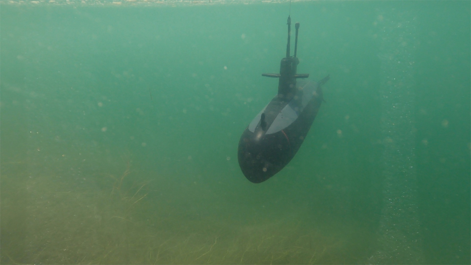

                No so fast mighty Joe, 2.4GHz is used in many subs………I know what you are thinking (which is amazing considering I do not know what I am thinking most of the time) you can’t dive below the surface with 2.4GHz and you wouldn’t be wrong. Most of the time we run at periscope depth and with that little bit above water, an antenna can be used in there and run 2.4GHz. The veep of Subcommittee has been using 2.4GHz for years and enjoys great times in the ponds. So, do not be too quick to poo-poo this higher frequency. You have been around long enough to shape your own thoughts and I do not want to trample them. I do want others not familiar with the hobby to give up or not try it because they do not have a lower frequency to use.
                All that said, I run on 75MHz because I do like to dive deeper and I run in some clear water.
                Click image for larger version  Name:	5E7BD4ED-70BC-446E-8CC5-3321710670D8.jpg Views:	0 Size:	221.3 KB ID:	149831
