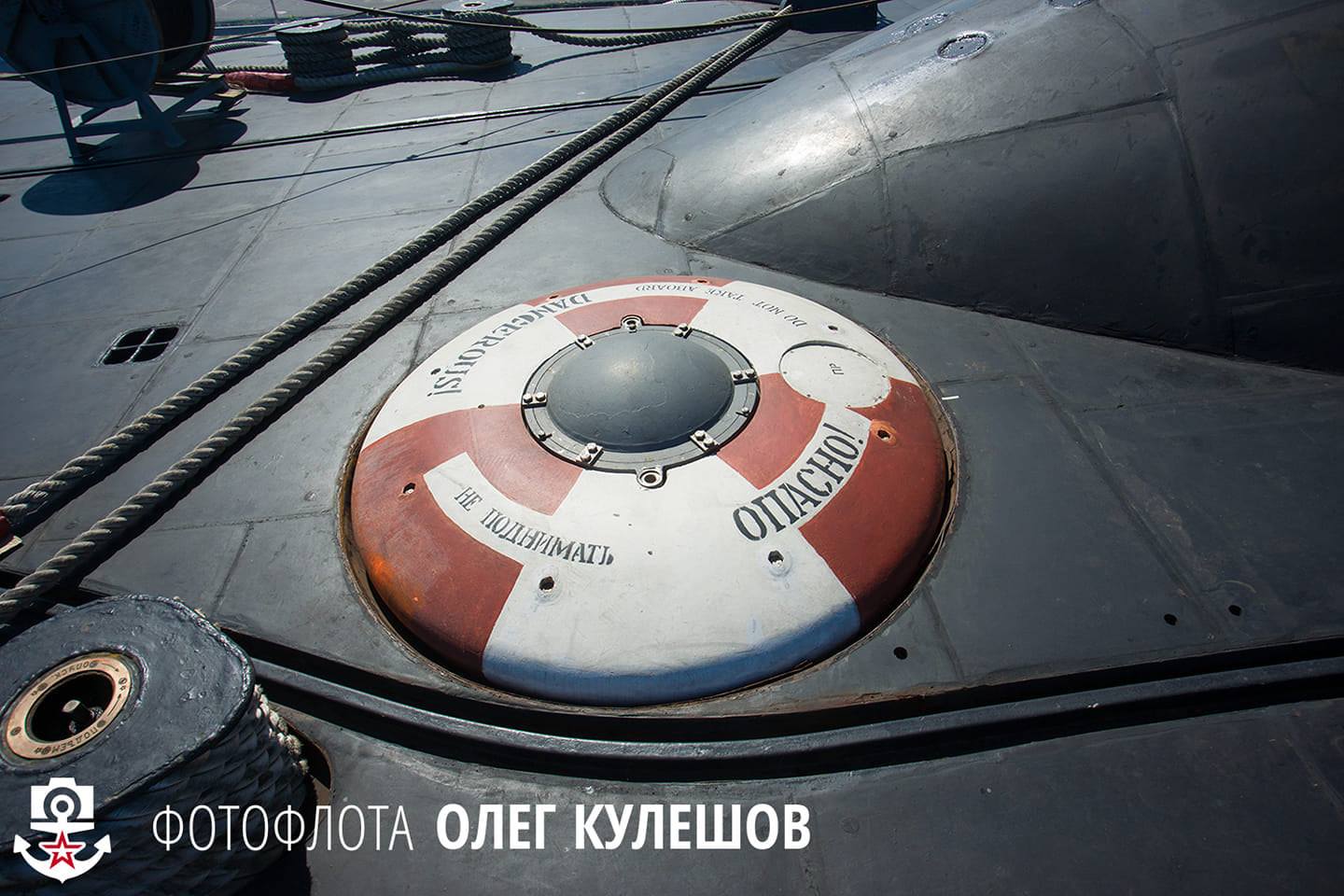

    A photo was posted of a Soviet hatch....this one:

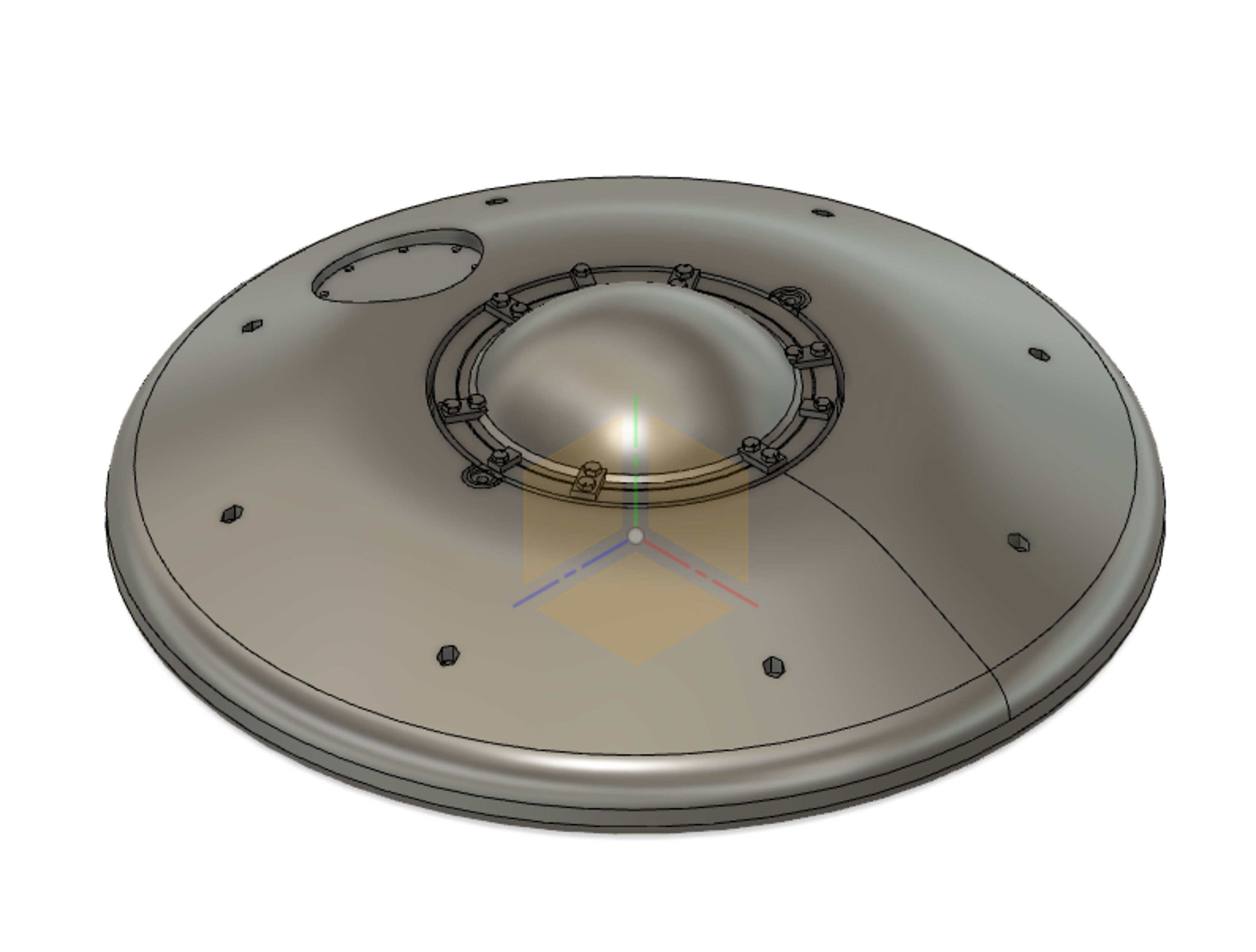

    So, using Fusion 360, and I am still learning on this......created this

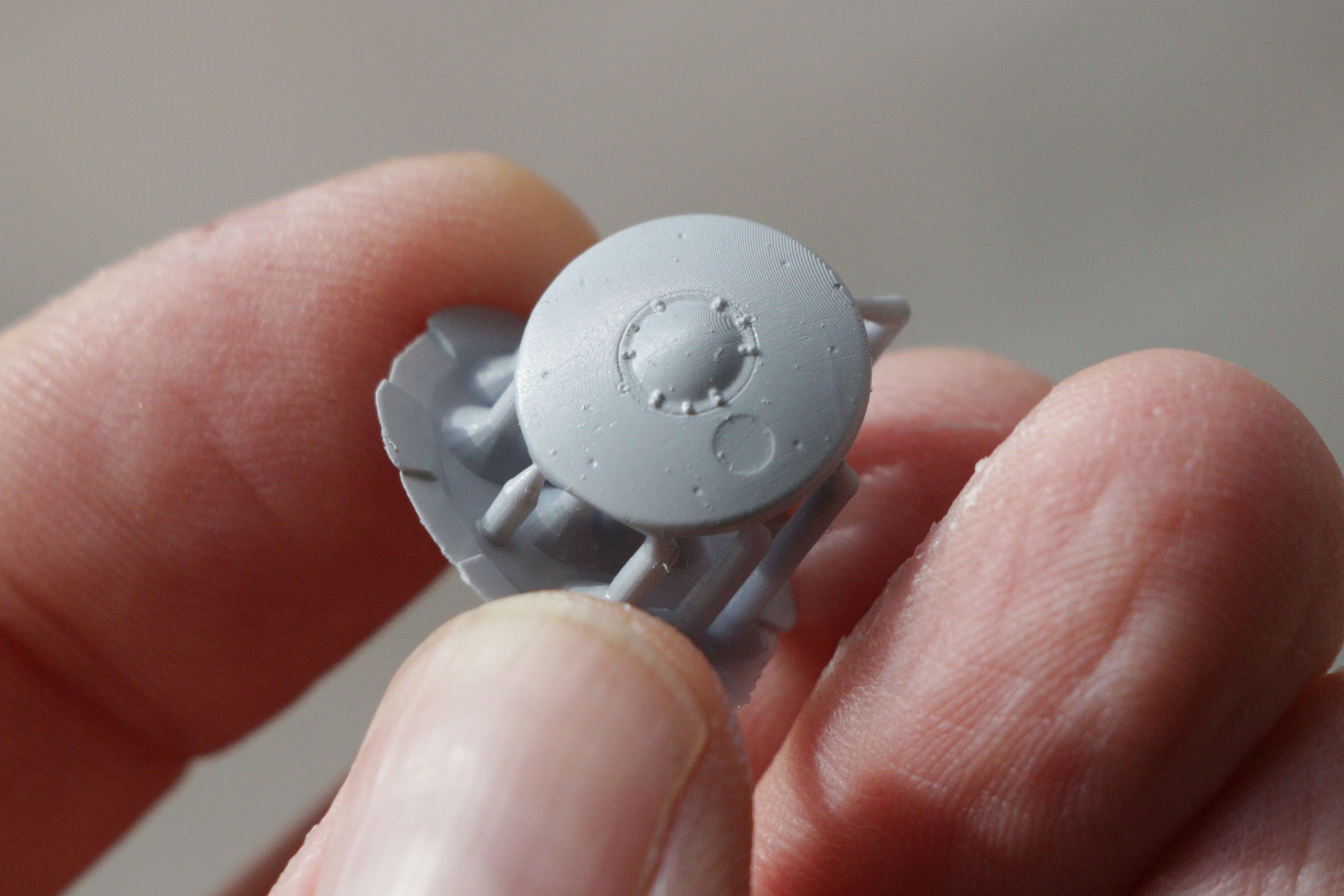

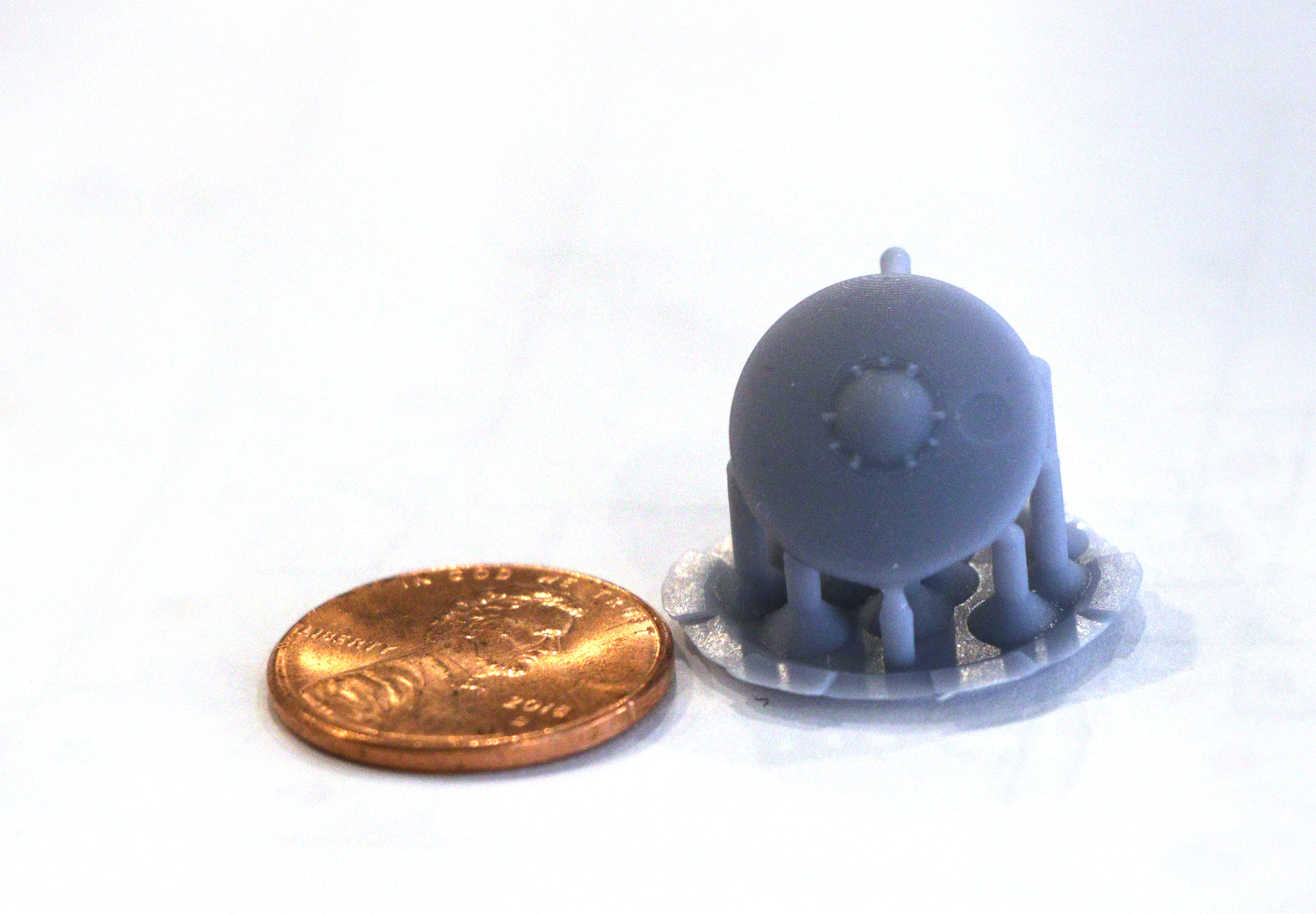

    I use an Elegoo resin 3D printer, printed this one:

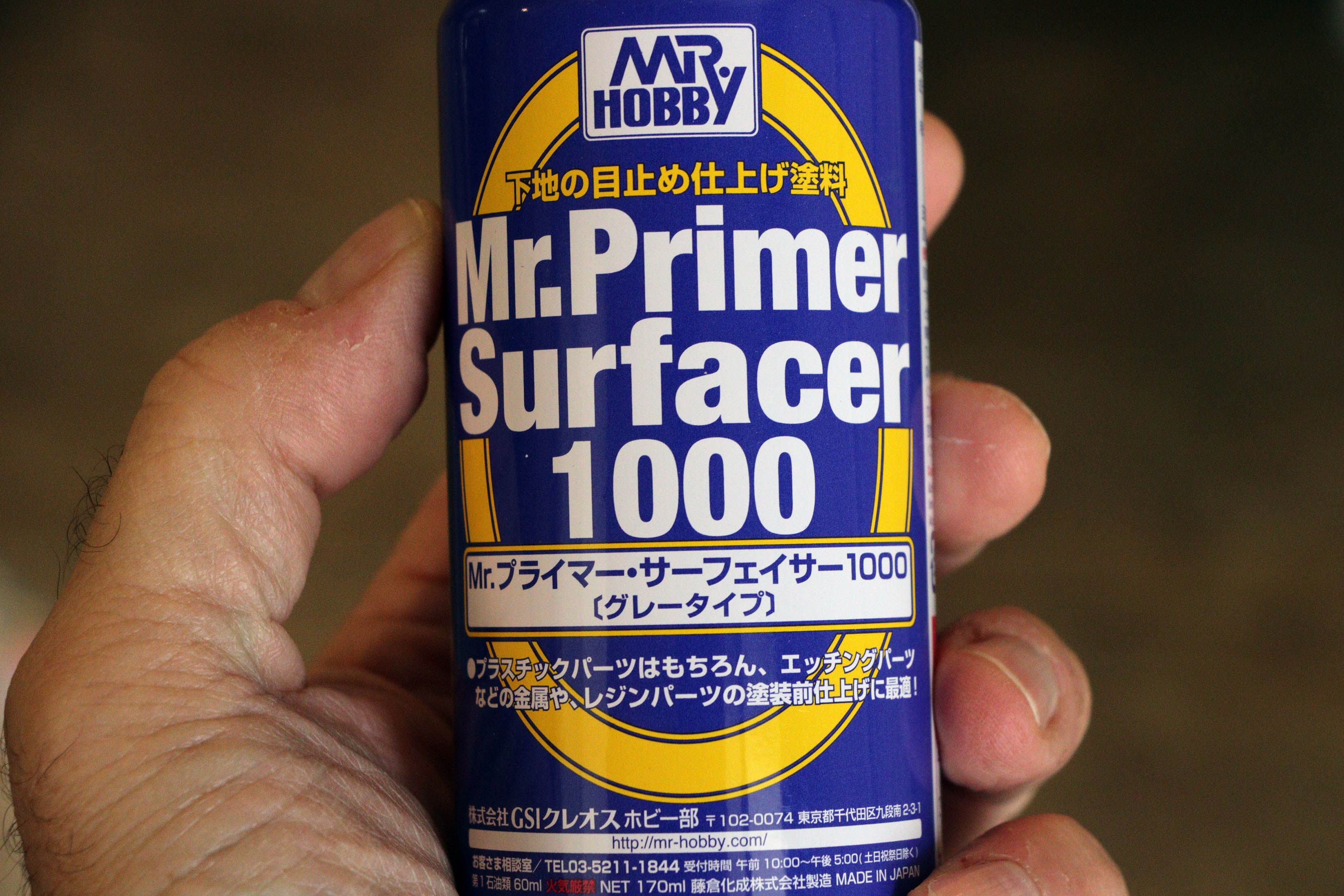

    Sprayed a little primer on it, Mr. Hobby is a fine primer for not masking details.
    This allows you to see some of the details, please excuse the speck on the surface, I did not cure the print or clean it up (including dust), but the details look o.k. - The hatch is a flat on the slopes so if I was to redo it I would make it a little more bulbous or fatty, but using one photo does not help.
    You can see a little of the type of striation that you get with these printers at the 2-3 oclock position.
    This is 1/96th scale if that helps with scale.

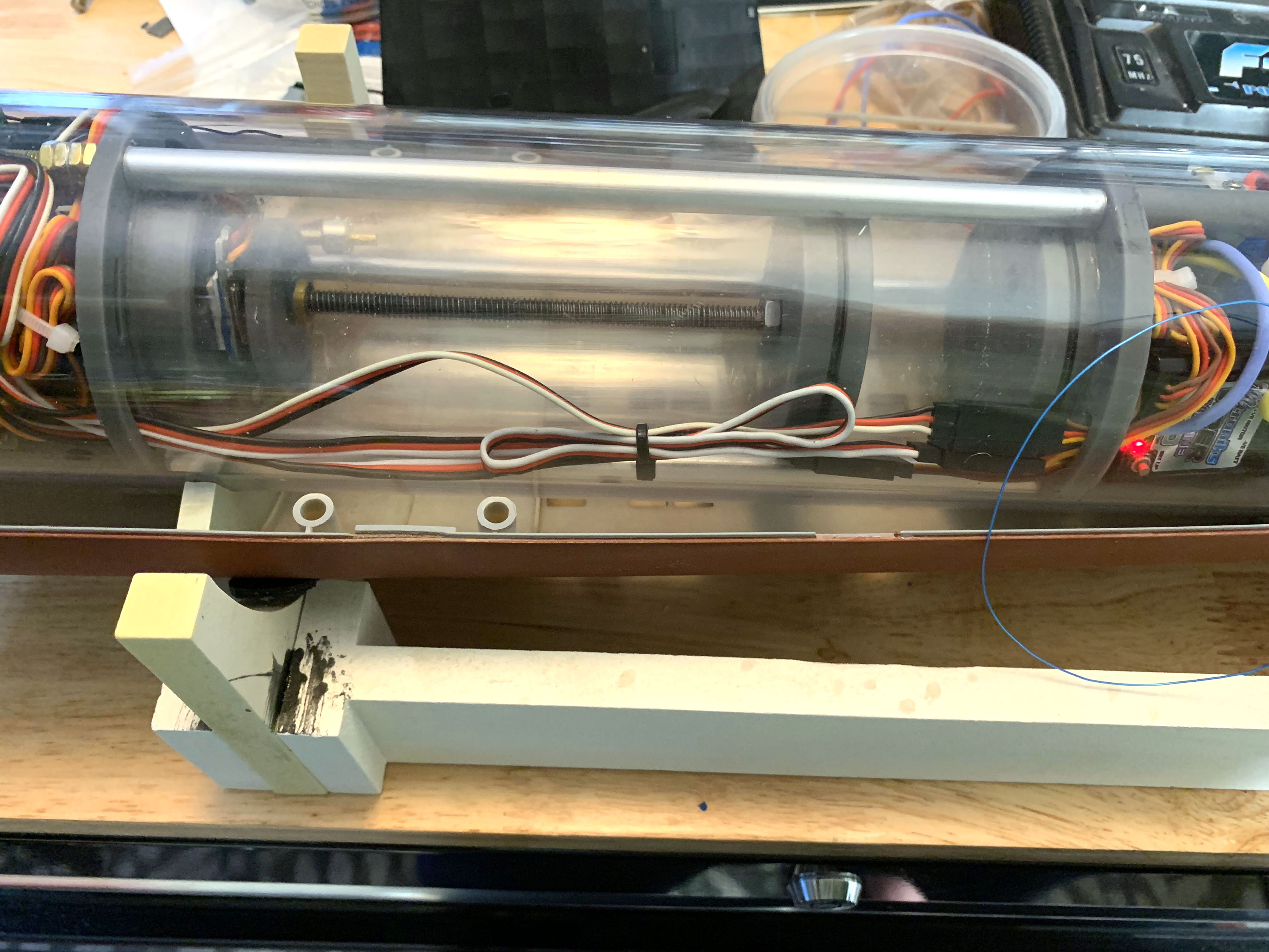

                There are different formulas, but currently I am using ABS like grey resin. It is less brittle than regular resin.
                I am using it for gears in this piston system (actually it is all printed in this resin).
Name:	Piston Ballast system 05.jpg
                So far, it is holding up.

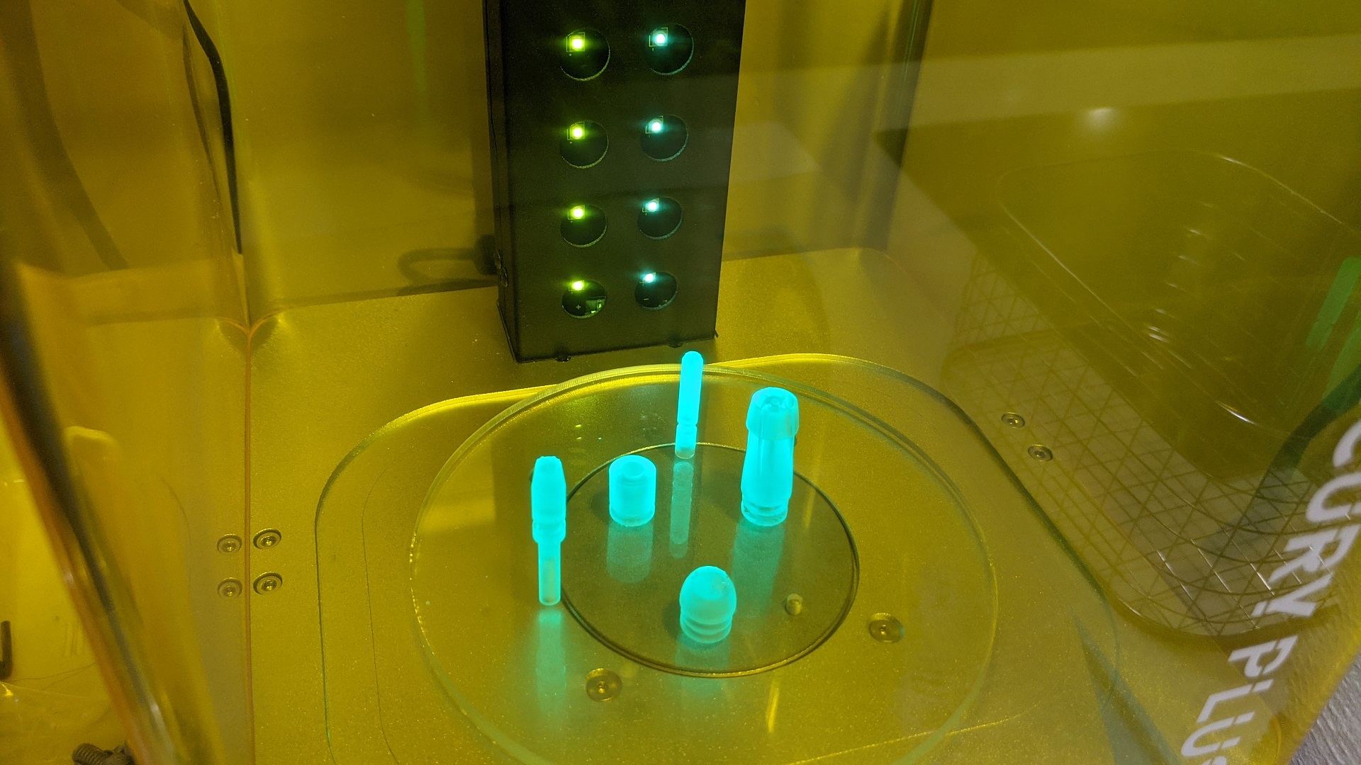

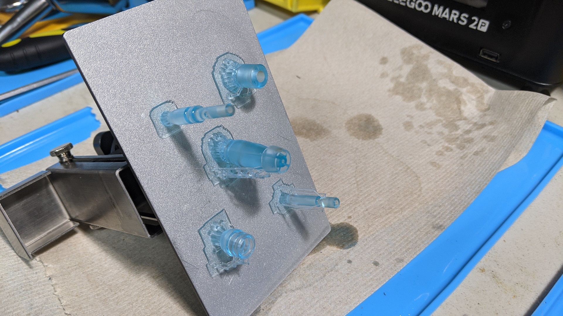

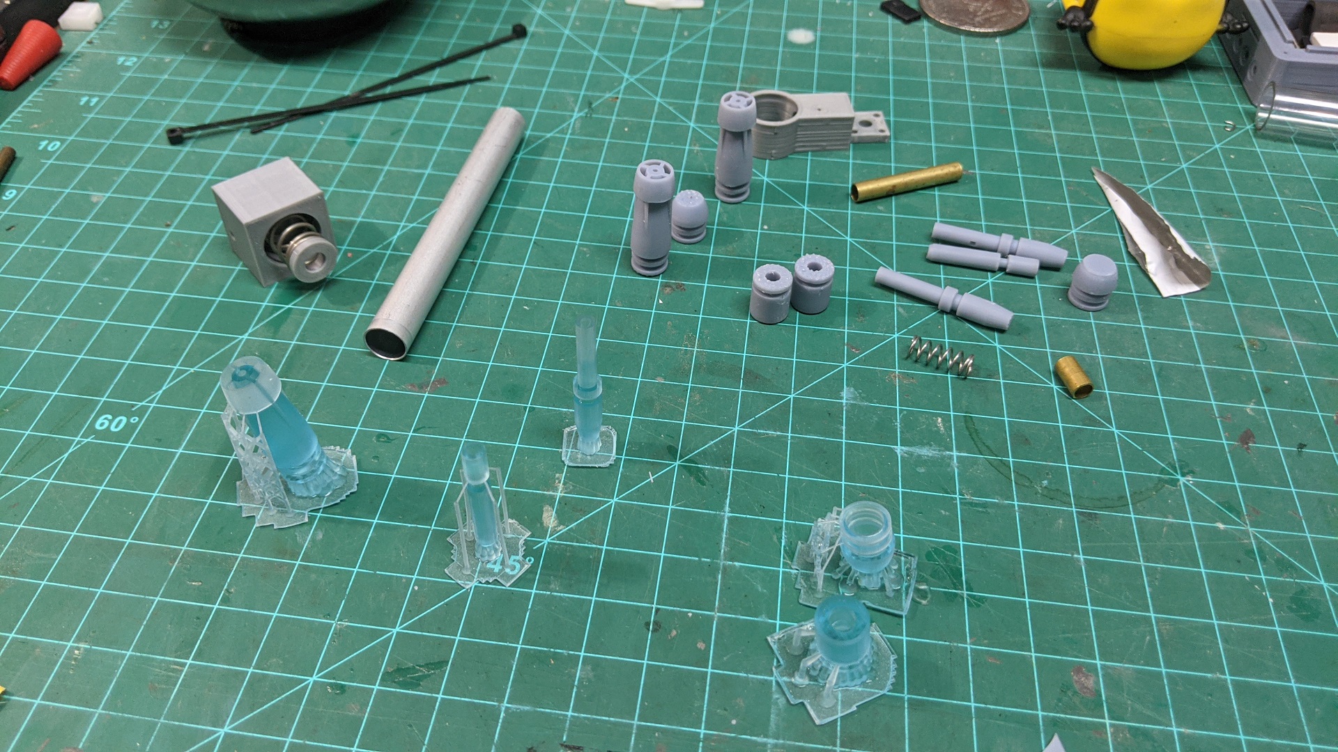

                  3D Resin printing is FUN!!
                  Right you are Tom, we will be sharing files lol!!

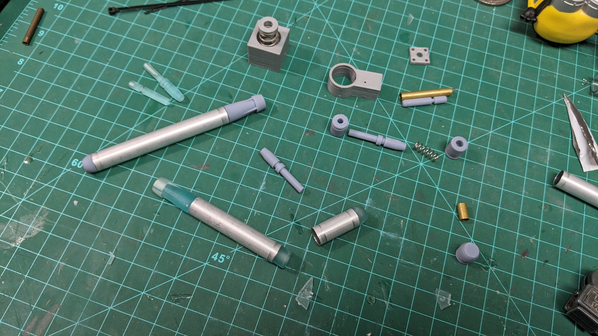

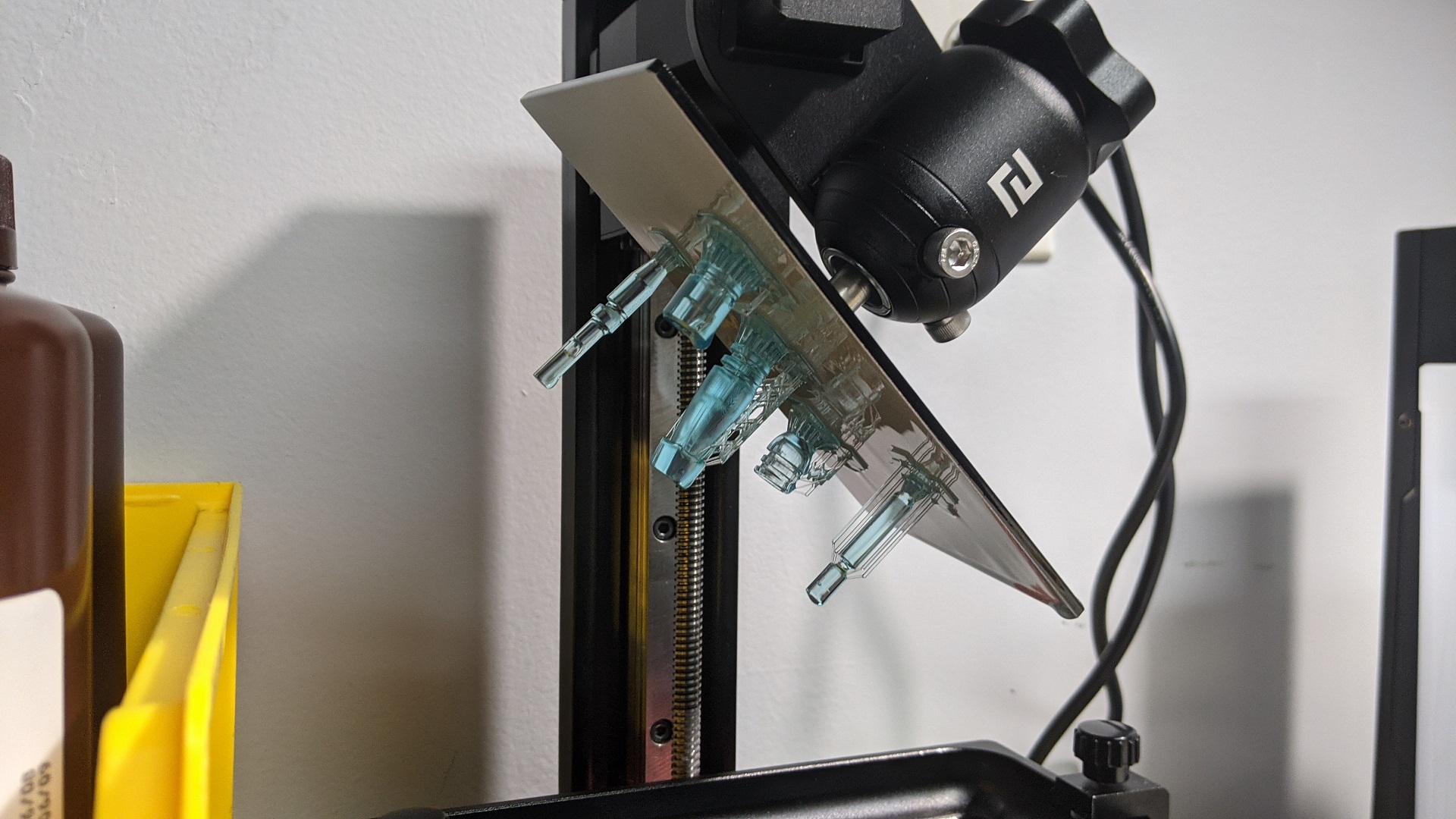

                  And this for those that don't FB....
                  The MK148 ADCAP GAS RC Sub torpedo based on the US MK48 ADCAP sub launched ASW/ASuW Heavyweight Torpedo. Butane charged.
                  This 1:48 Scale fish comes in at 4-3/4" long with a diameter of 7/16". FWD section acts as floatation.
                  The MK113/SL Fire Control System will utilize a spring to eject the MK148 weapon from the tube. Weapon is charged off boat and muzzle loaded.
                  Though the weapon will be painted, I tried clear for the heck of it.
                  The only real issue is to understand suction of the FEP vs sticking to the build plate. Never be afraid to over support and add plenty of footings to overcome failing prints.
                  Part 1: Intro to Chitubox and supporting minis like a pro, the first in a line of videos to come!
                  He is "the Man"! I went from 0 to 100% success!!
                  My SHARK will have teeth this season

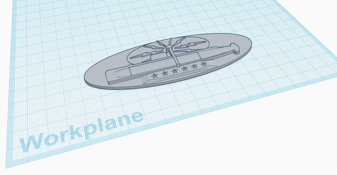

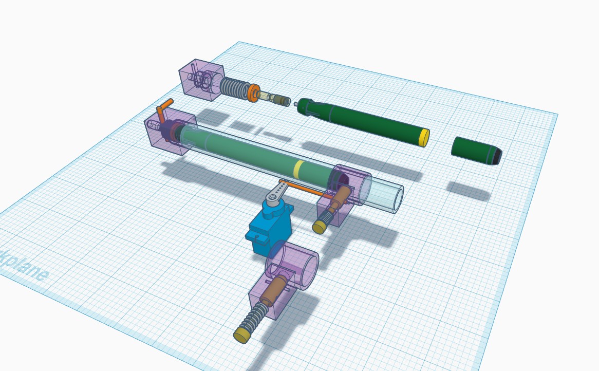

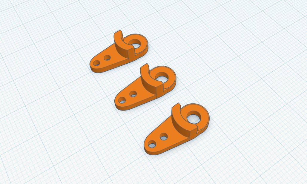

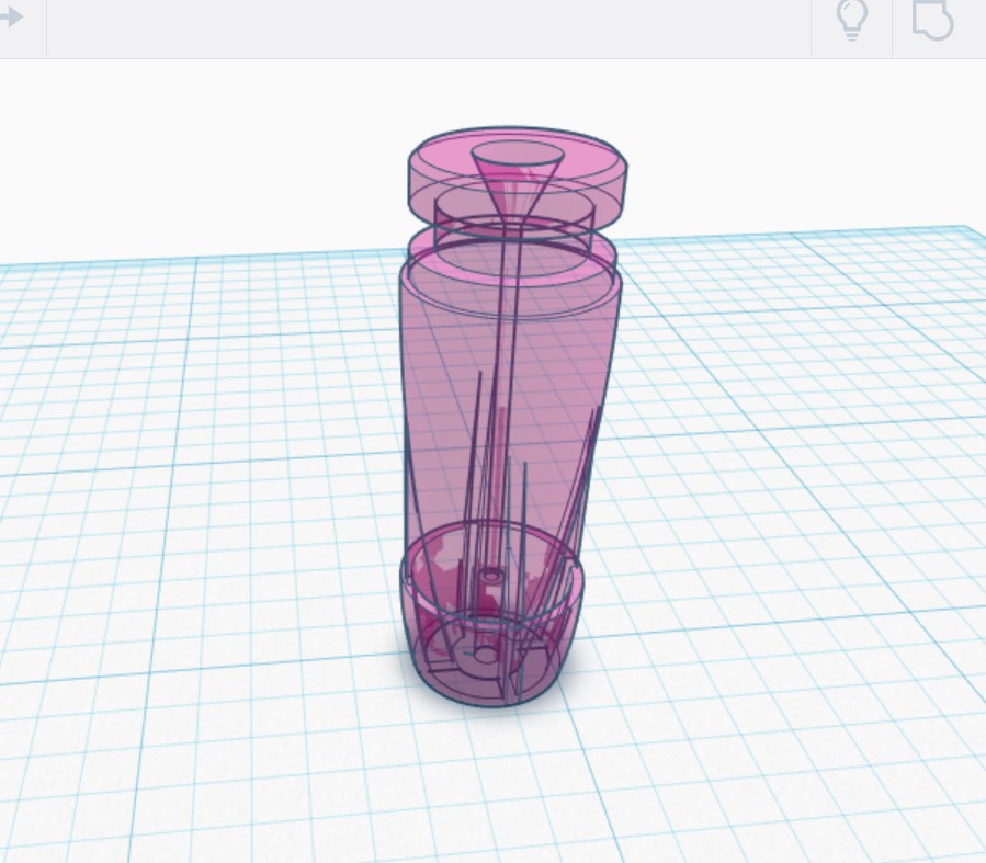

                      Not necessarily true regarding the learning curve.
                      To be honest, I never bothered to learn casting because I had one experience that went south. That seemed like a higher learning curve than this.
                      I am much happier on this course.
                      I also look at it if a millennial can do it, I can.
                      Yes, initial investment was on the order $500, on par with a WTC.
                      Yes I was frustrated at first, but had those parts within a week, it's ALL about supports.

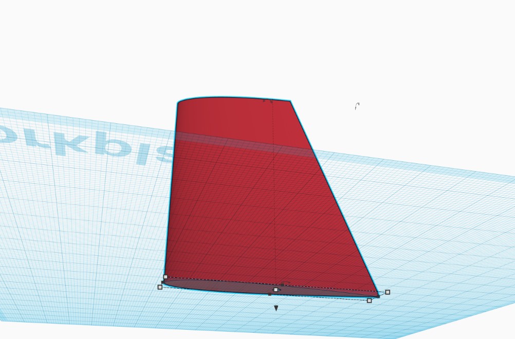

                      CAD Modeling is the tough part, but I do EVERYTHING online in TinkerCAD. Designed for 5 yo's. IOW, people like me.
                      And with CAD modeling....you "see" it before you build it! You can copy it, you can modify it w/o a new mold, share it, scale it. At the push of a button.
                      Took me a few hours to learn it, simple enough to add and subtract shapes. After a while it becomes intuitive and fund to see what you can do rather than what you can't.
                      I actually did all this.
Name:	Screenshot 2021-01-06 125350.jpg
Name:	Screenshot 2021-01-06 125508.jpg
Name:	Screenshot 2021-01-06 125749.jpg
Name:	Screenshot 2021-01-06 125617.jpg
Name:	Screenshot 2021-01-06 125854.jpg
                      The point is, don't let new tech dissuade you from trying it.
                      There was a reason Elegoo Resin and other 3D Printers were some of the hottest items on the XMAS shelves this year.
                      I dig it, it's a personal choice. The point is don't let tech overwhelm you, the very future you all want to join us do THIS!
                      IOW, those who don't explore new territories are often left out of it's riches.
                      Learn this, and the world is your oyster.

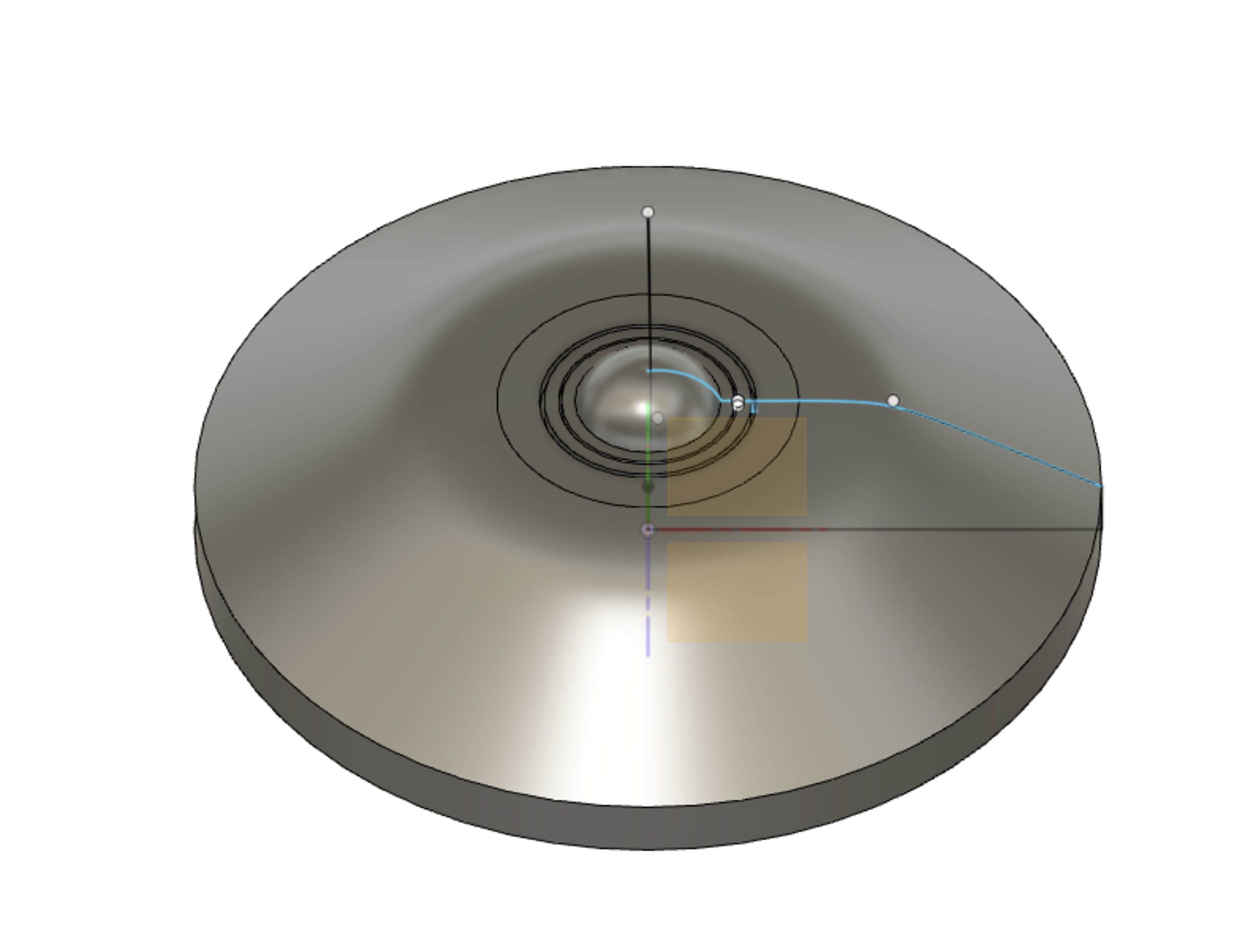

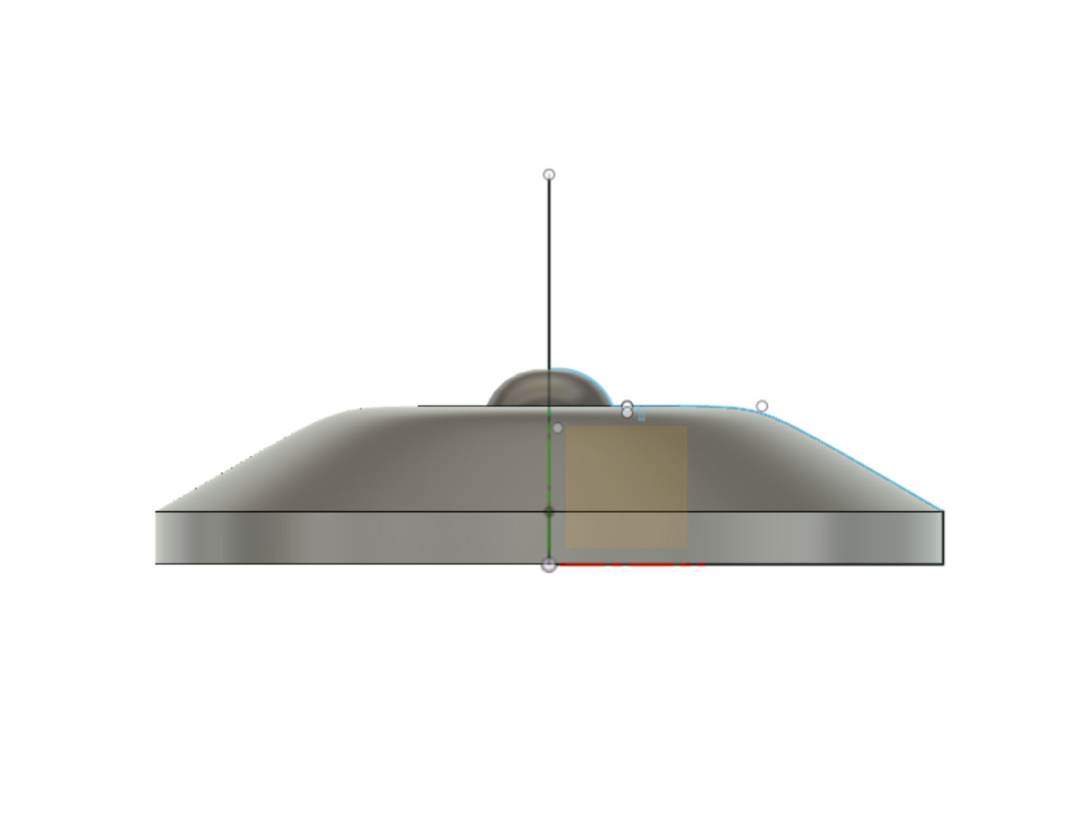

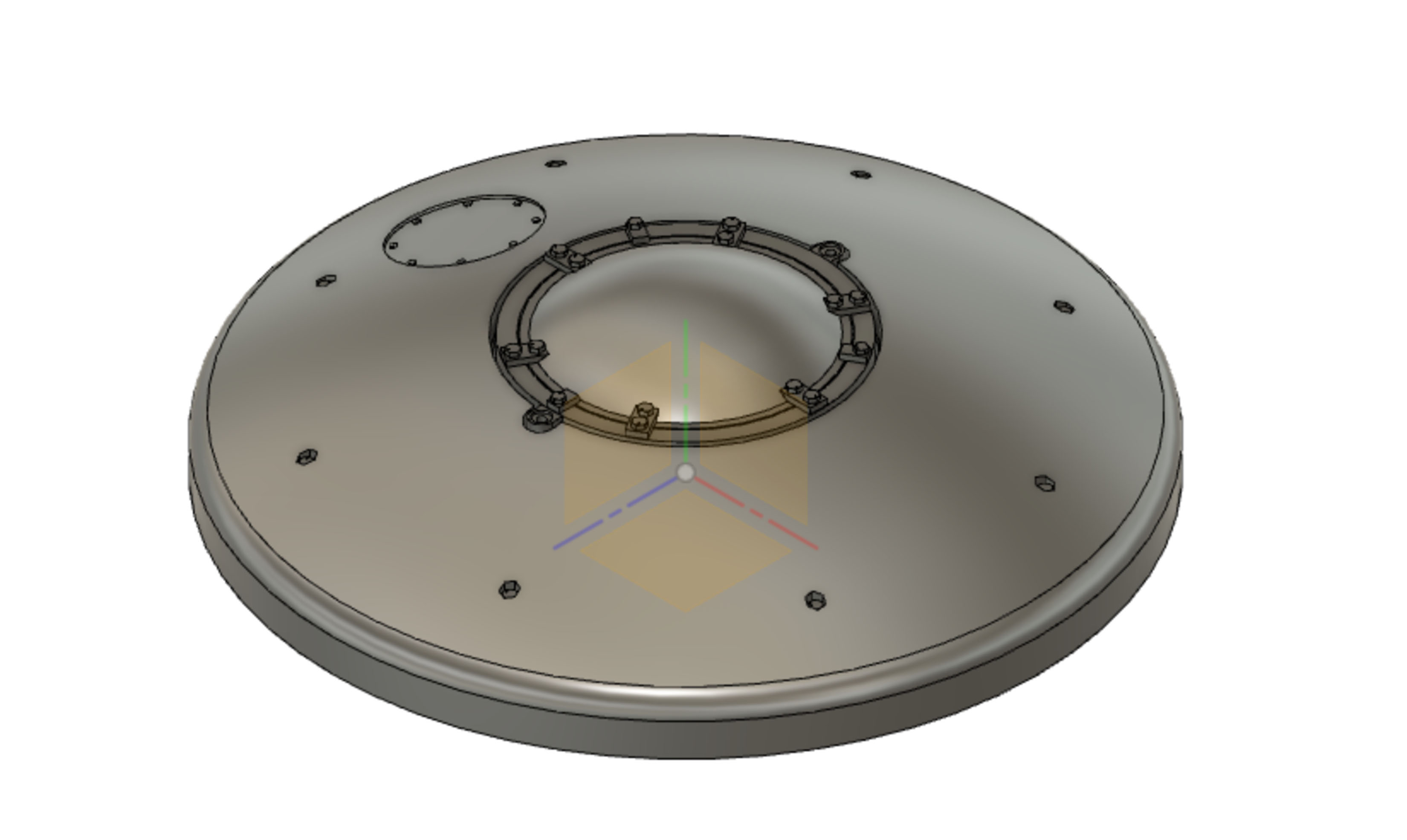

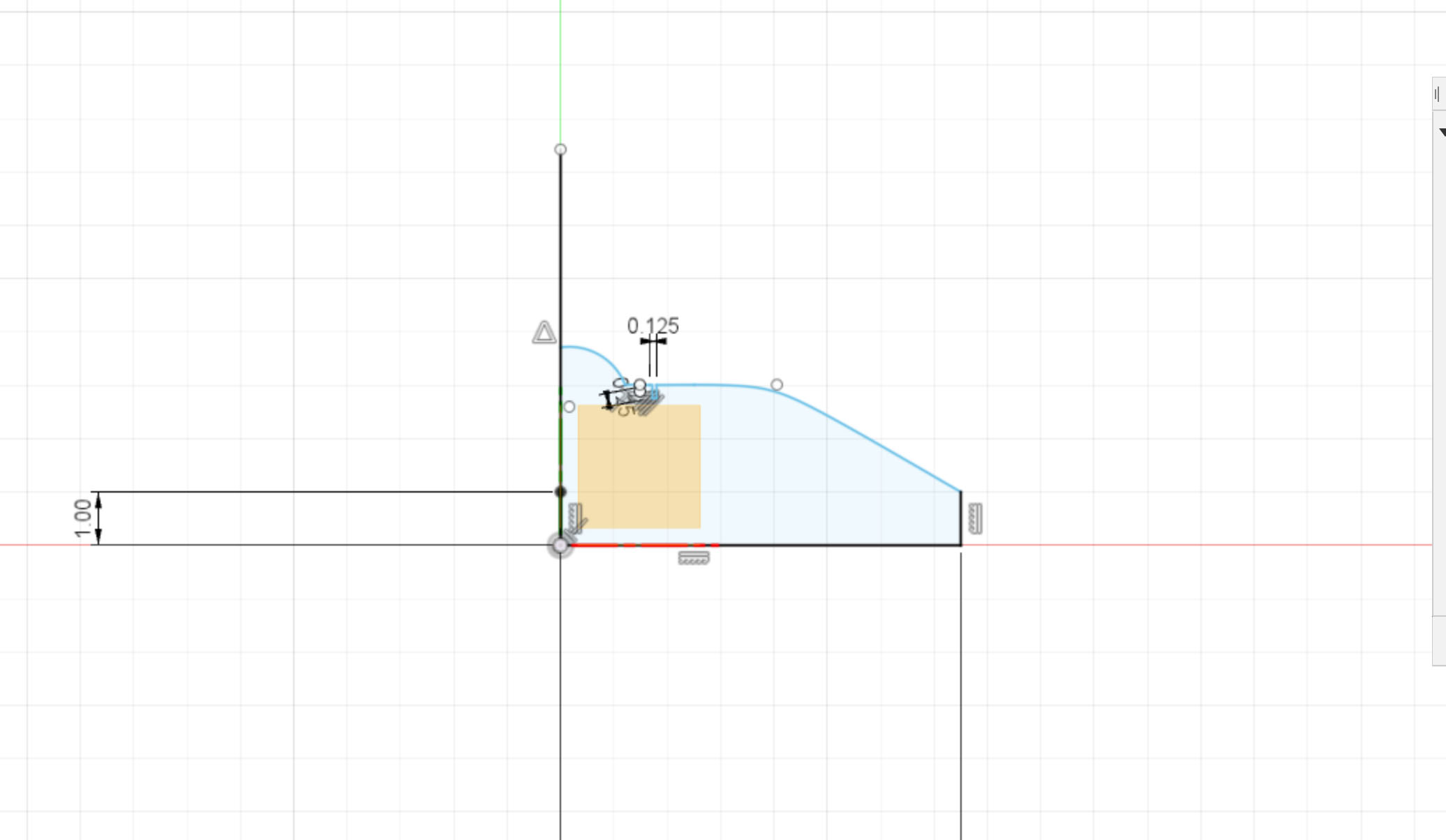

                          Ed makes a great Segway into the topic of how I did the hatch.
                          There are three things I did, and it kind of applies to the process. There is design or drawing, adding, and subtracting.
                          The design part when I started was not used much, I just went to a shape and whittles away or added to it until I had an acceptable shape. I posted for help and all the guys (after they stopped laughing) recommended drawing out as much as possible first. I was joking, they didn't laugh. I think they had pity on me.
                          So that is the first thing I did. I drew a profile. There are many terms used, and I do not know them all, so if I use it incorrectly, forgive me.
                          Simple drawing using lines and curves. There are scissors to delete lines. You can (might be able - it is tiny) see on the profile where the grooves are near the dome - that was a rectangle then used scissors to delete the top of the rectangle once it was drawn.

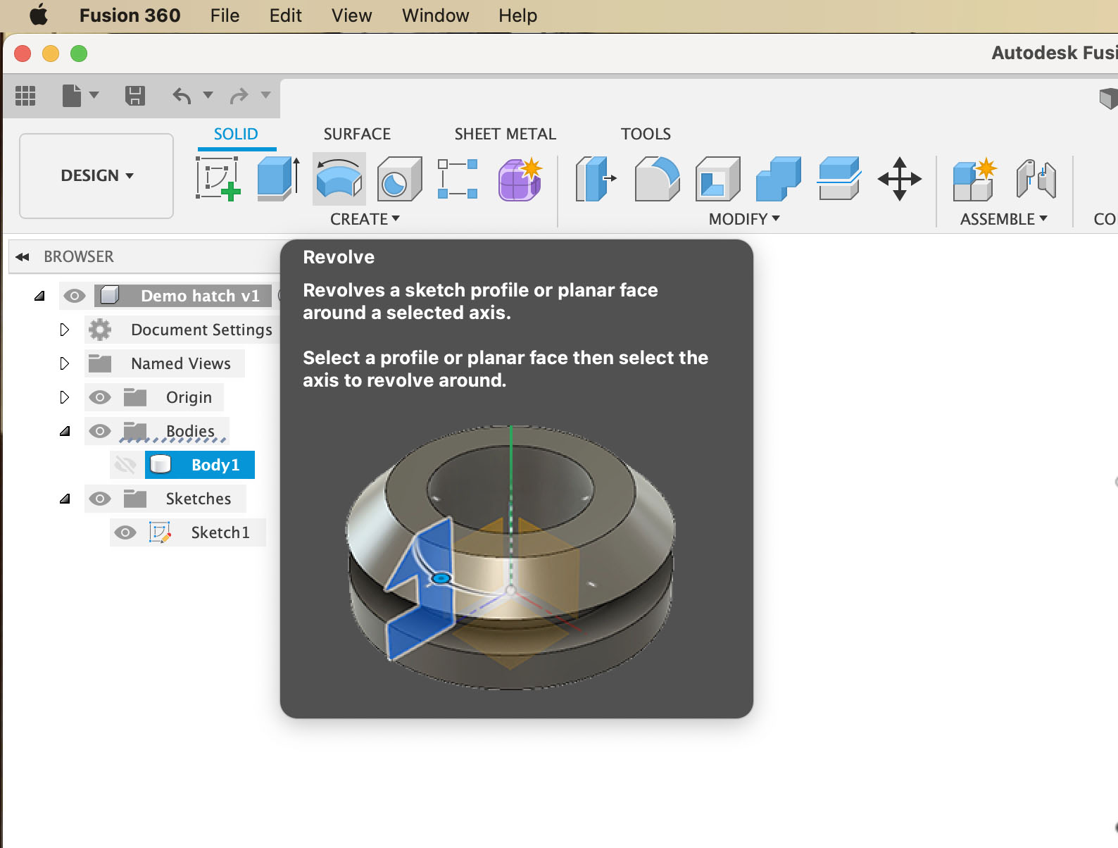

                          Now I only drew half, I could drawn a full profile, but in this case it is not necessary. So, I exit drawing and click on my profile (it turns blue meaning no broken lines). Then a cool tool is this one:
                          Revolve will take your profile and create a 3d shape from it.
                          I ended up with this:
                          The rectangle that had the top removed becomes the groove. Does this make sense?
                          Now it does not look like the final hatch, yet.
                            • 2361
                            I was going to do some steps on this hatch, but this guy does a real good basic knowledge - https://www.youtube.com/watch?v=2GrPsNIArRQ
                            It is a 16 part YouTube with each lesson being about 6 to 7 minutes long. I learned from it just watching it.
