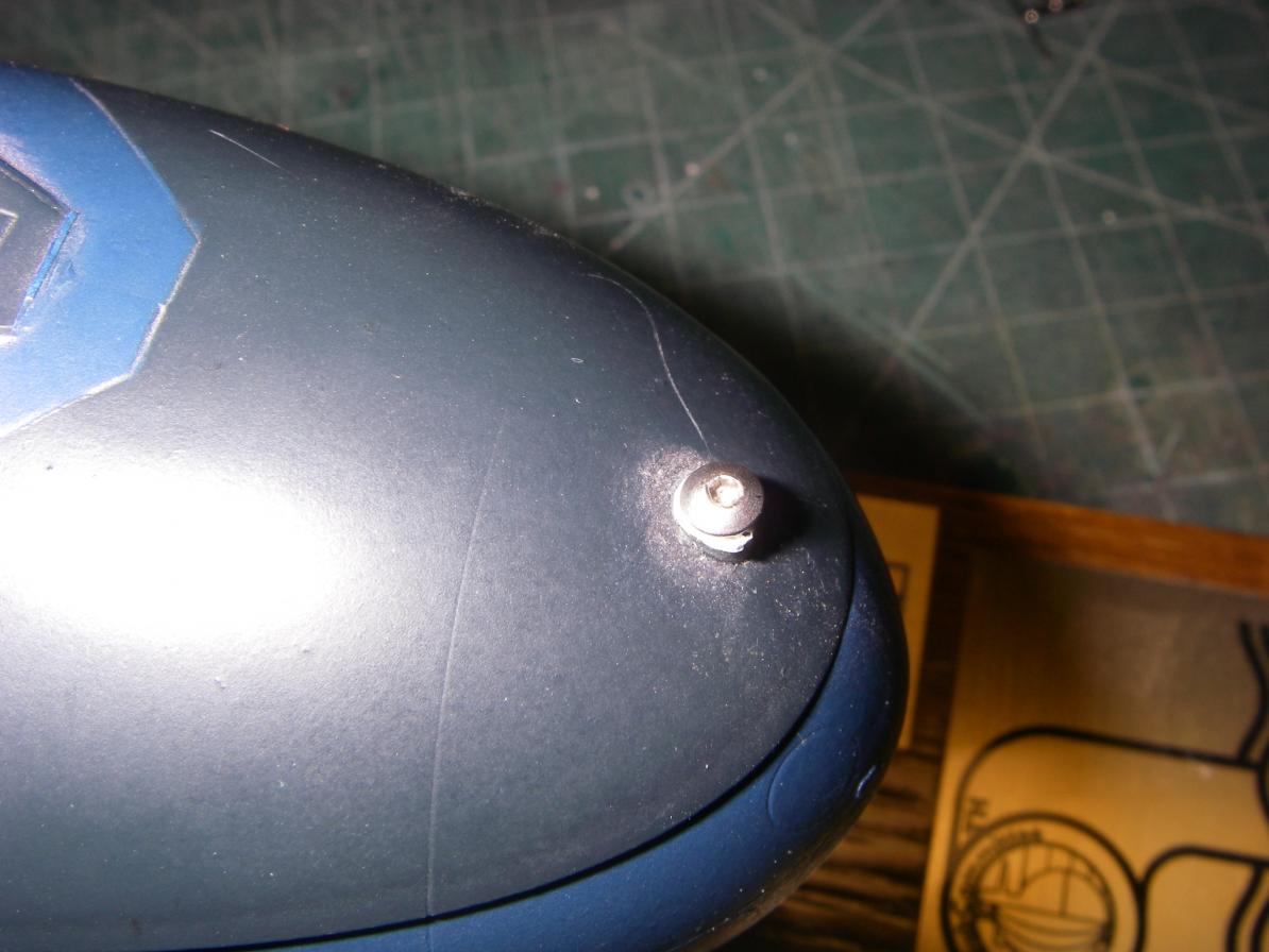

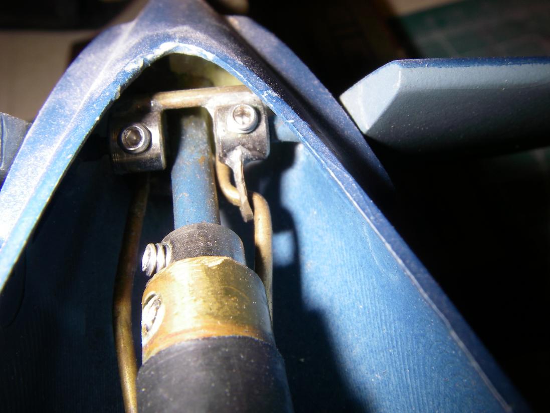

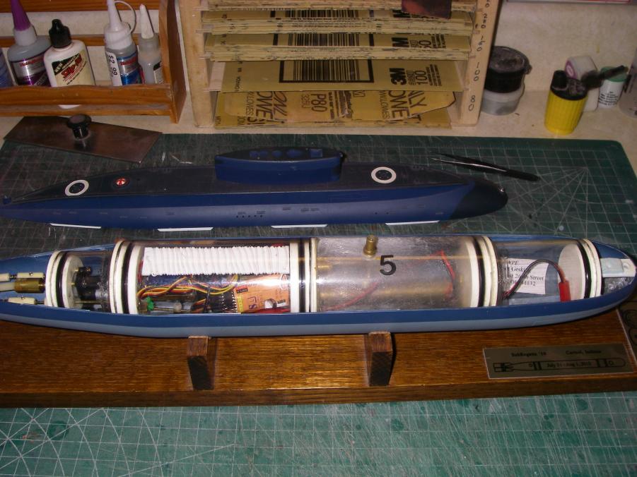

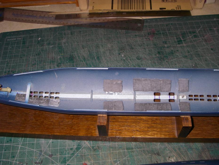

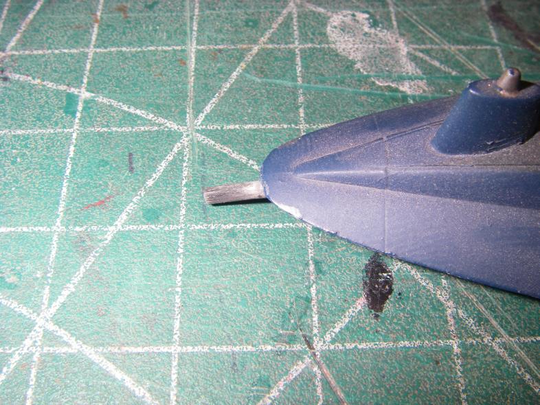

          In 2010, I built one of the Trumpeter KILO's, and used a Big Dave Welch WTC kit in it. I made rudder and stern plane control horns from wheel collars and brass stock. I used some styrene strip and weights inside the hull to cradle the WTC. A small brass pin was installed into another styrene strip in the hull bottom to stop the WTC from moving around. The upper hull is secured with a pin aft and a 2+56 stainless meachine screw forward.
