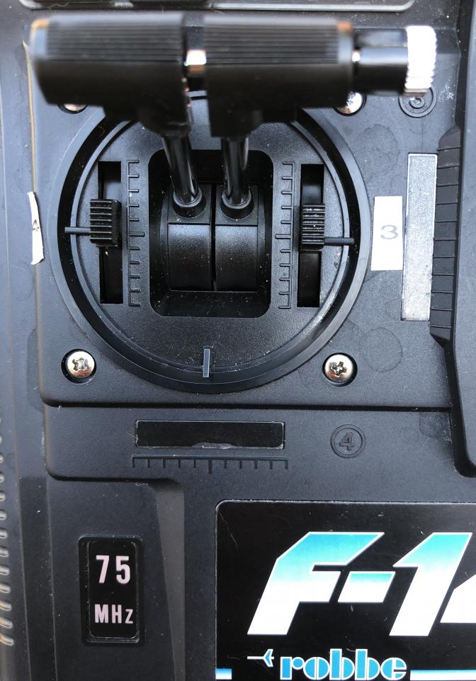

    I was wondering if anyone has taken over for Ships n things since the owner had passed away? I am looking for a part that he sold that converted a single gimbal to a dual throttle control.
    If anyone knows of a North American source, please let me know.

    I have one
    What it looks like installed
    $60 plus shipping

      Can you tell me in which radios will this control work?
      Thanks
        • 2354
        I believe Futaba F-14 and F-16, what radio are you needing it in?

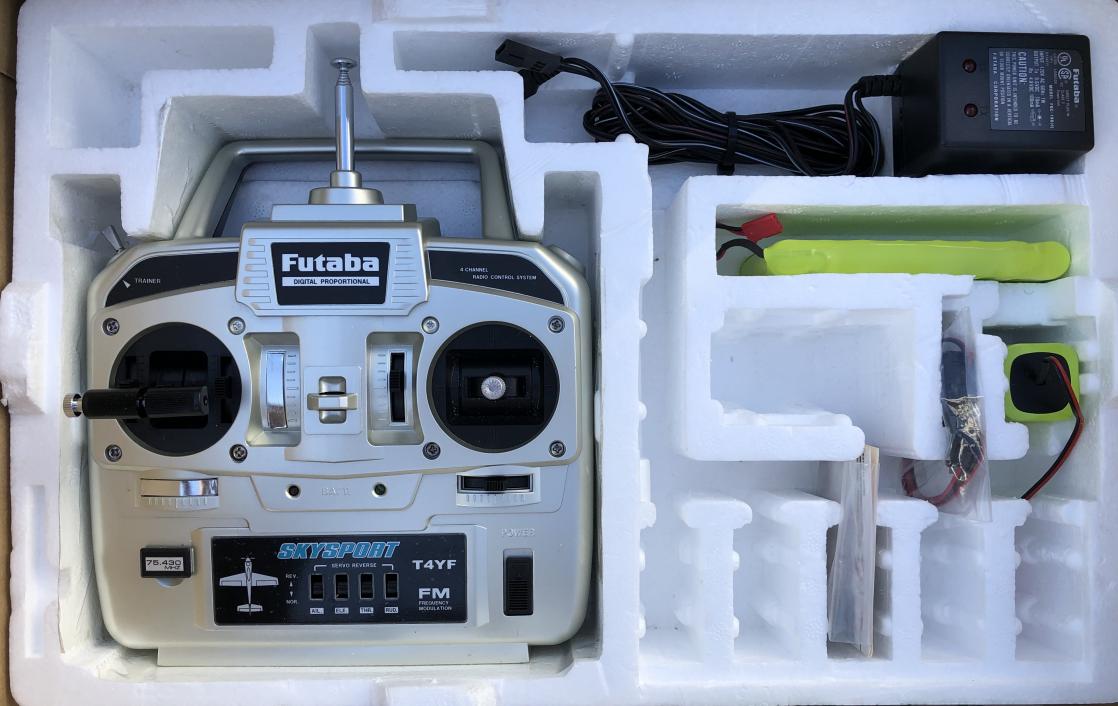

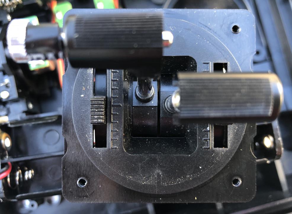

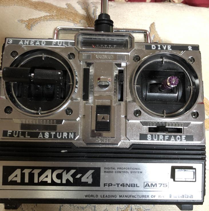

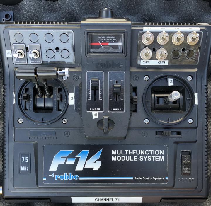

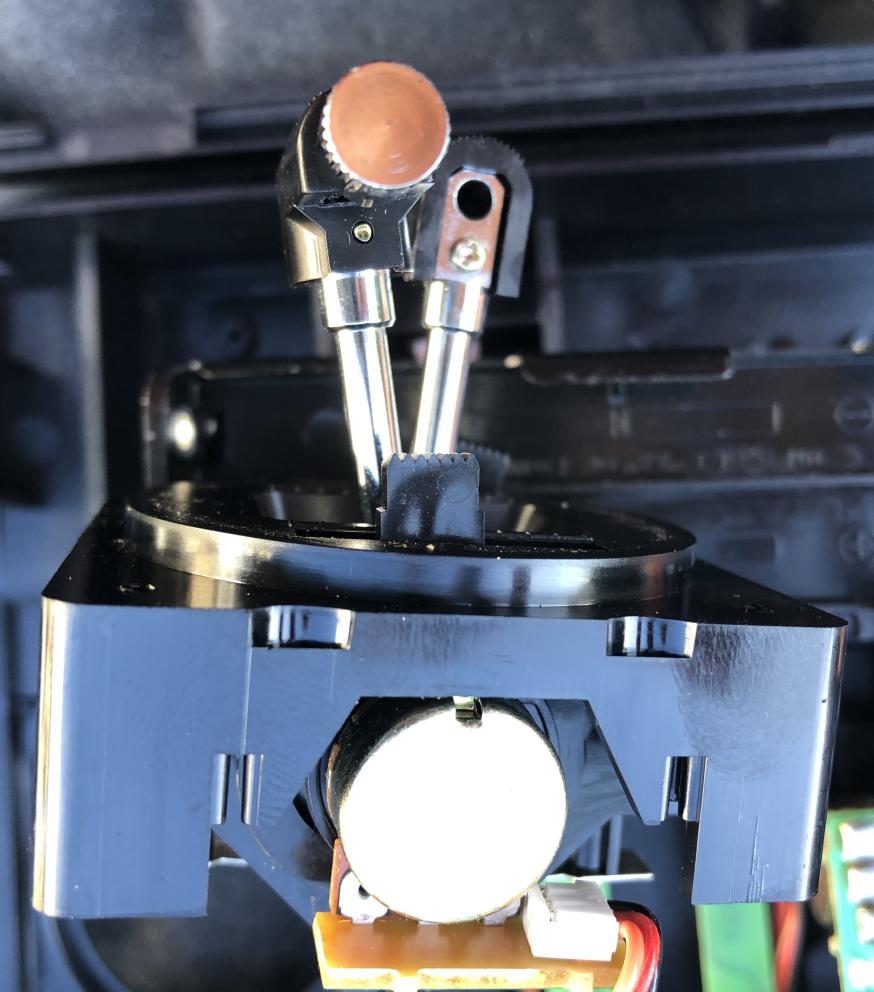

            I have it installed in:
            Futaba Attack
            Futaba SkySport
            Futaba F14
            Futaba FC28

              That makes sense, it is two servo connections/potentiometers and as long as the mounting fits. Cool information Mark!

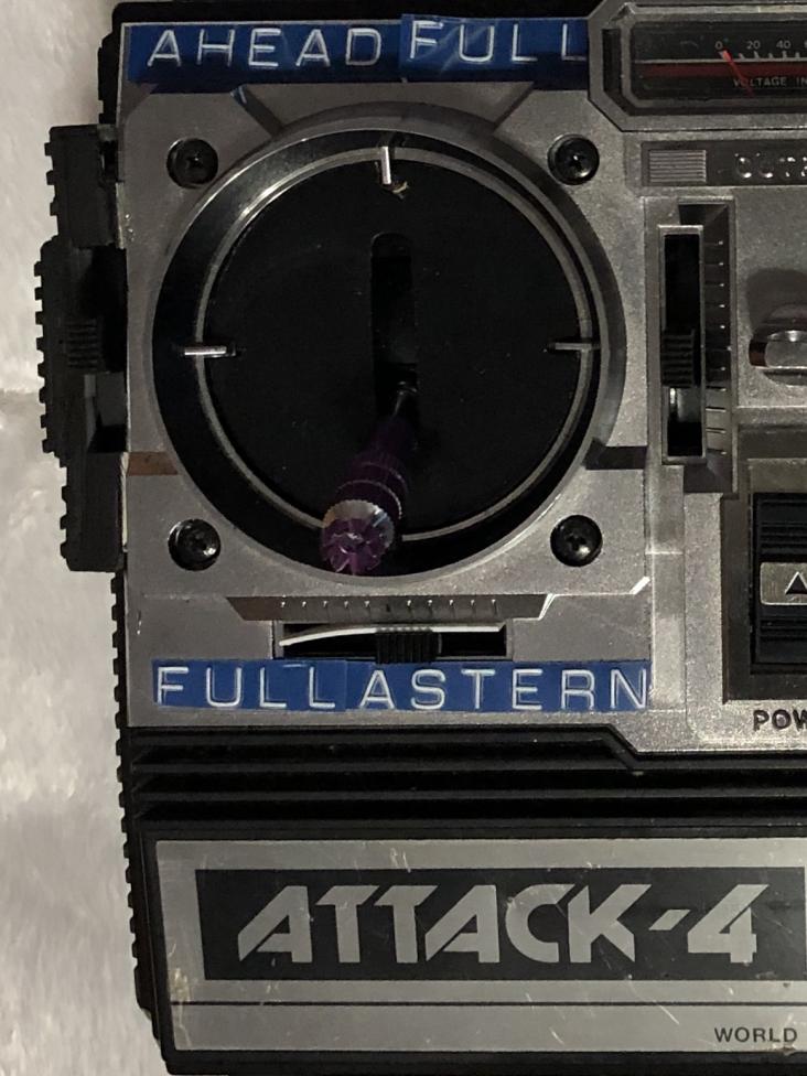

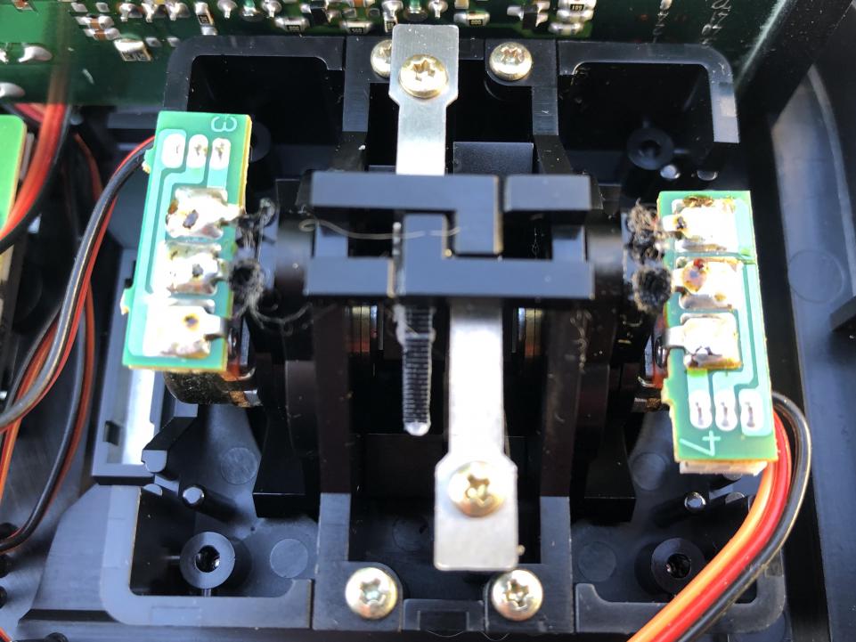

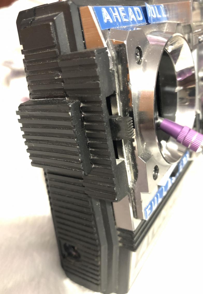

                  George,
                  here is the external pic of a single stick that controls two channels with trims for each channel that I made for my Flying Sub.
                  The trims work opposite of one another.
                  if you look closely you will see that I made a plate that limits the stick travel to forward and reverse no side to side travel
                  • jure george
                    • 361
                    Hi
                    Thanks for the pictures. Question, what is the purpose of the bump out on the side of the second picture? To make some more internal room for the trim control?
                    George
                    • mar7ck
                      • 198
                      The bump out is for the trim tab and the second is for the pot that sticks out past the trim

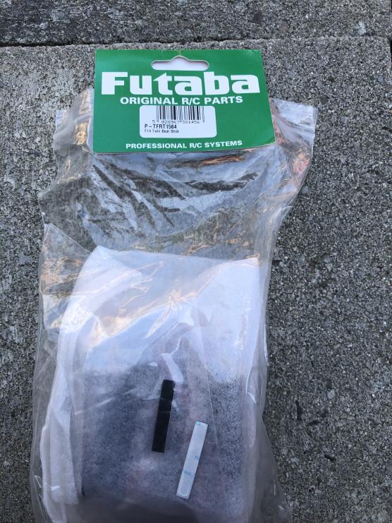

                        Might be easier to use two of these

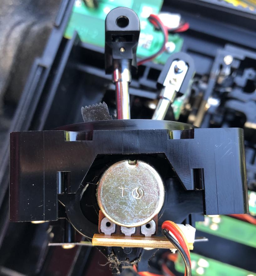

                              Hope these pics help.
