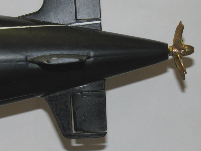

                      I was not happy with my Engel's Akula II turning radius.
                      Thought about it and then modified the lower rudder by extending the front edge...twice.
                      First time I made the shape of the rudder different on the right compared to the left.
                      After running the boat, I learned that the boat turned better one way than the other.
                      Second modification was to make both sides of the rudder match the good side and I added a little bit more to the rudder.
                      In total, I added 1/4" to 3/8" to the lower rudder.
                      The upper rudder is still stock and most do not noticed I lengthened the lower rudder.
                      This reduce the turning radius by about 5 feet.
                      The original rudders has the pivot point almost at the leading edge.
                      This is the first modification.
                      The upper is still original size.
                      You can compare the upper to the lower here.
                      The second filled in the gap to the skag and both sides where shaped the same.
