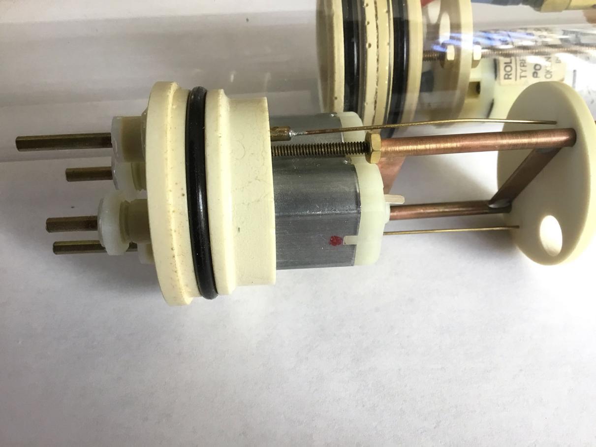

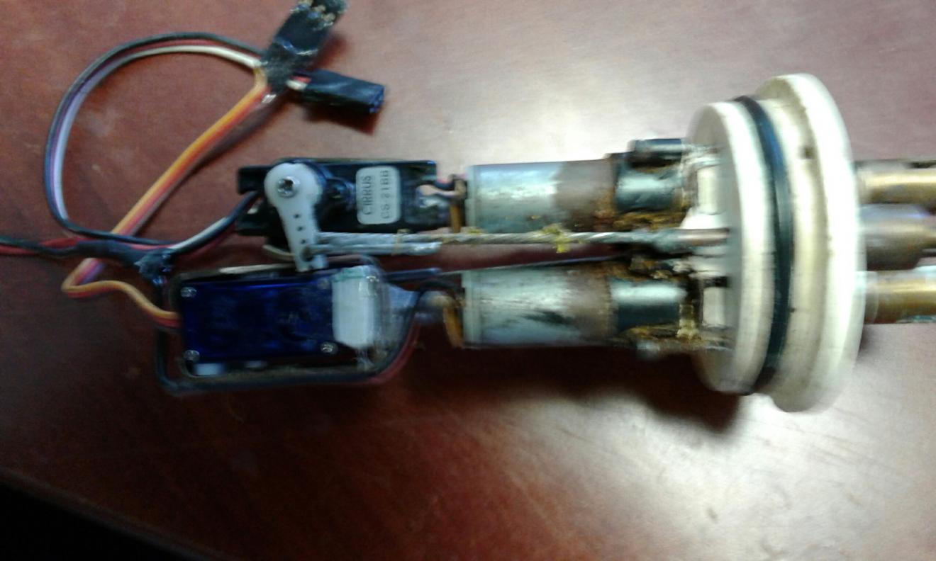

    Any sort of replacement for the motors in my "Big Dave" cylinders Drive unit for my VIIc . Over the years the motors have rusted, mounts are breaking...etc etc.
    Any Ideas??
    OD-5.2cm-ID-5.4 (approx)
    Thanks
    I really need something , as my VIIC is dead in the water without this. I would like to keep Daves Cylinder, as he has passed, but if I cant get parts, I guess I will have a 100/ replacement???

        Disassemble the parts from the cylinder side of the end cap.
        Leave the seal fitting.
        Cleanup the brass tubing that go through the seals. (600 wet/dry sand paper)
        They look like they have oxidized and just need to be cleaned.
        Reach in to the seal fittings and remove the o-rings.
        Replace o-rings with new and grease when installing. (most hardware stores will have these small o-rings in packages of 2 or 4 each)
        With the motors of the end cap, you can see what size they are and find replacements.
        Clean the shaft seals or replace.
        Replace end cap outside o-ring. (check at hardware store)
        Once you reassemble with new seals and cleaned shafts, you should have all but a new completed end cap.

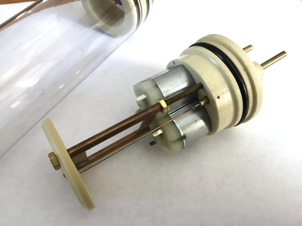

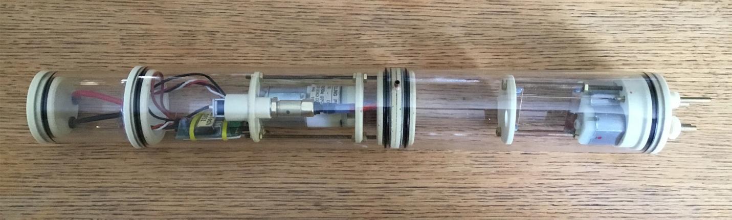

                    Looking at mine,
                    I did not see any specific part numbers that would help. I believe the motors used are simply 180 size motors.
                    With that being said I thought I had 180 size motors. I will continue to dig through boxes from prior moves and see where they might be.
