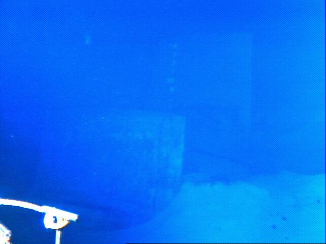

    While visiting the newest additions to the sub section of navsource.org, I learned something new about USS Thresher. Apparently, at the time of her loss she was sporting vertical PUFFS arrays on the ends of her stern planes. These were standard for Sturgeon-class. USS Barb (SSN-596) had them as well -- perhaps as a test after the loss of Thresher.
    They can be seen in this image taken during the 1998 survey of the wreck.

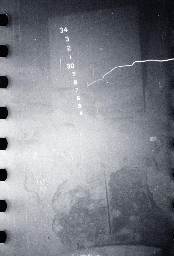

    I went back to the higher angle image of her stern I was familiar with and low and behold you can just make it out at the bottom. This was taken in 1964.

    This is the fun stuff for me. You never know when some new bit of info will pop up. So if you build Thresher circa the time of her loss, don't forget to add them.

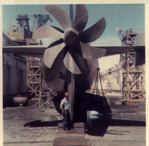

    Here is Barb's stern arrangement.

          Sorry, Thresher didn't carry PUFFS. What you're seeing are the slab-sided vertical stabilizers on the side of the stern planes.
          The three PUFFS arrays were mounted topside where they could measure the curvature of the sound wave, (by measuring arrival times as the signal reached each array) and determine bearing and range via triangulation. The modern equivalent is the WAA carried on today's SSNs.
          I think Tullibee carried PUFFS at one time. . . (mounted topside). Tang class had them too.

            Sorry X bubblehead WRONG!
            Actually Thresher did carry PUFFS in the form of the BQG-1 as did several of the 594's in the form of the prototype BQG-1 or the follow on BQG-2.
            The Blueback SS 582 also carried BQG-2B. The system had 6 array's, 3 port and 3 starboard on the vert centerline, 2 windows just aft of the dome, 2 midships and 2 in the so called vertical stabilizers. The system everyone generically loosely refers to as PUFFS with the 3 exposed vertical fins covering the arrays was actually the BQG-4.
            The older BQG-2 was actually a faster system as far as obtaining a range as you did not have to change course to resolve array ambiguity.
            All the 594's had space and weight factored in for the PUFFS system but they all did not have it installed it as it was not that effective in the 594's self noise field and was removed early in their lifetimes.
            A picture of Threshers BQG is available in "U.S. Submarines since 1945" by Norman Friedman, a prime source of bum dope on submarine sonar and fire control such as calling GNAU and GNATS a jamming device.

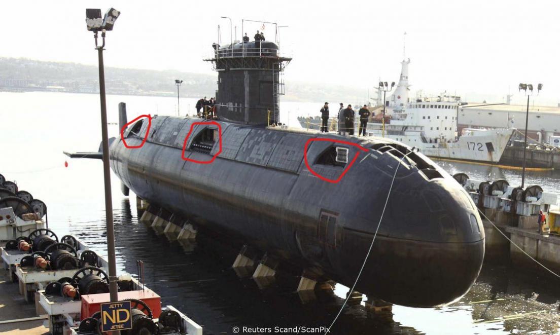

                The orange covers on Onslow are not micropuffs, the wavelength of the freq band being covered and the timing of the system required for a range resolution do not fit anything that close together or that small. The micropuffs arrays are located in the superstructure 3 on each side forward, midships and aft. If you look at a picture of the present Canadian boats you will see 3 acoustic windows along the superstructure, these are the BQG-501 (ex micropuffs) array windows. pretty much the same arrangement on the Aussie Oberons. Have attached a pic of Oberon with windows removed.
                How do I know this, after 40 years working on this stuff both in the Nav and working with NavSea combat systems and the USN sound lab/NUSC you just learn a few things (facts not internet bum dope) not to mention attending BQG-2/BQG-4 school and Raytheon factory training on Micropuffs. NUFF SAID Paul is correct in his assumption that thresher did in fact have PUFFS installed.

                        OOOPS! now I did it.
                        That picture I posted was Upholder not Oberon not a typo-senior moment.
