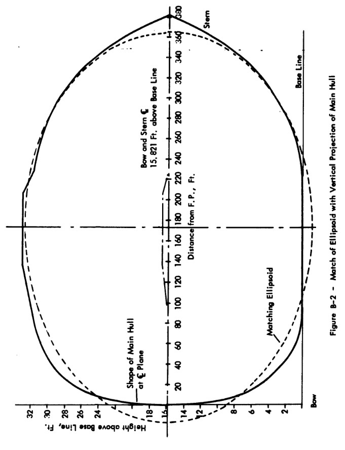

    From this table, there is even more information that can be gleaned. The first is that the boat was "split" at frame 44 of the original boat. The missile compartment also gained unique frame numbers starting with M. It seems, though, that some of these M frame numbers were given to areas of the bow section of the boat that remained from the original Skipjack external shape, but were heavily reconfigured. There is also a hint here of how long the compartment really was, but you need to look at the next chart to really start to understand this, and then be able to go back to the chart and recalculate a final answer. So without further ado, here is the next chart from page B-8.
Name:	Hull Shape Chart.jpg
    This chart shows the actual shape of the hull plotted in a graph. Because the axis of the chart cause the hull length to be shown in a compressed fashion, it highlights a few key facts. The first is you will see there is a dashed line (a centerline dash, not the regular dashed line) that shows the hull centerline with respect to zero. You will notice that for a length of approximately 140' there is a deviation from center. This is caused because the hull insert was aligned at the keel to the Skipjack hull shape and not at the top of the boat. You will also see the length that were used to fair this into the hull. From a hydrodynamic standpoint, this allowed some of this offset to be hid under the decking that was already going to be used to fair in the missile tubes. Referencing this back to the previous table, one can begin to compare the station position with the graph of the hull shape, and you find that the total hull insertion, including the forward and aft fairing lengths was 140.92' long.
    This length actually is very close to what Friedman stated it was. How does this square up with the boat only being 130'. I believe that ~10' were cut out of the original Skipjack bow shape to accommodate this. The accuracy of the Dynamics Report have no reason to be doubted, especially given their mission, and the overall length of the boat has no reason to be doubted either.

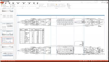

    In my research (documented in the PowerPoint) I also came across the interesting observation that sails of the 41 for Freedom boats essentially were common in their shape. The sail planes, the sail cross section, and the sail planform all appear to be the same except for minor modifications. The location of the sail with respect to the missile compartment also seems to be within 1' of one another. The main difference is the waterline at which the sail planes were located. Each of the major classes seemed to have a different position. This, now allows a modeler to create an accurate sail and sail planes.
    One last tidbit that came from the Dynamics Document was the propeller diameter. The diameter (assuming the later style prop) was 16', and it weighted 23,550lbs (found on page h-14).
    So what is missing to create an accurate conversion of this boat? The deck fairing forward and aft of the immediate missile section would have to be done by eye. I think that this would not be too difficult, but it would be done only with the very grainy planform views, and pictures of the boat. The other item is the shape of the stern appendages. These once again can be estimated from the very grainy planform views, but the lower rudder length is cut off in these views. I do think, though, that one could make a good estimate of these, and the airfoils used are going to be a NACA 0016-22 range. Even, I would not be surprised if the sail used a NACA 00xx airfoil cross section.
    Give me your thoughts. Make sure to take a look at the PowerPoint as well. It has a lot more picture analysis that would be hard to add here. I have added a teaser below, but there is a lot more in there.

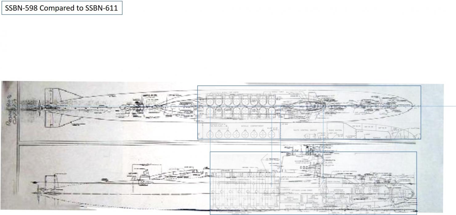

Name:	611 Comparison.jpg

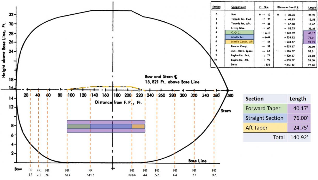

            I think that we are saying the same thing, but in case we were not, I have diagrammed it in a way that I think presents the data in a clearer way.
            What I have done is take the chart that I had previously attached and then removed a lot of to extra data that was in there that was not relevant. So now what you have is the actual hull outline that is plotted here. I then took the table of data, and the frames that were mentioned with their position and created markers at the appropriate hull axial position (the labels below indicate the frame). I have then color coded the total length of the inserted hull plug in all the tables in purple, and the forward taper, straight section, and aft taper in their appropriate colors. The value of the overall hull insertion is 140.92'. I am confident that this is the length inserted as when you look at the chart, you see that the centerline of the boat rises for 140.92'. The rise, I have highlighted in yellow (over the original black centerline that was already in the chart) and you can see that it corresponds to the axial locations in the table.
            So this leads to the conclusion that the hull insert is 140.92' long, and the boat was only 130' longer than the Skipjack. We know that the Skipjack hull form was split at frame 44, so the aft end of the boat is a known entity. This only leaves the bow section that the extra 10.92' could have been removed from the original Skipjack hull shape.
            Adam
