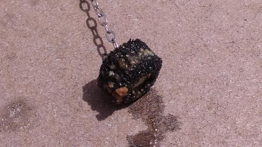

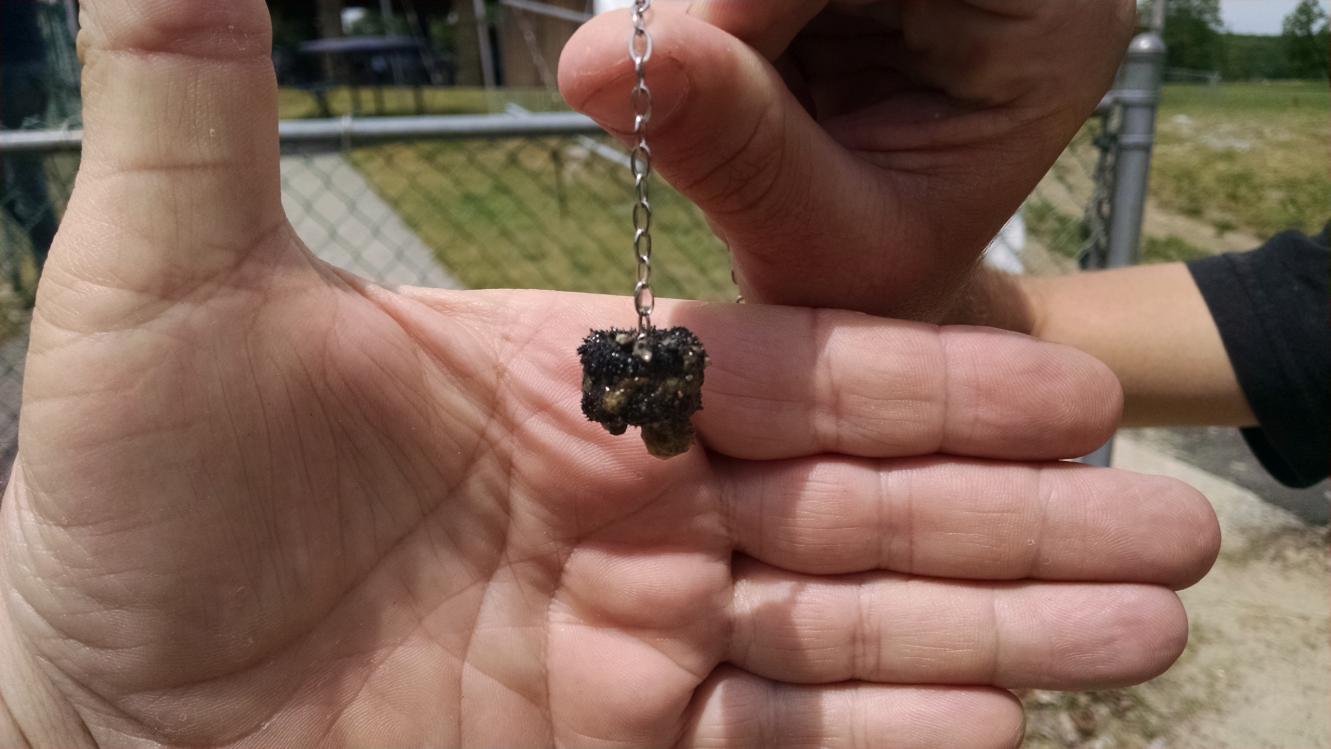

    But did we know this?
    This is what I discovered on my rare earth magnet when using the "mooring ball" this past weekend at the 2017 Groton SubFunRun.
    There seems to be quite a bit of ferrous material in the lake bed and I'm sure free floating particulates as well. Even the grains of quartz were sticking!!
    Is it from the natural geology of the area? Decades of steel pipe used in the plumbing corroding away?
    Is it the sole cause of these apparent RX woes? Or one of many?
    I do know one thing, those of use who use mechanical pumps or pistons for ballast control, even wet side gear reduction do suffer mechanically from the "Groton Granite" (silt) just floating around in it.

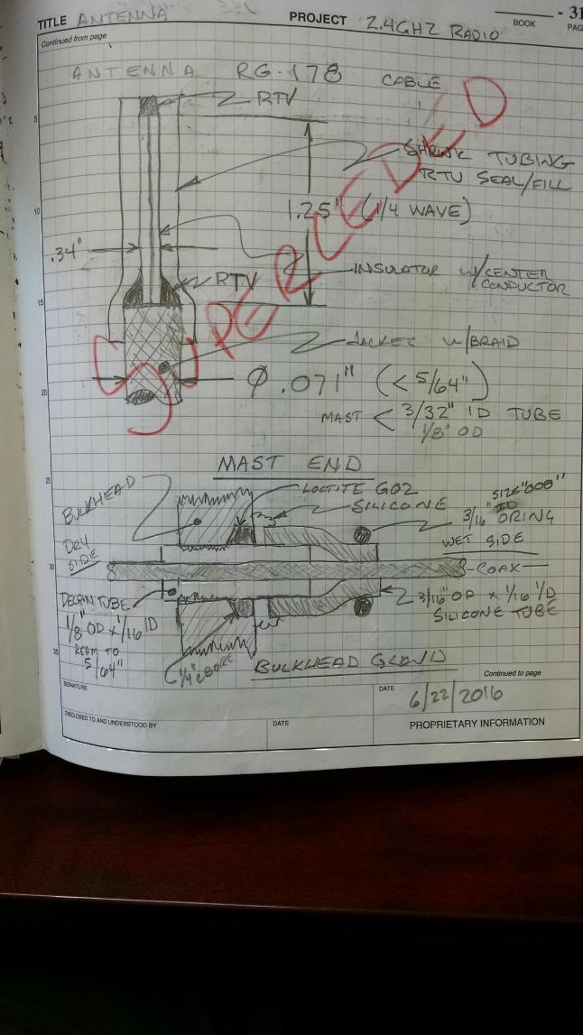

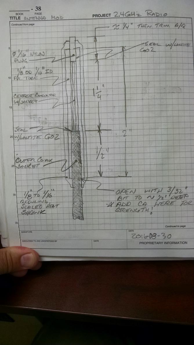

                Sorry this is late, and hope it helps....
                Some Engineering Notes for you, as well as links for the Coax Stripper for RG-178, and components:
                The thru-hull Gland Detail, I'm sure you have your own thoughts here.

                This is how I'm making by antenna's now. Using the Nylon plug at the end guarantees a seal, and itself looks like a real antenna on the model lol
Name:	2017-06-26 13.25.25.jpg

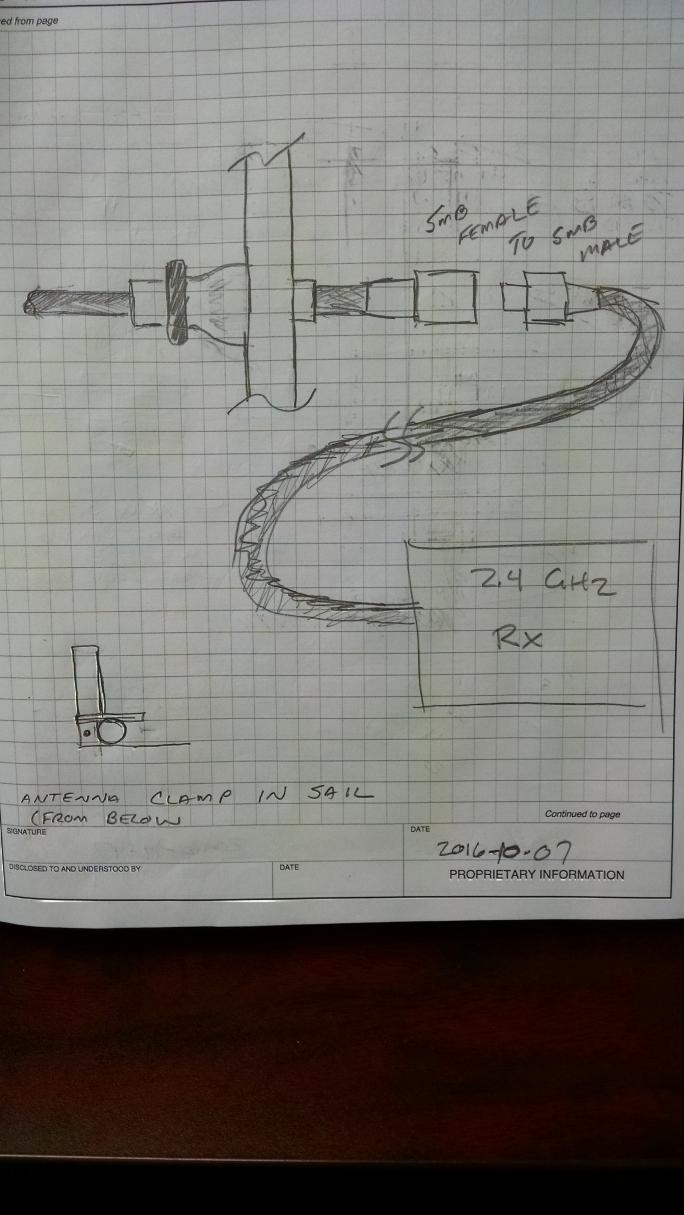

                In order to make it easier, and not have the RX permanently attached to the Antenna passing through a bulkhead. I decided to purchase these M/F Cable Assembly's in 4' Lengths.
                SMB Female To SMB Male Connectors RG178 Cable Assembly
                This way if the antenna gets damaged, you don't have to de-solder the coax from the RX. It's a tough area to solder and I'm always worried about lifting lands (Cu) off the board.
                The following shows how I'm setting it up now in lieu of a single continuous coax. Pricey, but worth it for me. Just cut the male side used in the dry space to size, and you should have plenty left on the female side to exit the dry space and be made into the actual antenna.
Name:	2017-06-26 13.26.37.jpg
                Coax Stripper: Paladin PA1258 Coax Stripper, RG178/179/735A
                Coax Antenna Plug: Wear-Resistant Nylon Rod, 1/16" Diameter, 4' Length McMaster Carr 8538K11
                Coax Antenna Waterproofing: Moisture-Seal Heat-Shrink Tubing, 1/8" ID Before, 1/64" ID After, 48" L, Brown Coax Antenna McMaster Carr 73115K71
                Coax Antenna Waterproofing: Moisture-Seal Heat-Shrink Tubing, 1/8" ID Before, 1/16" ID After, 6" L, Black, Packs of 5 McMaster Carr 74965K51
                Coax Antenna Gland: High-Temperature Silicone Rubber Tubing, Semi-Clear White, Durometer 70A, 1/16" ID, 3/16" OD, 10 ft. Length McMaster Carr 51135K608

                The biggest thing is to buzz the shield to center to conductor with an Ohmmeter after stripping/soldering to insure NO shorts. This RG178 has very thin inner/outer jacketing.
                Practice, practice PRACTICE!!
