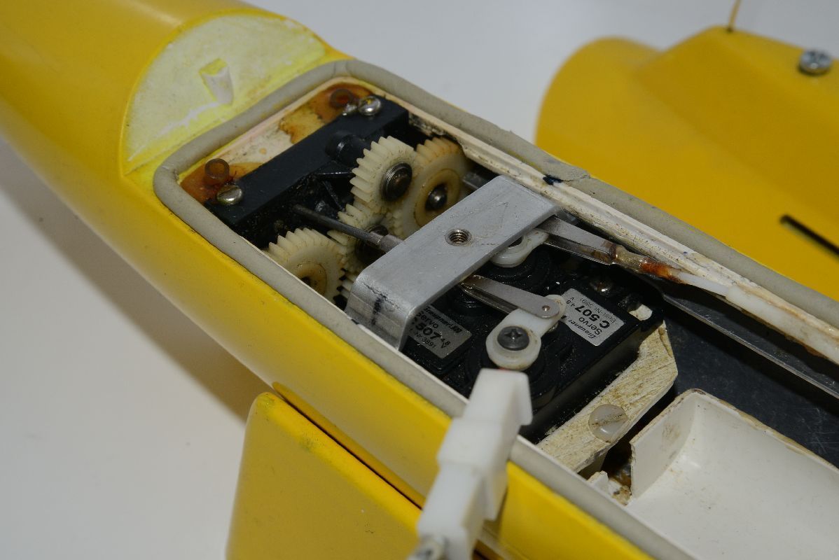

        His gearbox runs in the water, so it only needs 1 shaft seal. He offers a small turned adapter part for the motorshaft (2.3mm) to 3mm for the seal an a step to 4mm for the gear.

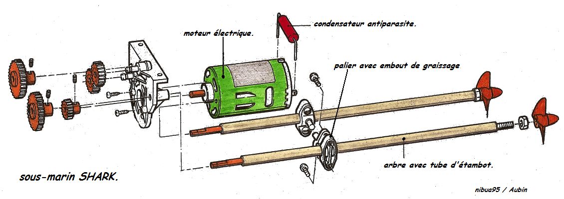

        The old Graupner Shark also has a simmilar Gearbox design, whitch runs in the dry compartment, so it needs 2 shaft seals:
        As i live in germany, I don`t have any US or canadian suppliers for the gears on hand.
        In that scale I suggest Module 0.5 gears (metric) made of brass (better quality) or POM (way cheaper)
        The axle distance is easy to calculate: number of teeth for both gears divided by 2 multiplied by Module.
        example: (22+28)/2 * 0.5 = 12.5mm
        Outer diameter of a gear is: number of teeth multiplied by Module + 2 times Module.
        example: 22*0.5+2*0.5 = 12mm
