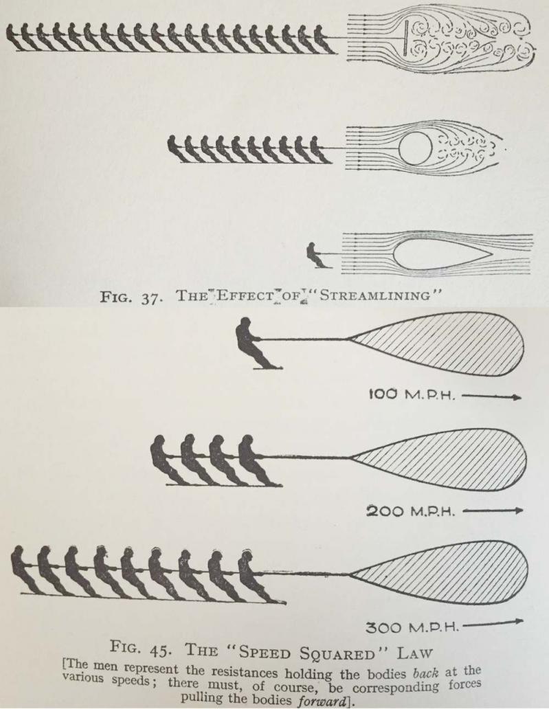

        One thing that can be more problematical for smaller boats with this 'Gopro' style of cam is that the bluff front will create a large amount of drag, sufficient to seriously upset the handling of your boat. Larger boats can take it okay (e.g. they work well on Engel typhoons), but I would use a camera which is more bullet shaped for boats under four feet.
          This is worth bearing in mind when considering shapes to push through the water. As you can see by the amount of men on the rope, a bluff shape creates a lot more drag, which is a result of turbulence created at the back of the object.
          The answer is to streamline the back of the case with a teardrop shaped cone, and aim for a cone length of around six to seven times the width of the camera case for best efficiency.
