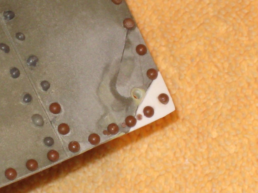

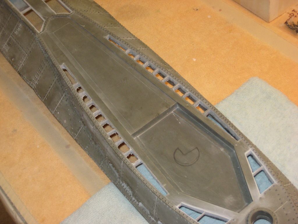

    The other day I stupidly—if accidentally—broke off the corner of the main top deck hull piece and couldn't find it anywhere. So the first order of business today was to fabricate and attach a new one using thick styrene, CA, and two-part epoxy putty. You'll see upon close inspection that rivet replacement took two attempts to achieve acceptable spacing.
    Eliot Brown's wonderful custom photo-etch grates arrived a few weeks ago, and I've been trying begin their installation ever since. Today I indeed successfully got that start. A long way to go yet, but work achieved so far has decidedly built my confidence.

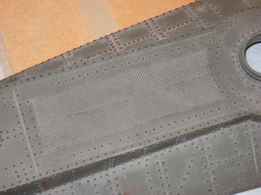

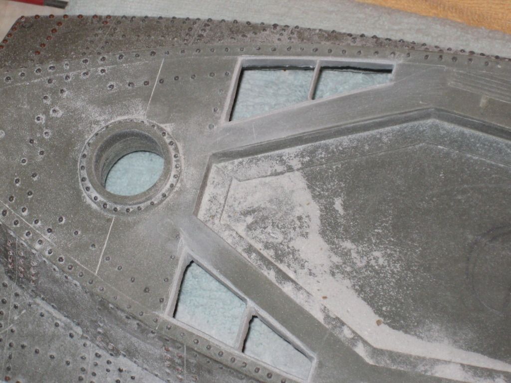

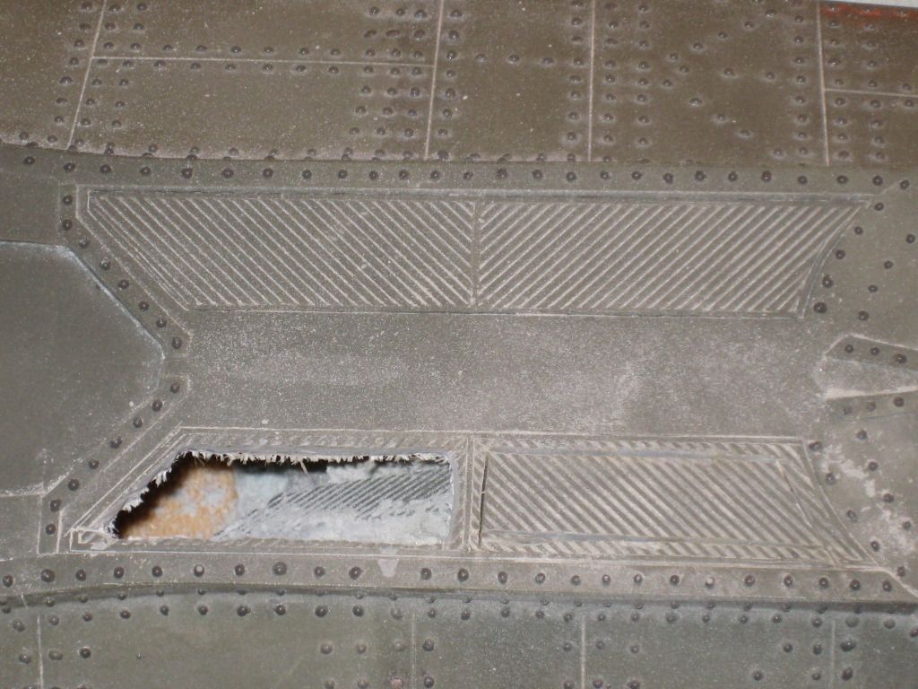

    Here's a view of the grates I chose to start on as they appear molded-in to the aft end of the superstructure. I picked this grate as seemingly the easiest to do, so a good one to start on to determine exact methodology and to get in some valuable practice before moving on to the dicier ones.

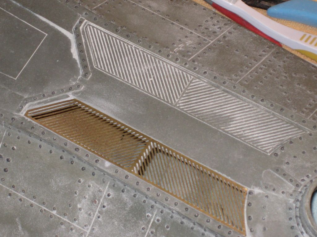

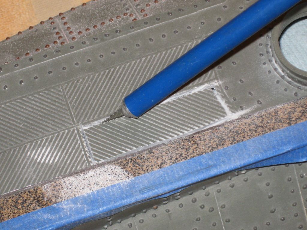

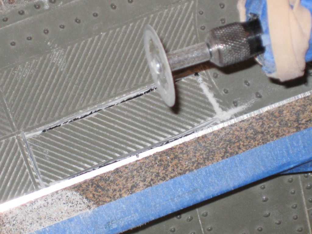

    Initial straight cuts were made against a metal straight edge using a thin Dremel diamond cutting wheel. Small or curved cuts were made using the old standard method of drilling a daisy-chain of small holes linked together to form a cut (not shown).

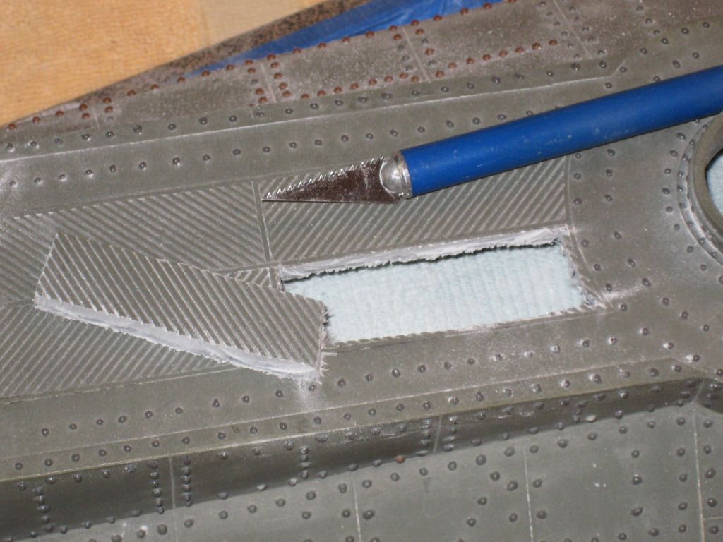

    Final piece cutouts were achieved using an X-Acto knife with sawtooth blade.

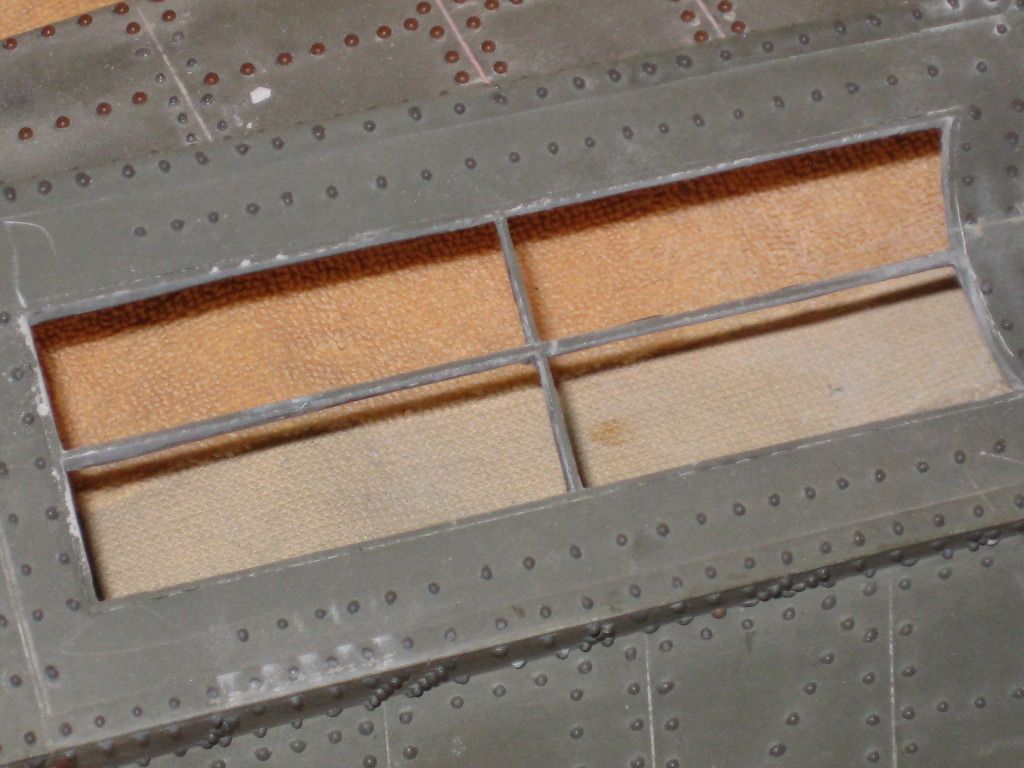

    Cutting continues. Edge filing and cleanup starts.
    Cutouts complete.

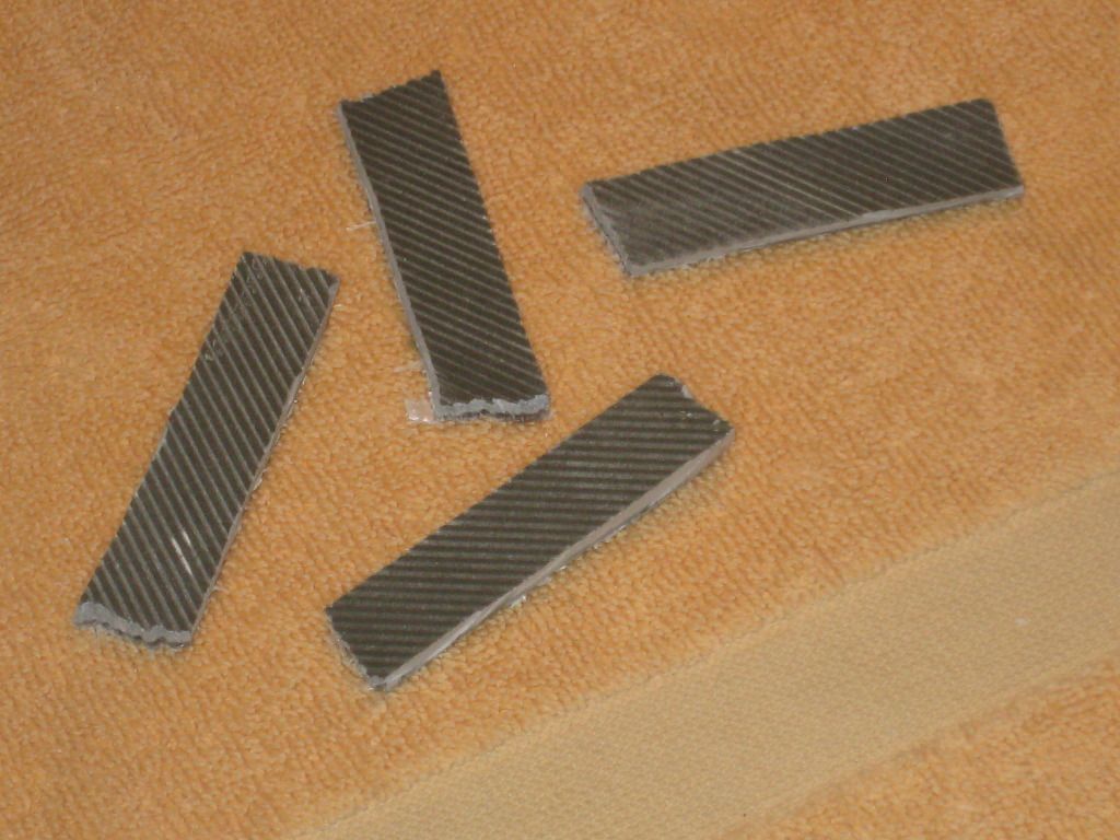

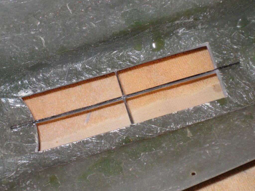

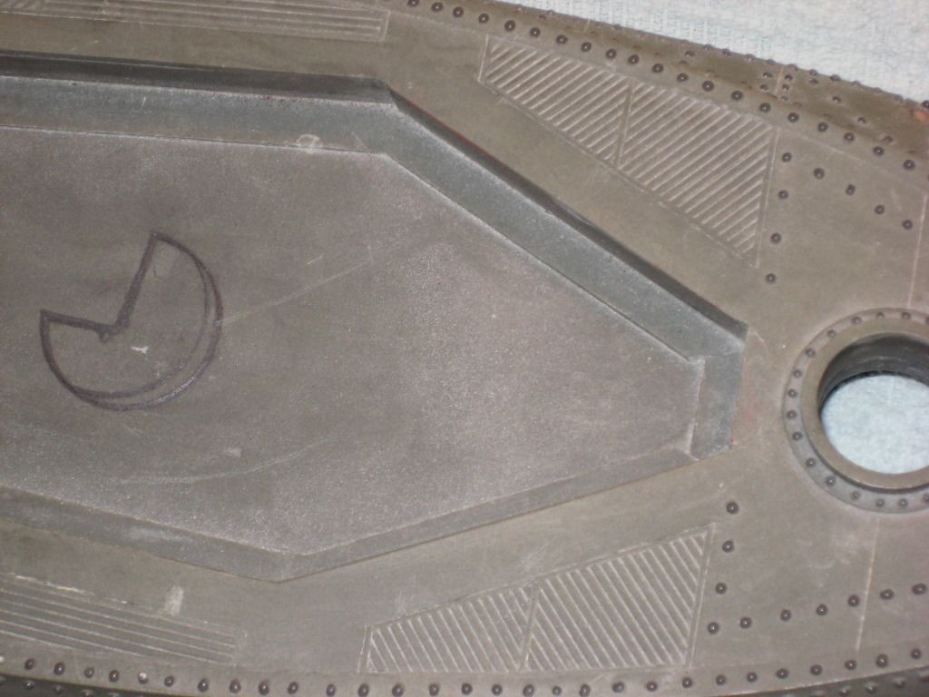

    The thin frames left to support the PE pieces are undeniably thin and weak in this particular section of grating. So I flipped the superstructure over and CA'd lengths of carbon fiber underneath them to add reinforcement. Much stronger now!
    Lips around the edge of the grating now had to be carefully filed out to allow the PE piece to fit flush to the deck. This shot shows the area after this delicate work has been achieved. Yes, I managed to unavoidably add more scrapes and gouges to the deck during this process. Bad ones were puttied over, minor ones were just sanded down. Some others were simply ignored. Remember, this is a boat which makes its living bashing into things. Worn areas, scrapes and gouges will only add authenticity and "natural weathering" to this build. (How fortunate for me that the subject build is thus so forgiving!) Note]http://i1143.photobucket.com/albums/n637/jefftytoo/IMG_6672.jpg[/img]

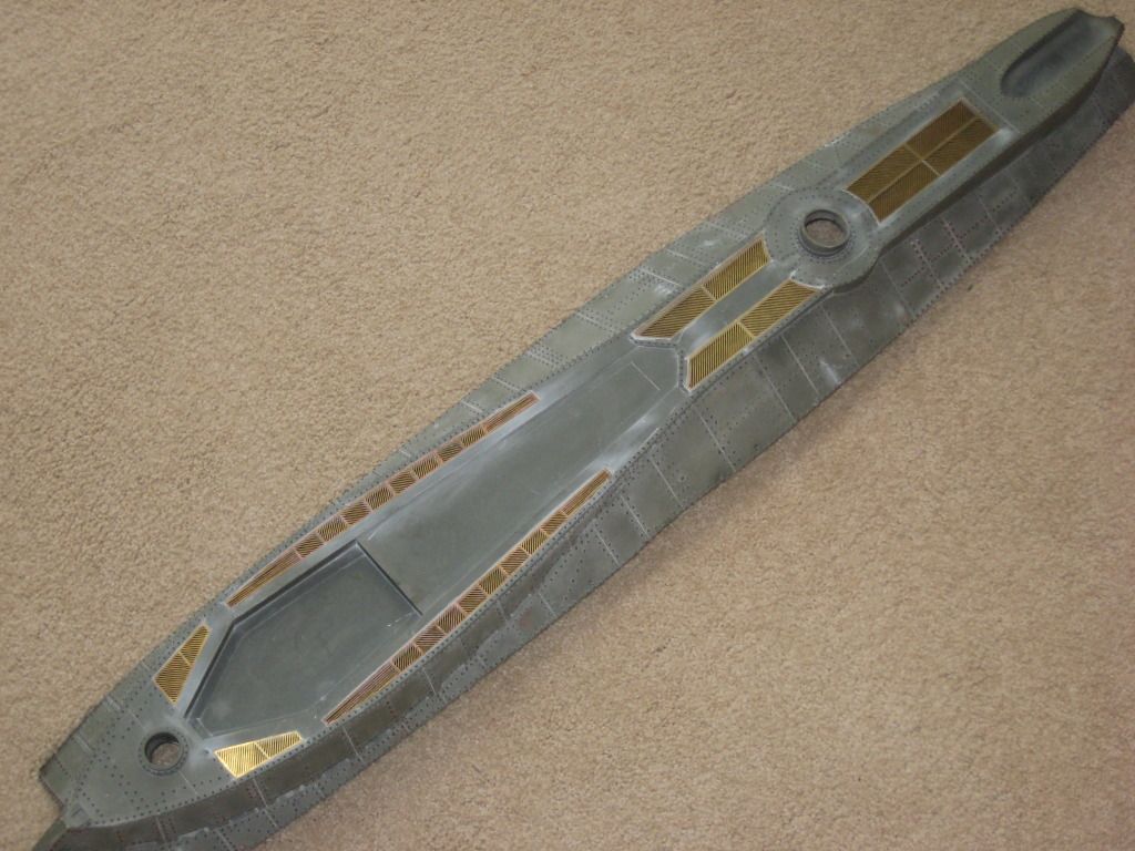

    The big PE grating piece now laid into place (glue-down will come later, after underside painting). My time and patience paid off]http://i1143.photobucket.com/albums/n637/jefftytoo/IMG_6675.jpg[/img]
    Now just memories...
    It was definitely a lot of work, but I'm proud of how this first grate turned out. Those of you who know this boat know that much of its superstructure is covered with gratings like this—I've a lonnng way to go. But as I said above, I've made a good start. Crozier, if a ham-fisted dope like me can do this, so can you on your boat!

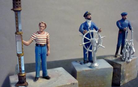

                Amazing local static modeler Lars Liljeblad and I met utterly by chance only weeks ago in a parking lot, when as a totally stranger he'd purposely strode over to admire and compliment my 20,000 Leagues denim jacket, spotted from a few cars away. A conversation started wherein we learned of each other's shared interest in modeling in general, pop culture submarines in particular, plus our fannish devotion to all things "20k". A fast friendship was born, and I immediately met some of his pals from the local modeling group he currently runs. Lars is a very skilled artisan, building all types of static models (his Jupiter II build was once featured in well-known Brit publication, Sci-fi & Fantasy Modeller ), but specializing in figures.
                Here's his group's website]http://scahms.kitmaker.net/[/url]
                And here's his own website, displaying much of his very impressive work]http://larslil.com/[/url]

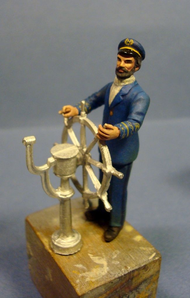

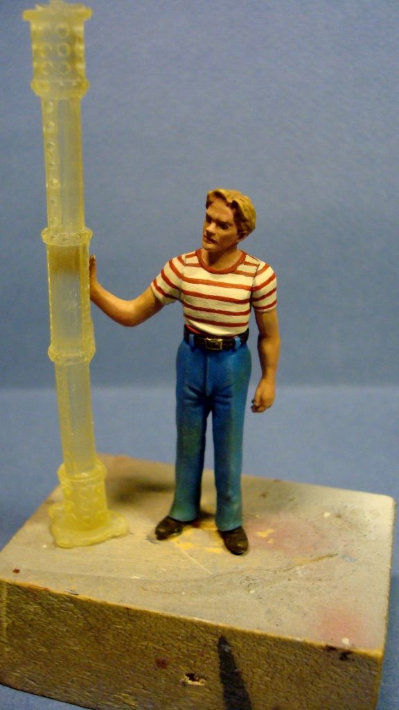

                Long story short]Nautilus[/i]' wheelhouse.
                The figures are from a CR upgrade kit sold for same by Jim Key. The biggest problem with the set (from my point of view) was that Nemo was—quite wonderfully—depicted wearing his quilted smoking jacket for display in the salon, whereas I wanted to show him in his blue captain's blazer, which he wore throughout the rest of the boat, particularly in the wheelhouse. I began a conversion to achieve this using the torso of the Professor Arronax figure (who was wearing a coat which could be shortened to jacket length) married to Nemo's head, with a converted German tank commander's hat thrown in for good measure (filling in for Nemo's dress captain's hat). Lars expertly achieved this then completed the conversion by adding the requisite white turtleneck sweater, etc. He then built-out the other figures, adding some kitbashed appendages to achieve the desired poses, and voilá—we now have what you see below]Nautilus[/i] like nobody's business. Remember, these figures are only about two inches tall!

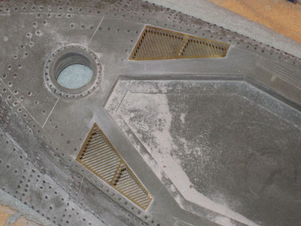

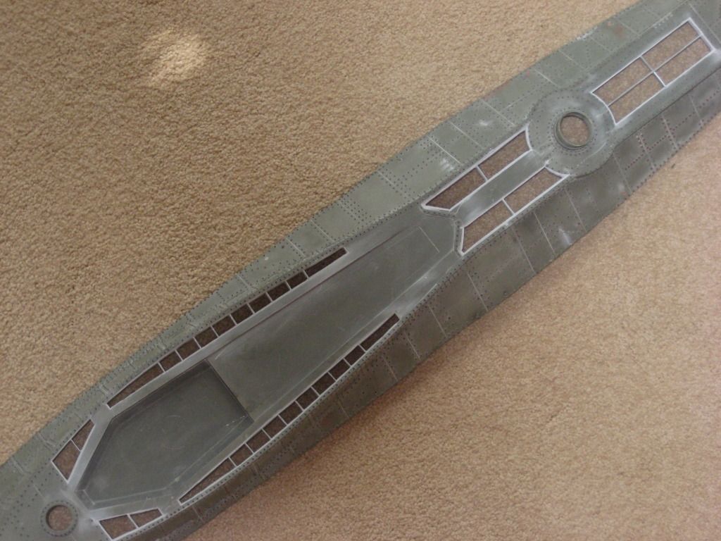

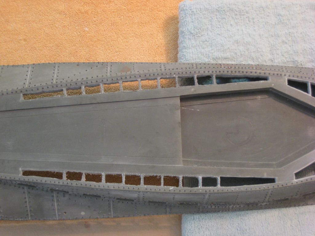

                  Completed more Nautilus PE grate installation during some time off for a long weekend last week. Lots more chips, scrapes and gouges created, but they were accidents which couldn't have been helped. More rivets were destroyed too. All this shall be repaired and/or replaced "...in God's good time."
                  You can see from these last three shots that the long sweep of grates along either side of the wheelhouse are at this point only ground out, not yet neatly filed back. That's next, followed by reducing the height of all the crossbar frames and creating a lowered lip around the edges so the PE pieces will fit flush with the deck. Coming soon...

                    Took a day off work today. It's gonna be nuts there for the next six or eight weeks, so this'll be my last one for awhile. Wanted to put it to good use, hence, I spent it with Nautilus and managed to finish filing and sanding out the wells and lips in her superstructure which will contain Eliot Brown's custom photo-etched grates.
                    I discovered that the two longest pieces were still not quite the correct size—just a smidgen too short. A revise is now in the works; Eliot's the best! Also found, as I'd predicted, that the cutouts for those same two elongated pieces were by far the most difficult to do. Many more gouges and scrapes have thus been added to the deck. Also, I found I'd been somewhat overzealous in scraping out their lip areas. Putty or glue will now definitely be required to fill in some wrongly removed or otherwise unsightly areas once the PE pieces get affixed to the hull. Then there are also all those damaged or destroyed rivets to replace. Obviously plenty left to do, but these PE cutouts are now DONE. Hallelujah! And I think you'll agree (as some already have above) that they look good and were well worth the extra hours.

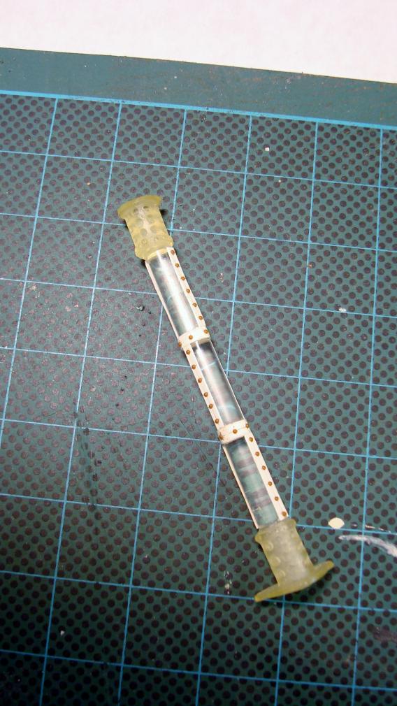

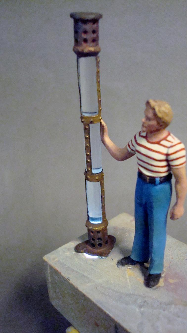

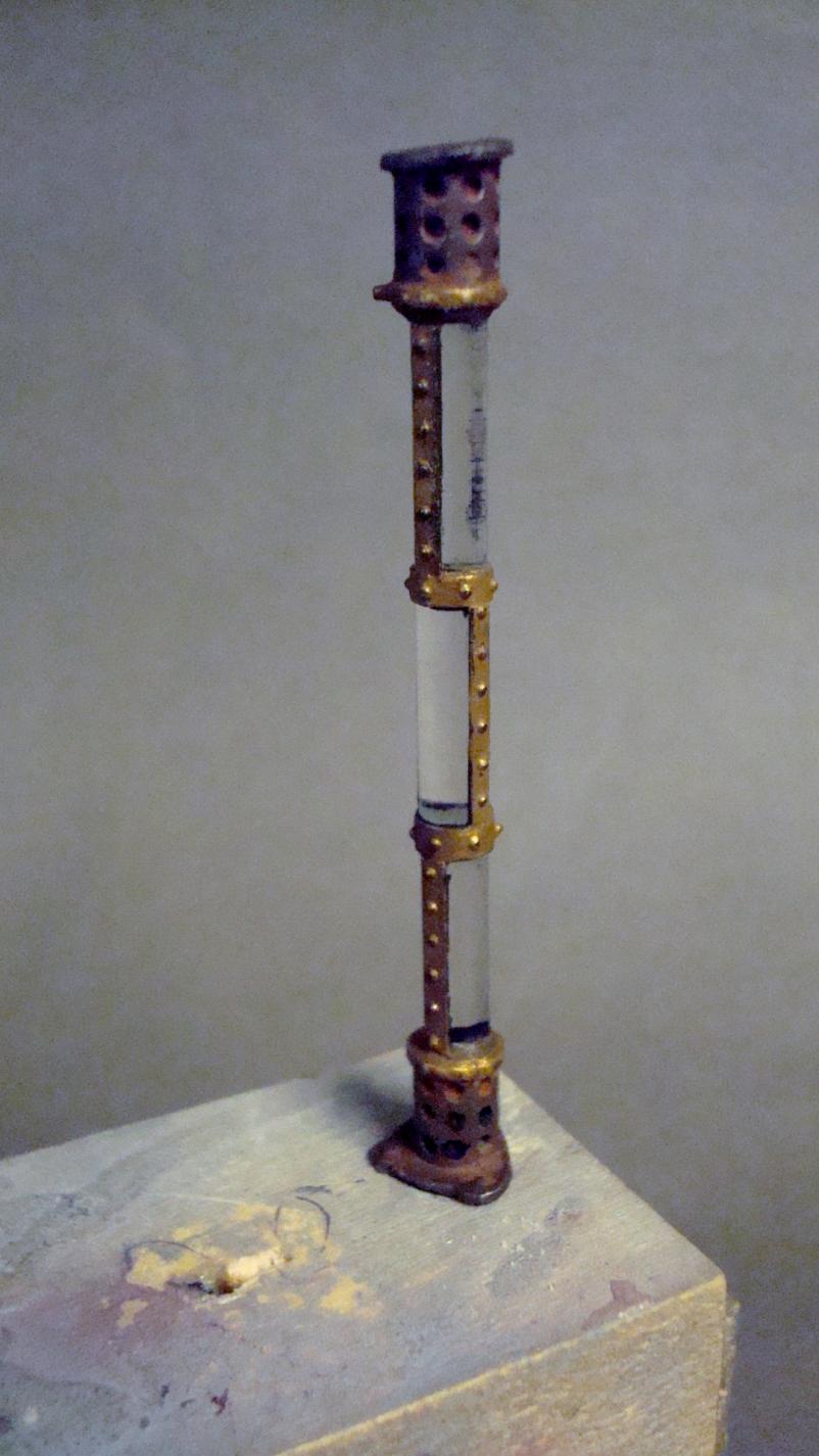

                      Buddy Lars has now started serious work on the wheelhouse build of this group-project Nautilus. First order of business: the float tube. The kit-supplied piece comes to you dingy and yellowed and not at all suitable for lighting up as is the one on the movie set. So a scratch-conversion was undertaken: cutting off and keeping the parts which will be painted, but replacing the "clear" tube with a segment of actual transparent acrylic rod of the same diameter. Then the metallic bands and struts (for lack of a better word) are added back with thin strips of styrene, and very tiny plastic model railroad rivets employed to replace the ones lost from the original piece. Now add an LED at the bottom (which will be inserted further to better illuminate the tube when fully installed; the dimmer ambient light inside the wheelhouse will help too) and voilá—a lit-up float tube truly fit for Nemo. The test shot sure looks good regardless, eh? A round of applause for the very talented Lars Liljeblad, ladies and gentlemen! More to come...
                      JeffP

                          • 2359
                          That looks really good. Would it make sense to put an LED at both ends or would that be unnecessary?
                            • 947
                            Hey Salmon -- love the new family pic avatar! Well done! A second LED in the float tube? Sounds good to me -- lemme check into it. E-mail me and let me know how things are goin'...
