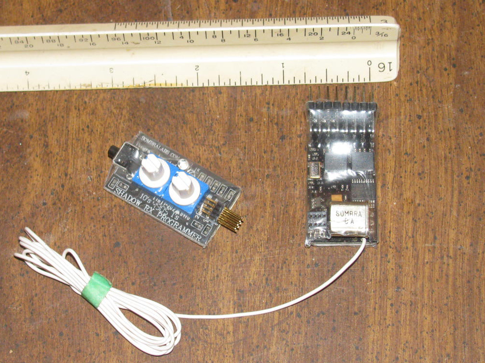

        I happen to have a Sombra SL-8 Rx that I will be using in a small system.
        Jeff's post reminded me I had it here in the house.
        Here is a photo of the Rx (on the right) with programmer (on left). (.75" wide, 1.75" long, .5" tall)
        Right click on it to see it full size.
