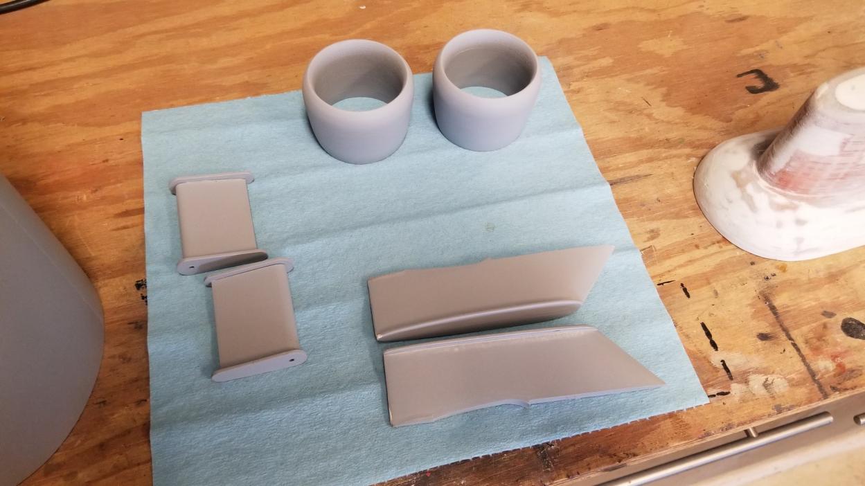

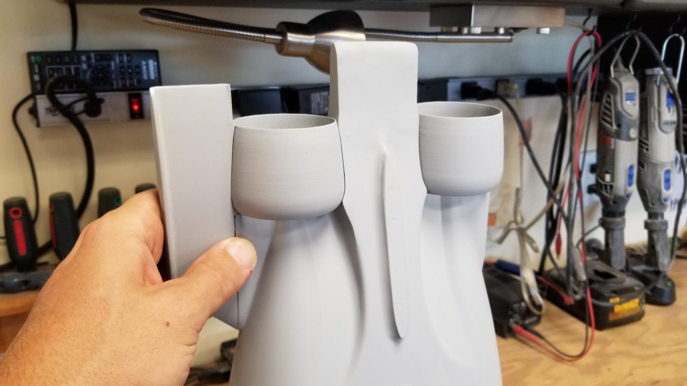

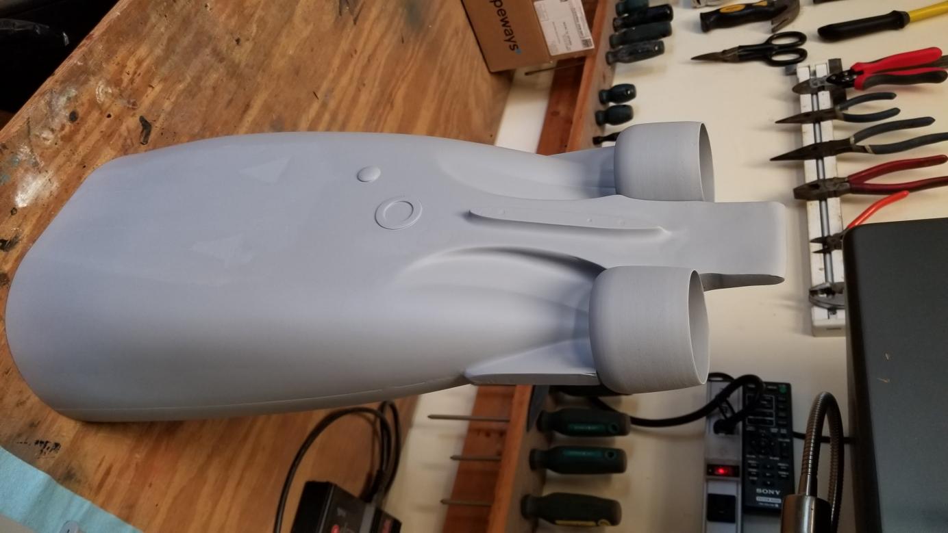

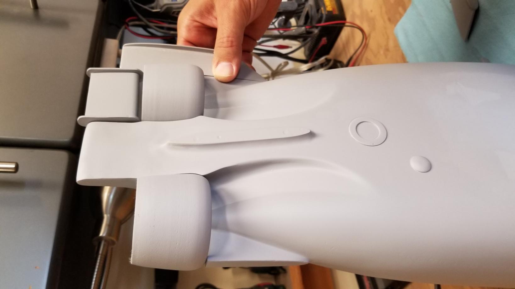

    My part in this is to completely re-build the master model.
    The entire stock sail was pitched in the garbage. All of the hull scribings have been filled in. The stern has been cut up and completely rebuilt with larger, more accurate prop shrouds that will allow for 50mm, custom-manufactured brass props. I have plans to offer fully detailed missile hatch pieces that can be installed as functional doors. A full set of periscopes will be included. I'm also working up the engineering that will allow a pair of 3.5" cylinders to be installed side-by-side, exactly like the original boat. This will allow operational periscopes in the middle as well. No plans to render scribed anechoic tiles. In this scale, they are better represented via creative paint than oversized lines.
    Will this be a hyper-accurate, bolt-for-bolt re-creation of the Typhoon? Nope. I've got to work with the parts that I have to work with. Will it be a slick model that will build into a beautiful representation of the boat. You bet!

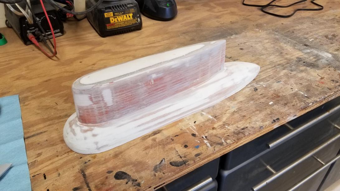

    At this point, I've nearly completed the re-work of the stern. The new sail has been fabricated and I'm currently sanding, priming, filling, sanding, getting it ready for paint and scribing.
    I wanted to share the progress so far. If you have ideas, suggestions or (creative) criticisms, by all means, fire away!
