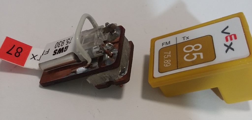

              Well I was doing precombat checks and my 6 channel 75mHz mini receiver went out. Anyone have one I could buy off them this weekend?
              • cheapsub
                • Feb 2011
                • 200
                shifts, up or side pins, channels, need crystal?
                Good stuff like JR.
                Ok stuff GWS, Hitec.
                Mistry stuff from China?
                I Got some used 72 that's works on 75 Rx.
                • coryhenry
                  • Jun 2020
                  • 107
                  I don't really have a preference for cheap or expensive, just want it to work, but it does have to be small to fit in a 2.5 in tube. I have power across the pins but the signal is not getting through for control. I have the vex controller from Nautilus to pair it with (75.85). I don't think the crystal is bad but don't really know how to check. It does have to be 6 channel, and prefer side pins.
                  • cheapsub
                    • Feb 2011
                    • 200
                    Finded.
                    Do you you need a standard crystal adapter for the transmitter too.

                      I believe I will need the adapter as well
                      • cheapsub
                        • Feb 2011
                        • 200
                        Please PM me.
