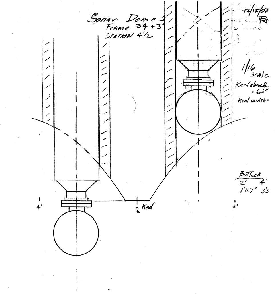

    I used the picture on
    I used the picture on Page 5 of the reference Manual you refer to of the two Hydrophones plus the fact that the hull openings are 22" in diameter according to the Gato Docking Plan to model the hydrophones for my USS Grouper I'm building using the Revell Lionfish kit.
    The photo is of the hydrophone and all the mounting hardware except for the 22" shaft. You can just see a brass peg sticking out of the top that will be inserted into the vertical shaft. I got a little carried away and made the hydrophones and the pit log retractable so I wouldn't damage them when handling the boat.
    I have some drawings I made that I built the hydrophone from that I could scan for you if you like.

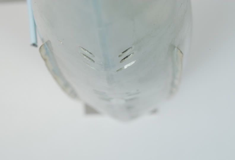

        I've attached two drawings I made of the Hydrophones I built for my Grouper, SS-214. As I said before the dimensions are from the figure in the Sonar Chapter of NAVPERS 16160, 1946. I did not include the hardware for making them retractable.
        I've also attached some photos of my 1/180 scale hydrophone installation on my Grouper build. You'll also see the Pit Log I implemented.
        The hull curvature is a little exaggerated!
        Extended
        Starboard Side
        Retracted
        Please excuse the putty I need to clean up. Let me know if you have other questions.
