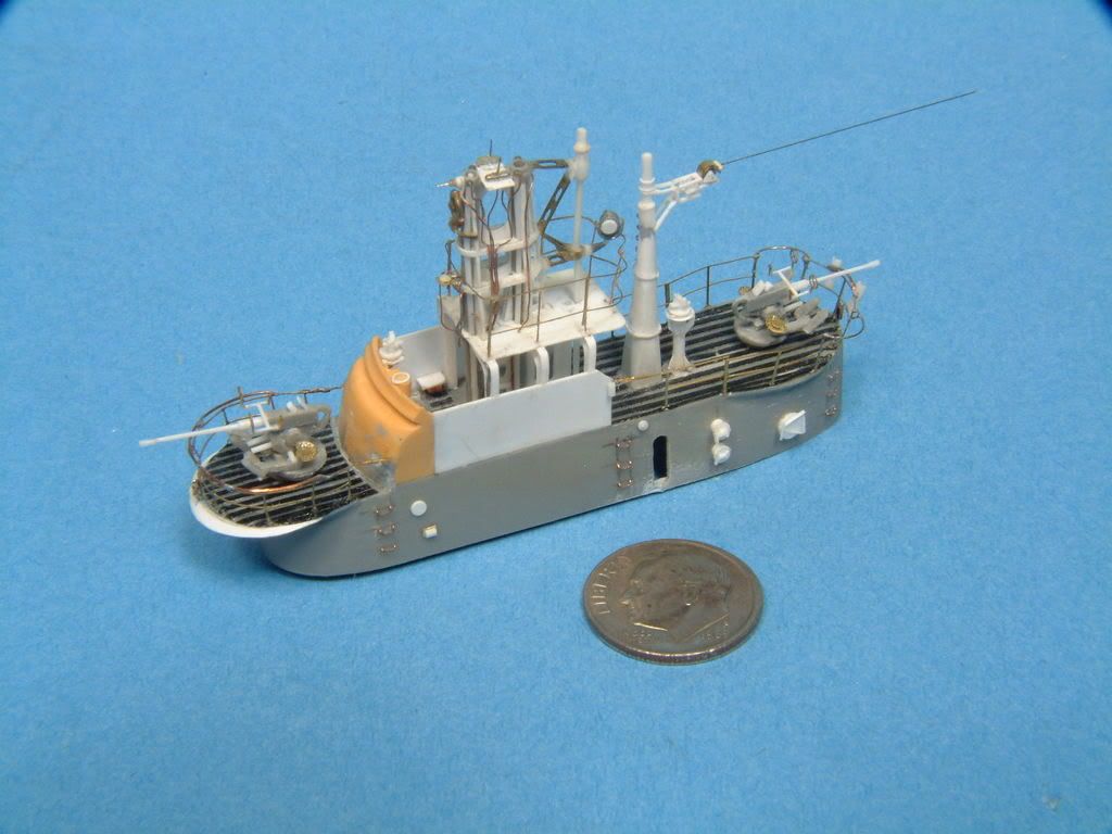

            They even included the DCDS (Depth Charge Direction System) sensors on pg 3/8, very nice, but they should have a total of 4 as there is one on either side of the superstructure just below the fairwater so that the DCDS would have 360 degree coverage. I scratch built these for my 1/178 Grouper (1945) See Below
            It looks like the SJ reflector might work out ok. Just need to scrtch-build a SV reflector now.
            This set has a lot of nice additions but will have to purchase two sets.

                      Grouper?! That's "my" boat! My very good friend, a man like a second father to me, served aboard Grouper in 1957, so naturally I'm doing the Revell 1:72 as Grouper (but Jan 1943, she didn't look as funny then). Great choice!
                      Thank you for info, any and all is appreciated. We are working off of as many photos as possible, and then taking in some info from museum boats, but most are all non-WWII now, so a lot can't be used. (Similar to the U995 situation for VIICs, but maybe a little better).
                      Your DCDS are a nice touch!

                        Yes, I had read that there were 6 DCDS sensors but I have not been able to locate the two you mention. I'm not surprised that I couldn't locate the ". . one down by the keel" but I have looked at a number of SHIPALT photos where the DCDSs on the fairwater have been identifed with white circles identifying them as additions during the yard period but I have never found a DCDS ". . one at the top of the periscope shears". Do you have a reference (photo or drawing) that shows the additional two DCDSs you could send me? I fabricated a total of six just in case this issue came up and I would like to add them if I can find documentation to support their location.
                        I had hesitated adding the BT cover until I was able to find out what it was. I am attempting to only incorporate items that I fully understand.

                          Just like you I
                          Hey Rick,
                          Just like you I have had a hard time actually spotting the other 2 DCDS's. The info that there were 6 I read from the USS Cod Photo Guide book and also from a footnote in the USS Barb Patrol Reports.
                          I assume that the Cod still has the one on the shears but I am having a hard time spotting it. As far as the bottom one, I have a copy of the USS Cobia docking plan, and in one area it's pointing to one of the #2 main ballast tank flood valves and states:
                          [quote]Warning]
                          This is all well and good, however for the most part the main ballast tank flood valves were removed early in the war and left as open ports. The only thing I can think of is it being moved farther aft onto one of the fuel ballast tank flood valves.

                            I guess until I
                            Thanks Gus.
                            I guess until I can actually see the DCDSs in place, especially the one in the periscope sheers I'll leave the last two off. I've come to trust only photographic evidence and now-a-days even that can be suspect.
