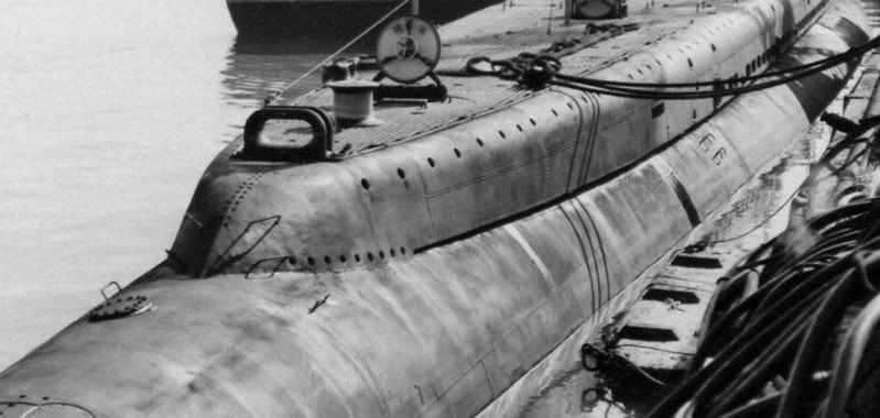

    Good question, Mermaid. Opening up all those little pin hole vents will do you no good; too small to pass any air. Since BigDave did not have quite enough ballast on board to submerge at the time of our last outing, we did not see how much of a problem this might be. I am not quite that far along myself to have had to deal with this issue yet. Soon. But.... I have given it some thought. In the bow area, I drilled a small hole hidden inside the bullnose area to let some air out there. A little further back is the little round grating over what would be the bow buoyancy tank vent. That can be drilled out. Then there is that companionway ladder opening by the foreard hatch.. that should let some air out. Some large holes need to be hidden under the conning tower, and the tower itself ought to have some concealed vents in it. As the boat dives and the stern becomes the high point, most of any remaining air should exit through the stern torpedo loding hatch opening. That's my present analysis, anyway. But there is bound to still be some trapped air back there somewhere. If you are modeling the real Gato, you are in luck. This photo of Gato's stern shows a series of reasonably sized holes right at the upper bend of the turtledeck, not depicted on the Revell model, that should do the trick. At least they were present at some time in her life.
    If you are just doing a generic fleetboat, then artistic license should permit you to have them too. I'm not sure if all the boats had these holes, but some pictures I've seen show them further up, nearer where the steel casing meets the wood deck. SS-224 Cod is one example. If you are doing another specific boat, you will just have to research the NavSource Online Archives to see where or if these holes existed.
