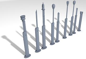

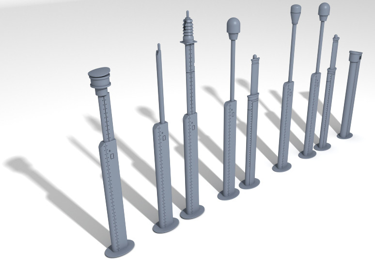

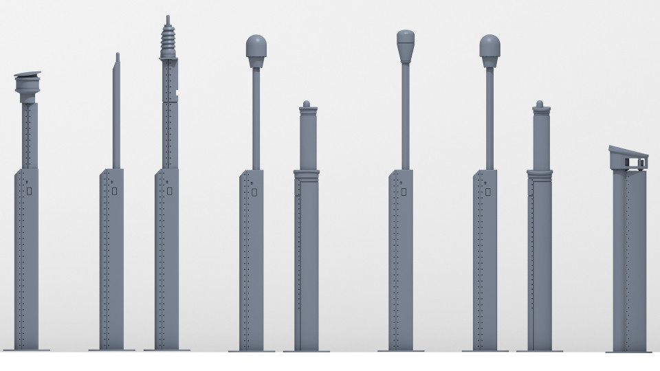

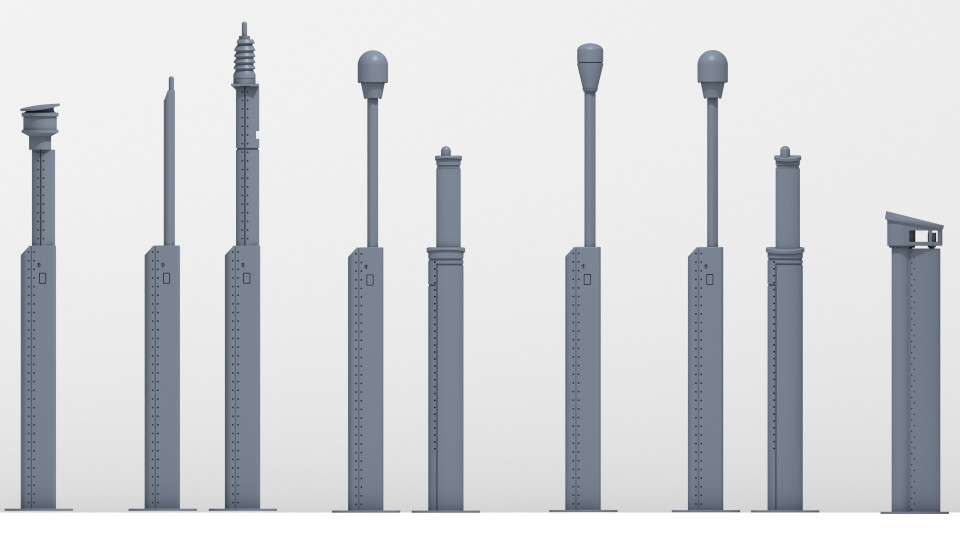

        Besides the VPM extension, Block V's will incorporate a new vertical array aft of the sail, and the aft ballast tank lower ports are molded in - just like up forward. The new LPPM low-probability of detection periscope head replaces one of the existing optronics scopes, and sports a redesigned radar with a round antenna - not the standard, rectangular BPS-15/16 series that have been used for decades. Here's a set of masts and antennas including the LPPM and ESM mast, grouped according to their paired locations. The radar and snorkel are fore and aft without an adjacent mast.
