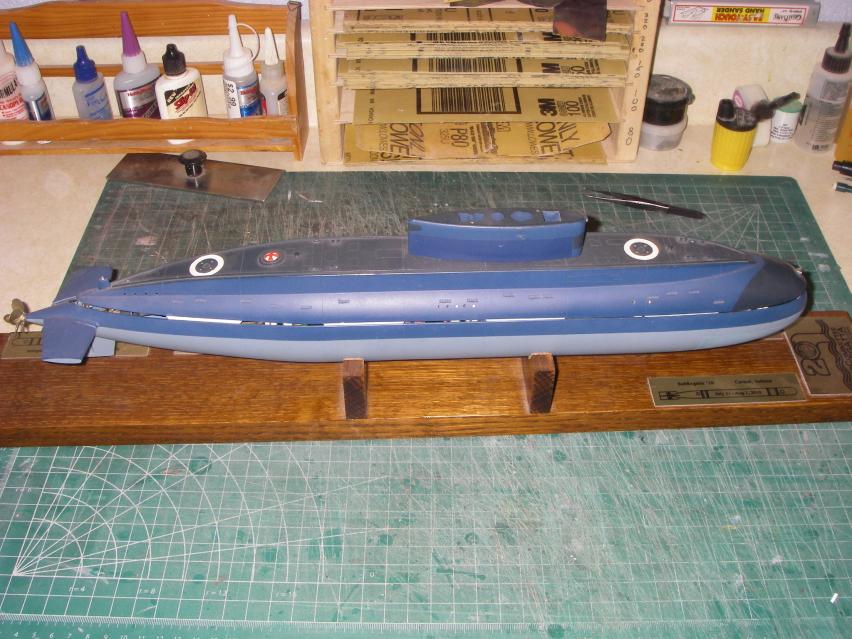

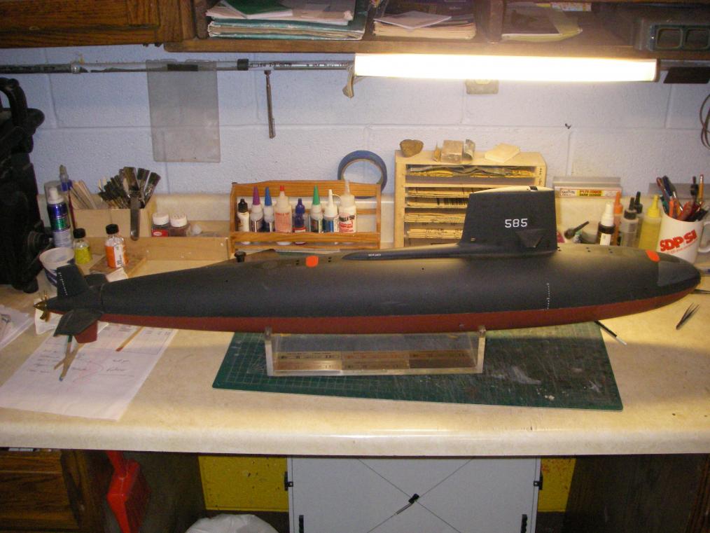

    You should be able to get acrylic screen/storm door glazing at the hardware or home improvement or glass store. It will probably be 1/8" thick or so. If you want thicker acrylic, look for a plastic shop, or some place that makes acrylic fish/reptile tanks.

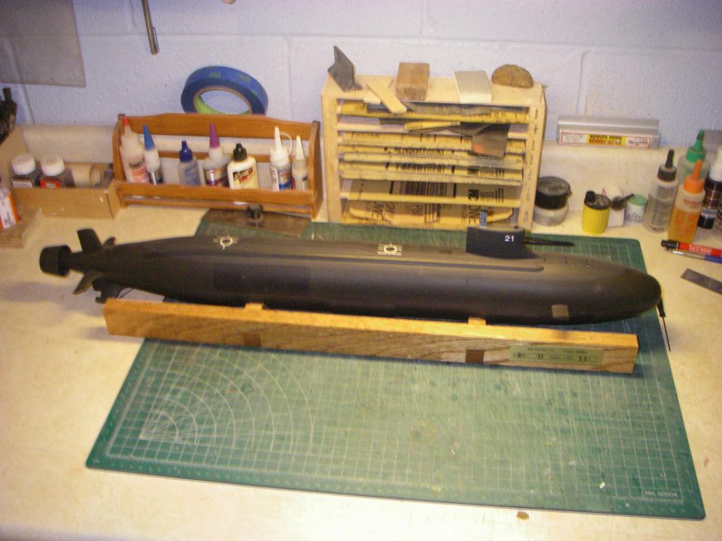

    I made the display cradle for my 1/72nd scale SKIPJACK from 3/8" thick acrylic. All of my other subs are displayed on wood cradles, mostly oak.

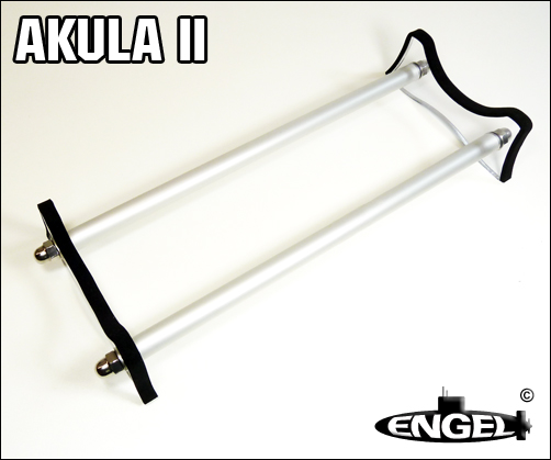

              Something like this is simple to make from two pieces of acrylic and some aluminum rods or tubes...
                Another possibility would be to place the model on keel blocks...representing how it would look sitting in a dry dock.
