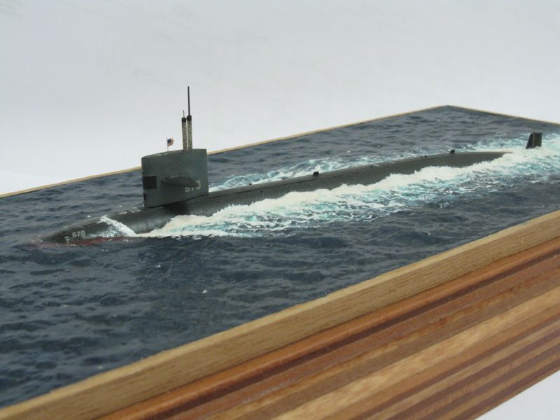

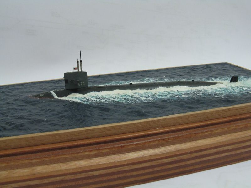

          The real amazing thing to me is that several years ago I decided to scratchbuild a 1/700th scale Sturgeon-class, drawing myself a ship plan based on the sketch on "US Submarines since 1945" by N. Friedman, on known measurements, and measures deduced from photographs (that is, I deduced the main sail dimensions from the height of crew members seen in pics and so on). Yesterday I checked the dimensions on a resin copy I have, and all of them match with a 0.1-0.3mm maximum error! Here's the manufact, still missing some ant-sized crew member on the sail.
          Thanks again to all of you!
            Re: SSN 637 accurate drawings out there?
            That is so well done! it looks real. Thank you for sharing!
