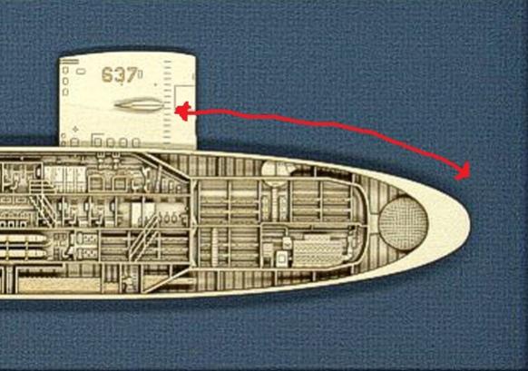

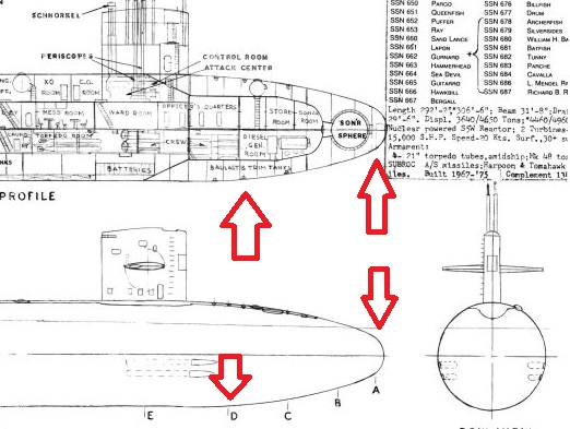

                If you take a look at the two pictures I attached, I am not sure if it expresses what I mean about the hull shape. It seems like in the one plan, there are some very abrupt angle changes at the beginning of the curve, and towards the very bow, perhaps mroe abrupt then I would have expected? Its pretty hard to determine what is and is not accurate. I feel like in the one image, the curve begins before the sail, and the other begins after.
                Jeff, I had a hard time seeing the details but do you think the Greg Sharpe drawings deviate significantly from what I have attached here?Click image for larger version

                  The line drawing has frames on the left side of the drawing.
                  The drawing I posted was an artist wall mount representation of the 637 boat.
                  It appears to me the artist took liberties in smoothing out some lines.
                  Example: the bow from the front to the A mark is a partial sphere. Round not parabolic.
                  It does appear that the hull lines start to curve at or just behind the front of the sail.
                  But then the sail looks flat all the way to the front of the sail.
                  The reason I think the artist took liberties is the location of the sail planes.
                  They are not centered on the sail which they are on the line drawing and in photos of the boats next to the pier.
                  Here is a model of the 637 that shows the abrupt curve change that I think you are referring to...
                  More photos of the model 637

                    The Greg Sharpe plans are much better than the attached above. The blue illustration is pretty correct for hull form, sail height and sailplane placement. Please, do NOT base any of your efforts off the Motionmodels debacle shown above! That line drawing is way not correct either.
                    Be patient, get the Sharpe plans, build a nice boat.
                    Bill
