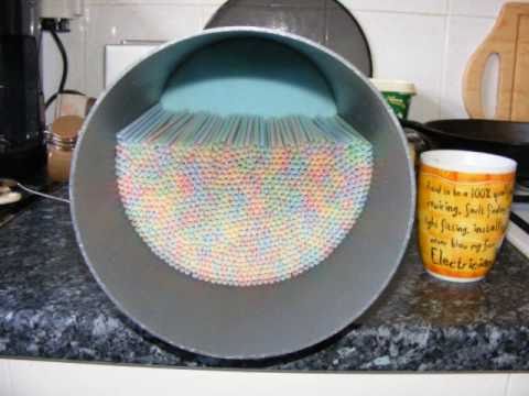

        Good news! The rear pods are holding up the rear with plenty to spare. I should be very close after all the detail parts are on.
        I do need to rework the rear nozzle as it is too constricting. It creates a vortex in the tunnel after a few seconds. With it off, everything is fine. New one will be very short with stators around the perimeter. I realize I could put an impeller in there with proper ducting but I am trying to keep this one a simple conversion. BigDave, I am still testing the one you sent me. We will see with the new nozzle.
        D
          I remember seeing a tv show about how the fountains in Las Vegas get the streams of water to floww in such a tight stream.
          They ended up using a large diameter pipe fill with soda straws. The straws took the water flowing in and made it all come out straight.
          Not doing a very good job of describing this.
          Like straight blades in the nozzle you could make something to fit inside filled wit soda straws to make the water come out very straight.
          If the water did vortex in each straw, they would counter act the ones next to each other.
          Maybe tomorrow I will try to find a video on this process.
          Fill the nozzle and this should cure the vortex issues.

            This is what one calls a collimator.....

                It's just going to be a simple tube with some details on it. No room for anything else back there....
