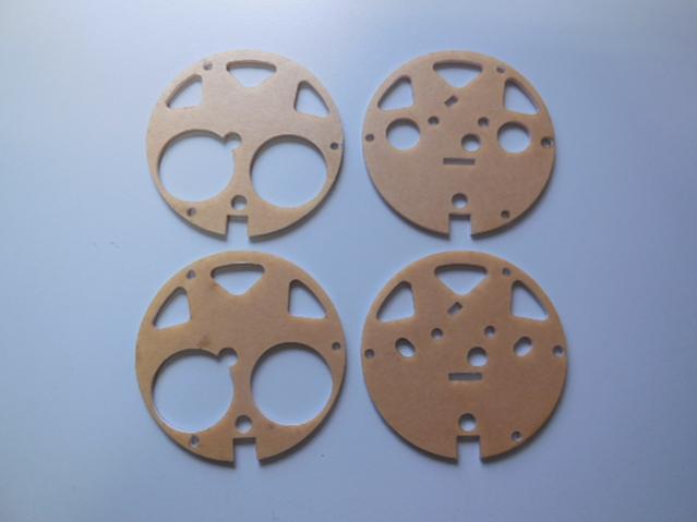

              Got the revised motor bulkheads back from the cutter:
              If it all works okay the motors will sit lower in the hull as well.....tight fit

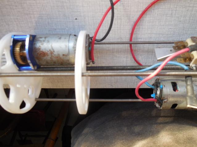

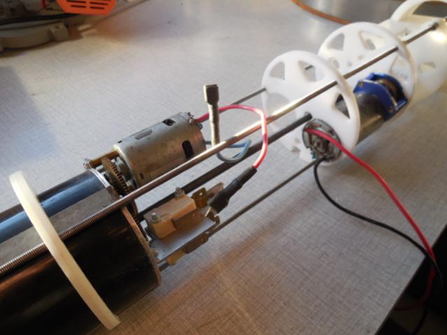

ID:	128380 Click image for larger version
                    ...piston rod to be a close fit past motor casing. Will have to file out gearbox housing. Have another look at the cad file before I start I think...

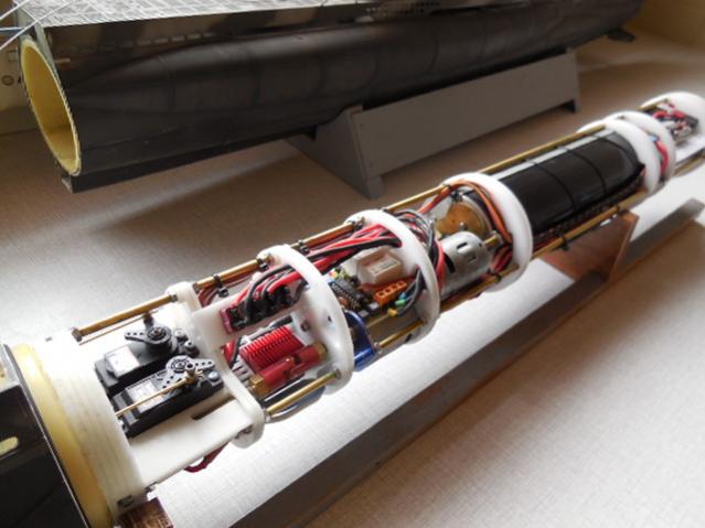

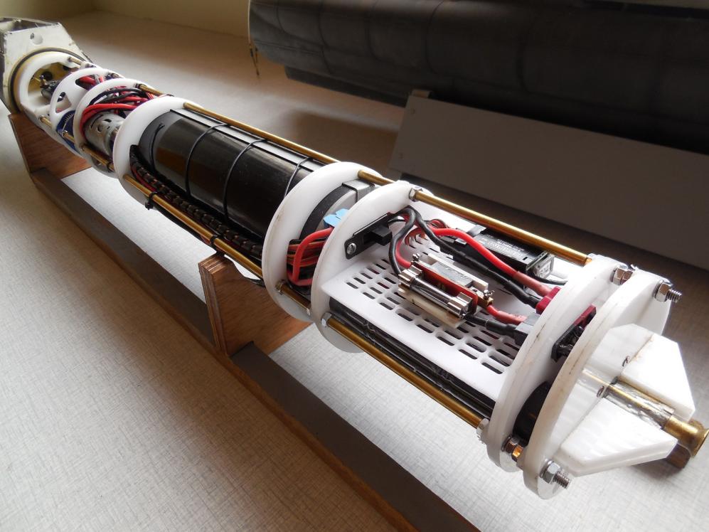

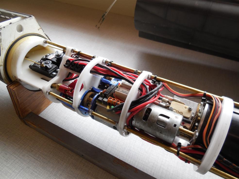

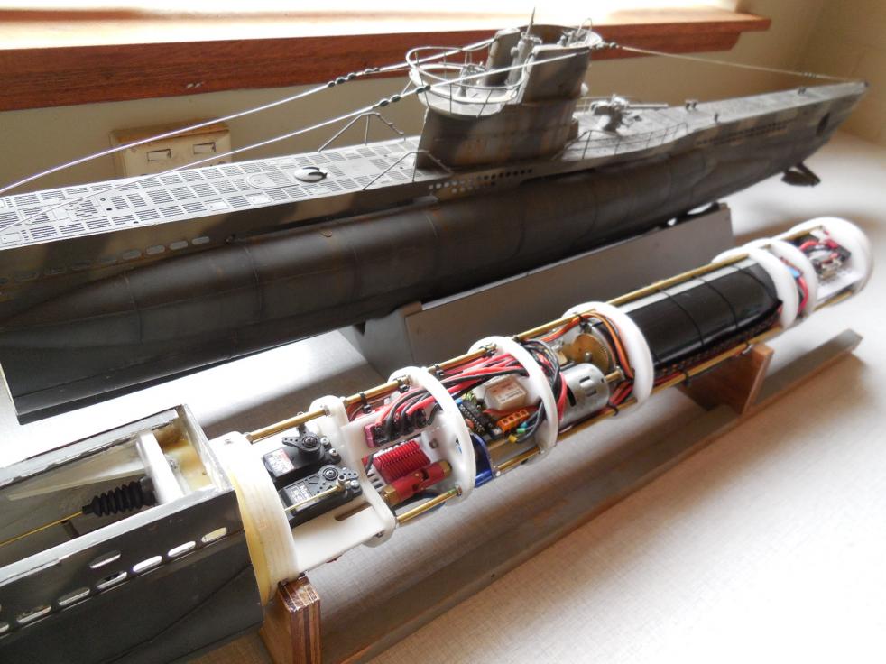

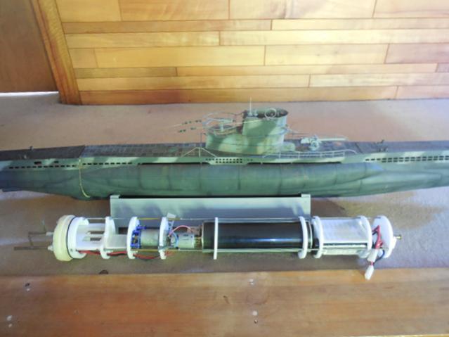

                      It's been a while......but I finished it.
                      Took so long to get parts revised at laser shop.....6 week wait everytime.
                      So I bought one.....not solely for hobby use, of course. But great to be able to fab up your own bits.
ID:	130022Click image for larger version
ID:	130023Click image for larger version
ID:	130024Click image for larger version
                      Changed the motors to 12v....6v was high amps, it was too 'hot'. I found it hard to get a good speed controller arrangement with 6v. Maybe it should have been brushless motors. I also reworked the stern section and control connections....magnetic coupler instead of trying to get the tiny allen key right down the bottom. Magnets just find each other. A magnetic switch would have been good too, I had an engel unit, but just couldn't find the space. Could not get the original solenoid arrangement to work, tried to replace with arduino parts, but I think they are for a much higher voltage.
                      Thanks for for your help and comments with this.
