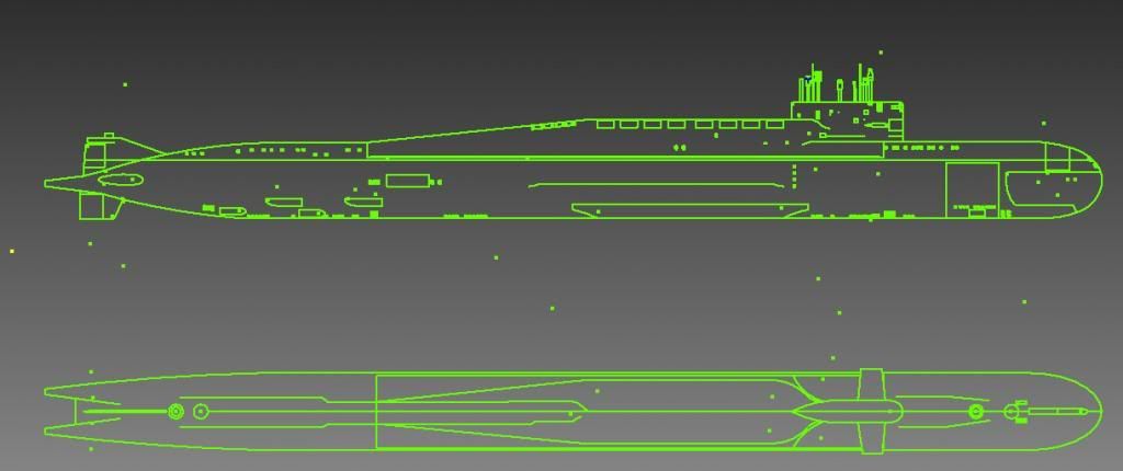

    I am excited to announce a new project. The one submarine that has been missing from our model list for years has been the Delta IV. This is my favorite SSBN, and because of it's absence I have decided to model the submarine. Thor will be doing the CNC of the master, and I will be making new plans and a 3d model for us to work from. Currently I have the side elevation view done in CAD. After reviewing many different versions of the Delta IV, I have made the elevation drawings match K-407, the latest Delta IV to be upgraded in 2012. Here is a sneak peak of the real K-407-
    I am so excited to be working on my favorite submarine. I will post progress as it is made.
    (I will of course continue to work on Alfa as well)

                          progress report.
                          I think I am satisfied with the side elevation. Let me know what you guys think of it. I changed some more things today on the elevation drawings to match the pictures so far.

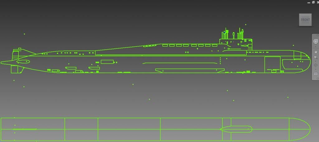

                            Re: 1/96th scale Delta IV
                            More work done today!
                              Oh Boy, a build thread to follow! If it's anything like your alfa, it's going to be a fun journey.
                              Your drawings look cool. What program are you using?
