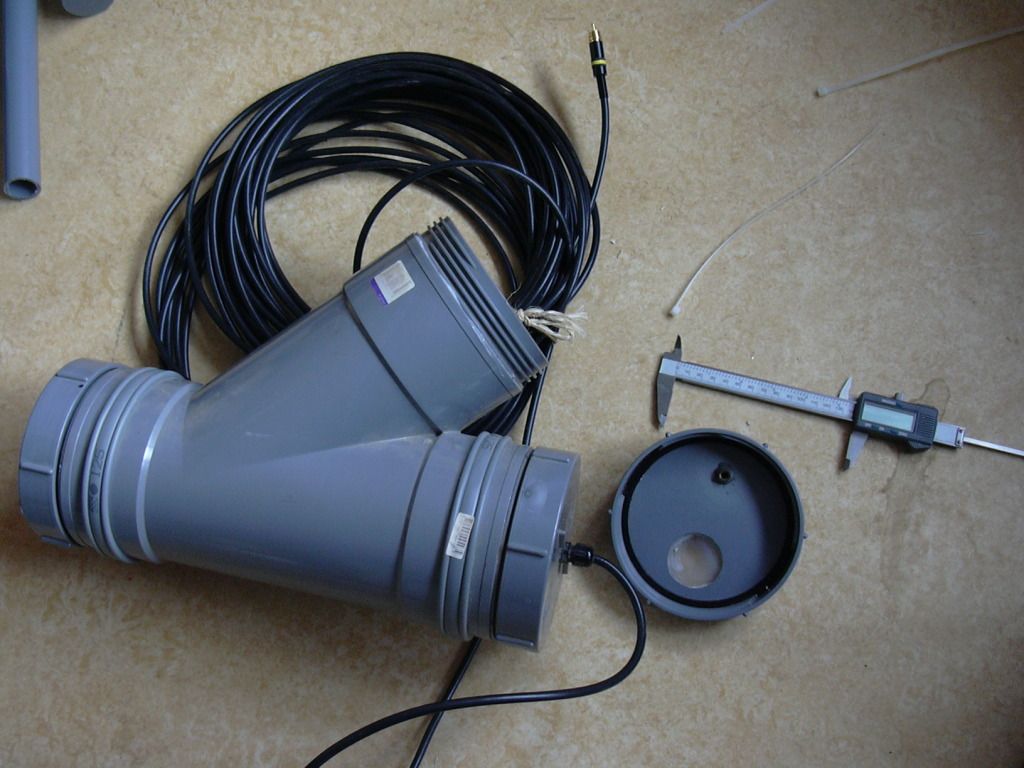

          Re: 1/35 Type XXI help
          for large scale WTC's you can check out PVC drain pipes.
          They come with a lot of special shapes, among which
          endcaps. if you can find two screw-on endcaps with your
          chosen size of drainpipe, you have yourself a WTC.
          PVC is easy to drill and saw.
          here's my makeshift watertight container for an old video recorder (you know : the ones with tapes !)
          made from standard PVC parts.
