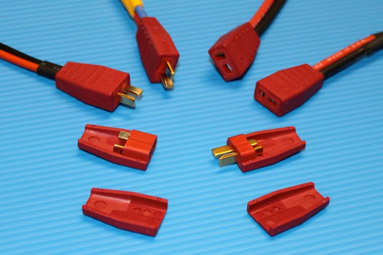

        There are Dean's Ultra plug aftermarket covers that make it easier to unplug.
        Try HDI Products Dean's Plug covers.
