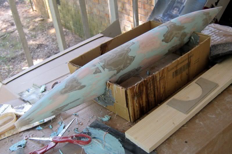

              Making progress.
              Here she is with four layers of fiberglass and one of Evercoat Metal Glaze.

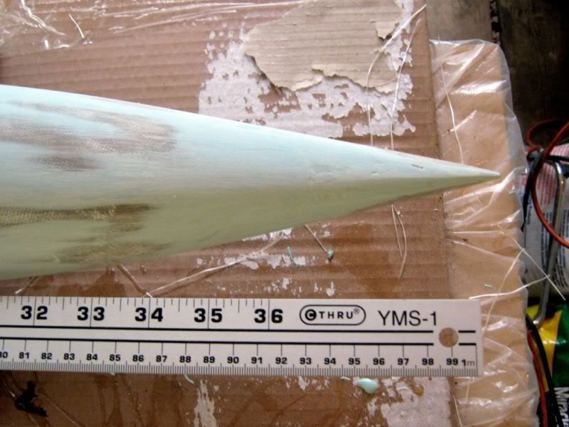

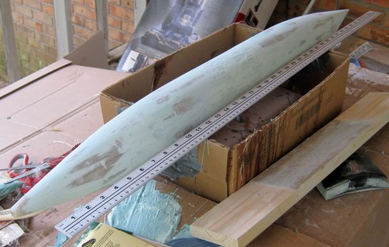

              I did not plan on the hull growing in length. Only in girth. Short-sighted of me I guess.
              I don't know if it is worth screwing up the hull to take out three to four centimeters.
              Maybe another layer or two of EMG to get the hull smooth. Then it's on to detailing and control surfaces.

                Hmmm. It is probably better not to cut four centimeters out of the hull. That would most likely just ruin the hull's integrity to correct a detail that no one else will ever notice.

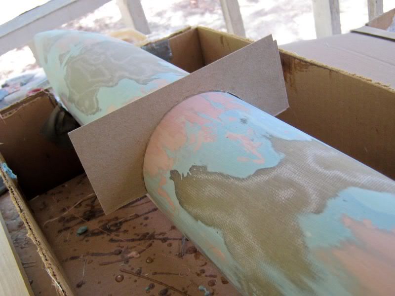

                  I checked the diameter using a tool I made weeks ago.
                  Fits like a glove!

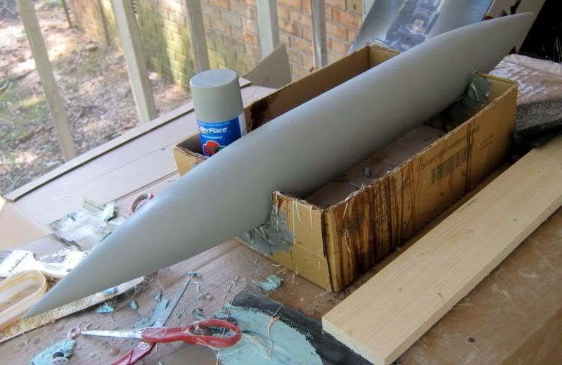

                  This means that she is 11cm in diameter as she should be at 72nd scale. AND it means that the hull is about 1/8 inch in thickness which was recommended to me. YAY ME!
                  Here she is with a good coat of primer grey.
                  There are a few flaws and pinholes showing but not as many as there could be. And it shows that the shape is pretty even all over. Shouldn't be too hard to fix.
                  Now I get to move on to the wheelhouse, the platform, diving planes and rudder.
