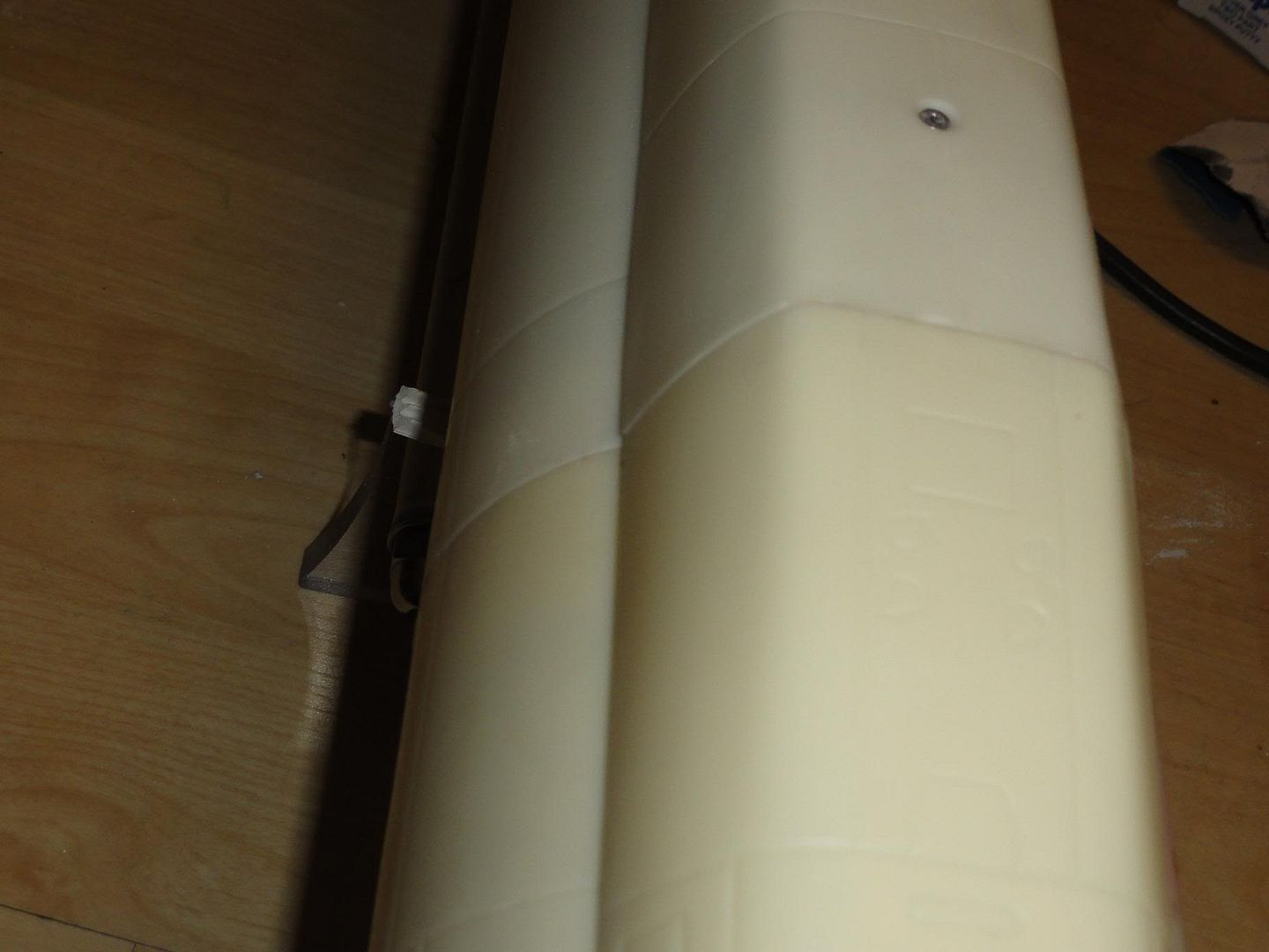

    Thats good to know about the X tails. I'll leave it as it is and save me a head ache. Heres the differance between the front and back halves of my hull. One side is a perfect, but on the other the front hull is rather high. It involve the bit where the turtle deck goes so that has to be sorted it it is ever going to sit level.

      I was going to build new yokes at first but then thought about it and said I will build it as is first and see.
      The yokes are so nice that it would be a shame not to use them.
      My hull is off a bit where yours is as well. Not as much, but once the turtle deck is on it is not noticeable.
      I think once it is black unless you really look for it you would not tell.
      I think anything I would do to make it better would screw up the good scribing and look like crapola in the end.
      It is hard and I am sure the front and rear sections are not molded as one part.
      This could easily cause them to be a little off.
      I did not bond my rear turtle deck all around the edge either. I just tacked it to the upper bulkhead and two places in the rear.
      This makes it look like there is a separation line like the real boat.

            Fixed my hull problem....
            As luck would have it, the reapired area did not involve any scribed lines.
