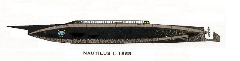

                  I have posted my dream so often that I forget someone might not know. I usually post to the TV/SciFi Subs portion of the forum. But since I had specific questions about scratchbuilding and R/C I posted here because I thought I would get faster replies.
                  Here is the sub I have wanted to build since 4th grade:
                  The aft end will be different though. That is one of the reasons I am back at my drafting table.
                  - Leelan
                    Re: Getting ready to build at last!
                    Leelan,
                    That is a great looking boat! You should contact Steve Neil. He has built something very similar to that! I know Steve's boat drives very well. It is certainly a wicked looking boat...
