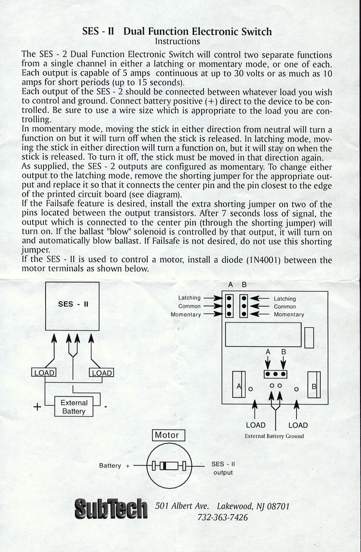

    Does anyone still have a copy of the instructions for the ole reliable Subtech SES II ?
    Can anyone tell me if I can use it with a 12V pump that draws 1.9 amp max ?
    Thanks,
    Kerry

      You should have no problem pulling that much current through the SES-II. That uses the same mosfet as the ST-10 ESC and that could handle 8 amps continuously - without a heat sink.
      Unfortunately, I don't have the instructions file any longer.

        Like so?

          What service! Skip has informed me the MOSFET can easily handle the pump amp load so we're good to go.
