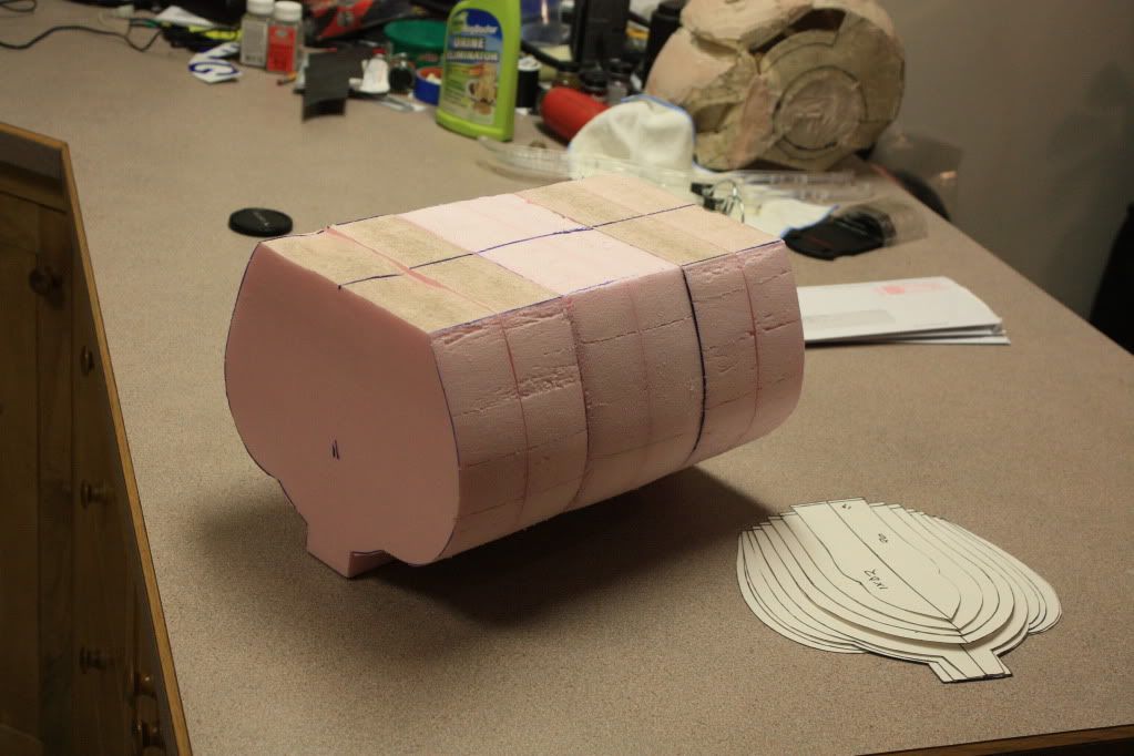

        so, i finally got off my but and got back to this project this afternoon. here is the progress so far. it isnt much, but its a start!
        ive decided to start amid-ships and work my way out! enjoy!

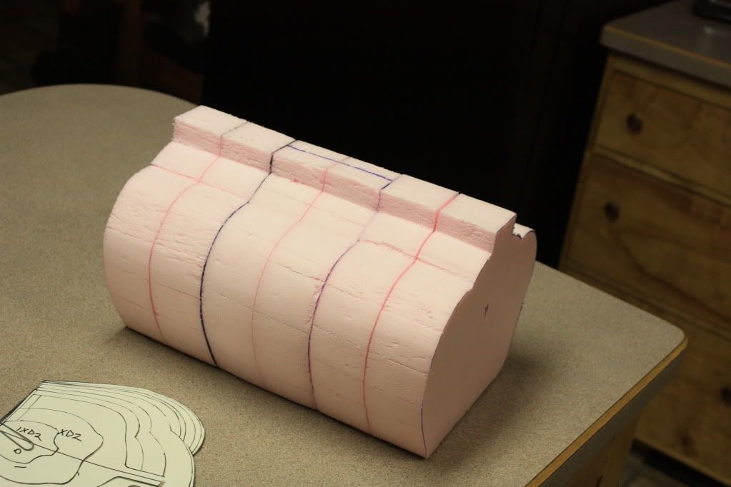

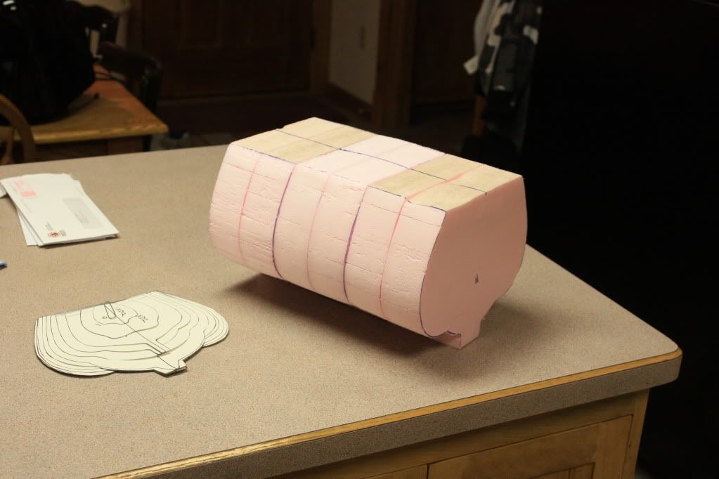

          well, ive roughed in part of the hull so far today. i know there are things to fix, im going to start on the bow right now. then ill smooth out the plug.
          i have a 2 gallon kit of rebound 25 molding rubber and was thinking of detailing the plug, and making a mold... or should i lay the fiberglass on the plug (after sealing it), and detail the fiberglass hull?
            • 1479
            Re: 1/32nd scale IXD2 U-181
            lay glass up over the foam. Pull a quicky mold off of that. Lay up a really nice thick hull to detail up out of the quicky mold. Makes life a LOT easier. detailing raw glass layed up over foam can be very tricky. It is usually full of pores and filler. It is best to scribe and detail on a good surface or gel coat.

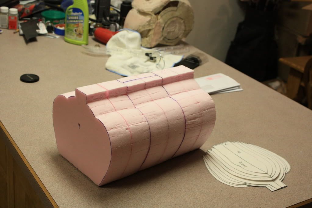

                    well! i don't know why i put this project off for 5 years. sheesh! in 2 days i have the hull roughed in. tomorrow i will finish the tip of the bow and the stern, then start sanding the rest of the hull and making the plug half way presentable.
                    are there frame lines for the late war IXC/IXD2 conning towers? if not, no biggie. i can do it with spare ABS i have here.
