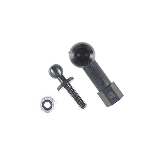

            How about attaching the frogman with a ball link in the palm of the hands to the steering handles.
            Or a carburator ball link and put it on like a bracelet.
            Scott
              Re: R/C scuba tow!! Yea Baby!!
              Thanks Scott,
              Good idea.
              I was thinking along those lines too.
              I dont want to modify the hands in any way as the frogman is a collectable but I think I can make up something that will attach to the hand that can hold either the ball or the socket. BD.

                            Well I finally got some time to finish up the mounting of the tow to the frogman.
                            I made some adapters out of ball links, washers, rubber grommets, brass tube, threaded brass rod, and stainless hardware.
                            I think they should work well.
                            The only problem is while drilling out one of the links I lost one of my balls!!
                            It went flying across the Dockyard!!
                            I have yet to find it. I may need a trip to the LHS.
                            The tow and frogman should fit in my larger test tank so I can adjust the frogman trim and see how the tow swivels.
                            My plan is to have it ready for the next fun run this weekend. BD.
