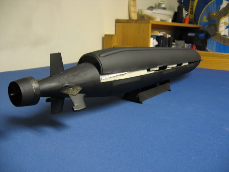

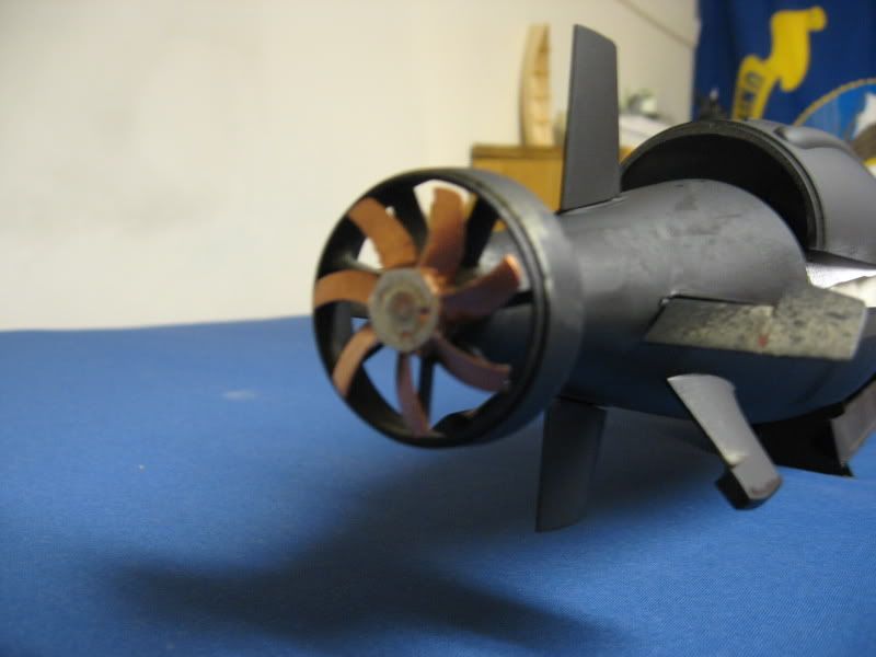

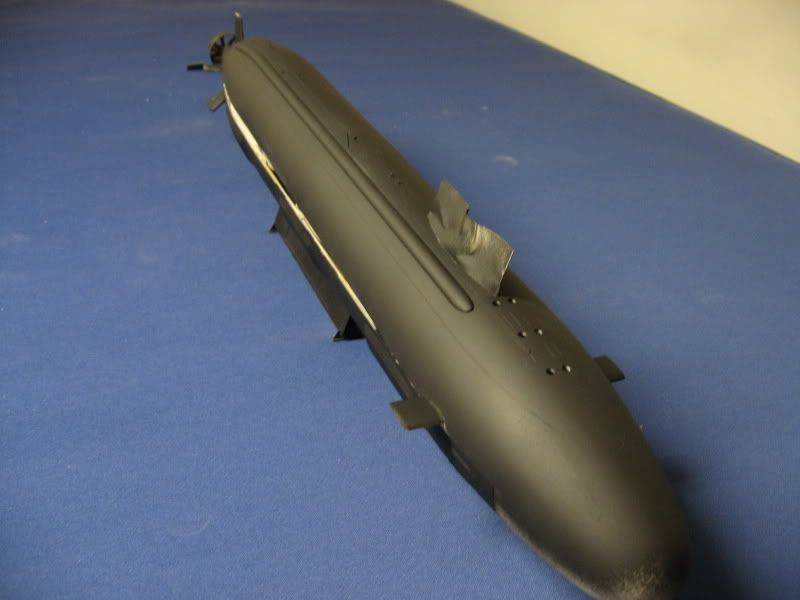

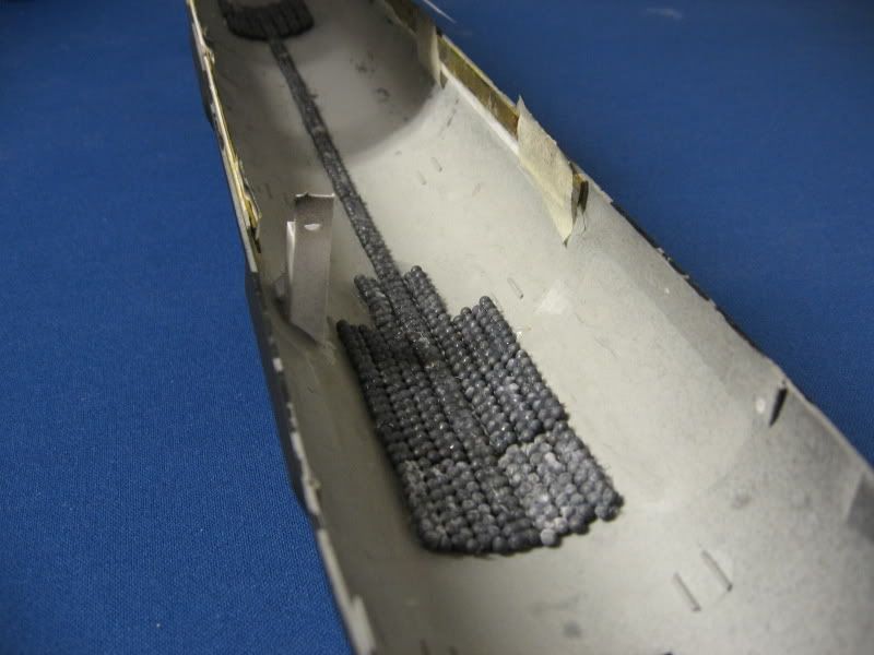

            Just a little update from today. I started painting the hull halves flat black, but ran out just as I was starting on getting some of the smaller sections. Do'h! Oh well, off to the hobby store tomorrow.
            Here is how she is turning out:
            In the last picture, you can see the ballast weights I've started installing. They are comprised of 2x8 interlocking "bricks" of lead shot that I hand make. These are then siliconed into the bottom of the hull. Seems to be working so far, just kinda a pain to make.
            I still haven't decided on a paint scheme. so I'm still looking for ideas.
              • 854
              Except for touch-up and maybe
              Except for touch-up and maybe sea growth type weathering, you're ther! The 1:1 scale ones are all black.
