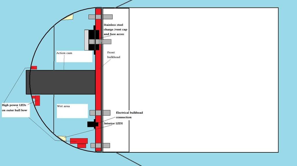

          Action cam installation,is a stand
          Action cam installation,is a stand alone color 1gig watertight cam to 10 ft unit.
          The rubber protected nose and lenz just protrudes out of the bow and held in place by the hole in the bow with a snug fit.Easy to remove for down load ,no tools.

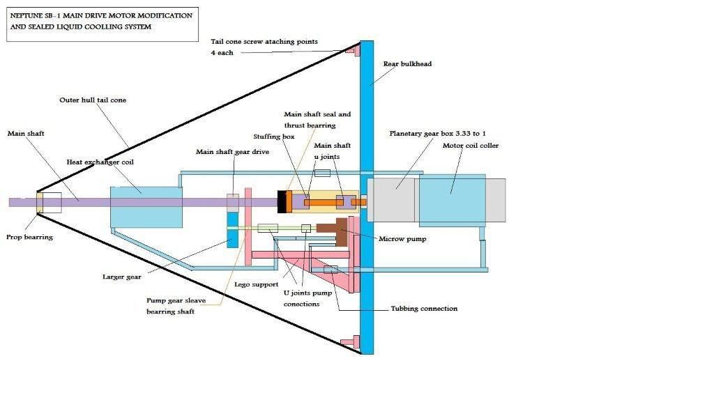

                    The one thing I did not like about the desighne of the drive is that there is no stuffing box Why they did that I dont know,the single lip seal unsuported by a bearring is not good or standard practice ,especialy since there is a dogbone u jount on the other side,with torque and speed it will destort the seal and a leak will ocure.Grease and oillite bearrings are instaled with a turned down brass adapter to take the place of the seal and hold the stuffing box.
                    The diagram is similar to what I did.
                    I noticed a few drops the last time I ran and it came from the seal main shaft,so I made it better.Also the water detection failsafe works very well and will shut the hole sub down till opened and dried out,just a tablespoon trigered it! But I will reposition the sensor so that it takes a bit more to activate. Will post pictures soon.

                        Internal and external switched high
                        Internal and external switched high intensity LEDs are next for night runs and in the caves and the huge 5ft cat fish will get curiose as they cruise along side.

                            The led array of some 26 high intensity leds is powered from the main battery switched by the 5th ch and servo and microw switch and several resistors making up the waterproof circuit and water tight connectors.
                            Just tested in the pool and the hole pool lites up and like when the Titanic was found wow, what sight!
                            Run time is not greatly affected since at night or in a cave higher speeds are not recomended.
