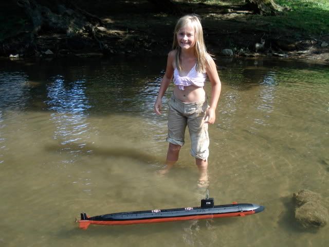

10. so today is saturday, and its time to get her wet in my friends pool.
11. the LA did well on her first runs. i did have to spend quite a bit of time finding and fixing a tiny leak in the wtc...but i think ive got it mostly under control now. overall im happy with the results, but the la has one hell of a huge surface turning radius! other than that, no complaints.
if you pay close attention youll notice the water line as painted is not correct. when i trimmed the boat, i did so more according to the real thing. im going to run this one as is for now, and later in the fall or winter will sit down and give her a fresh paint job and a little more detail. but thats a job for another day...
