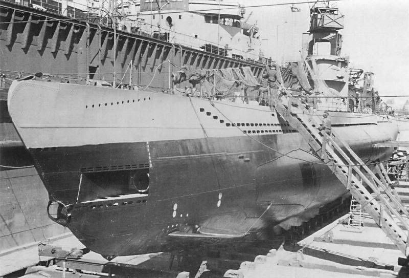

    Need more clarification on something.
    Just what is that long narrow gap that exists just above the saddle tanks on pictures of U-995 as well as other type VIIcs and VIIc/41s ? Is this a loooooong flood hole ? Does this same gap exist on all VIIc/41s ? Does this gap serve any other purpose than to flood the outer hull, maybe it was needed to flood the main internal ballast tank located under the control area of the sub ? I do not know, and am asking.
    I do not know what boat exactly this picture is of, or when the photo was taken, but that long gap is seen just above the saddle tank in the area of the conning tower.
    I'm at the point of wondering whether I need to cut this gap out of my type VIIc/41.....still not totally sure.
    Thanks for any feedback.
    Mylo

    That is indeed a free flood area. The ballast tank valves are located along the top of the saddle tanks and inboard of that long slot area. That 'gap' exists on all Type VII's.....at least I've never seen one without one.

      Jeff,
      That answers my question.
      Jeff,
      That answers my question. I've got some cutting to do.
      Was it all one big slot, or were there little braces in there for support every so often ?
      Mylo
        Hi Mylo,
        Yes...on both counts.
        The hull
        Hi Mylo,
        The hull 'skin' is cut as one long slot. Visible behind it are the individual frames.
        When building my Type VII's, I've always cut the long slot into the hull and then epoxied brass wire on the inner surface of the hull, along the slot, to both represent the frames and to provide the means to hold that now long thin piece of fiberglass in place. (my preference in building these boats is to avoid all internal full frames)

                    So, is what we are
                    So, is what we are saying is that there is a support at each location where there is a rivet line along the entire length of that long opening ? This makes sense to me as the same framing for the outer hull rivets would continue up the hull and be exposed at this opening.....if I understand correctly.
                    Mylo
                      Hi Mylo,
                      Correct, the frames are
                      Hi Mylo,
                      Correct, the frames are visible in/along that long slot.
