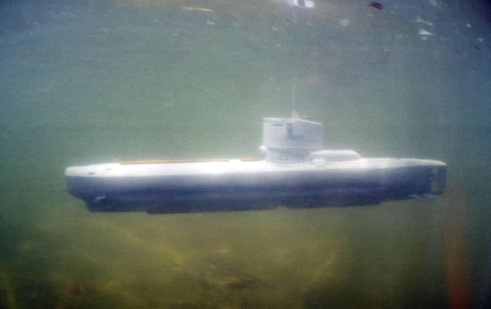

        Jeff - I use a
        Jeff - I use a D&E 3.0 in my 32nd P Type XXIII. Fits like a glove - works like a charm.

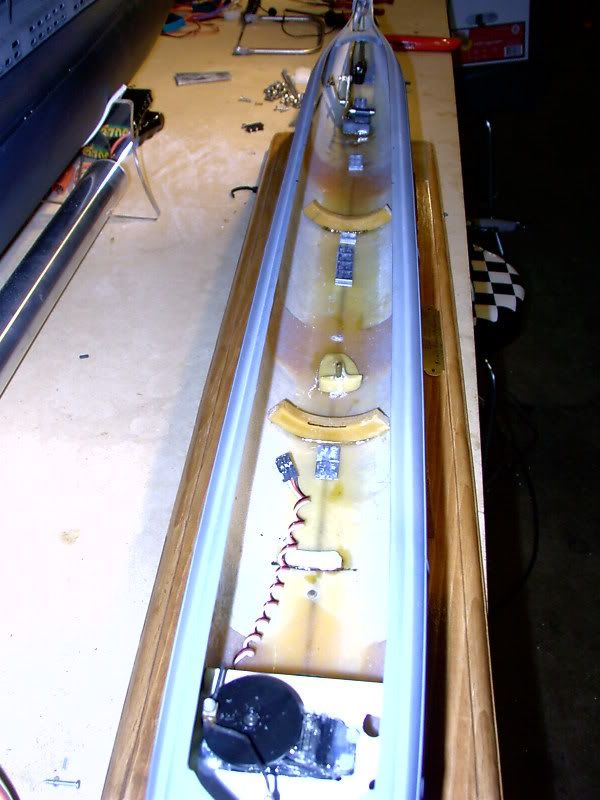

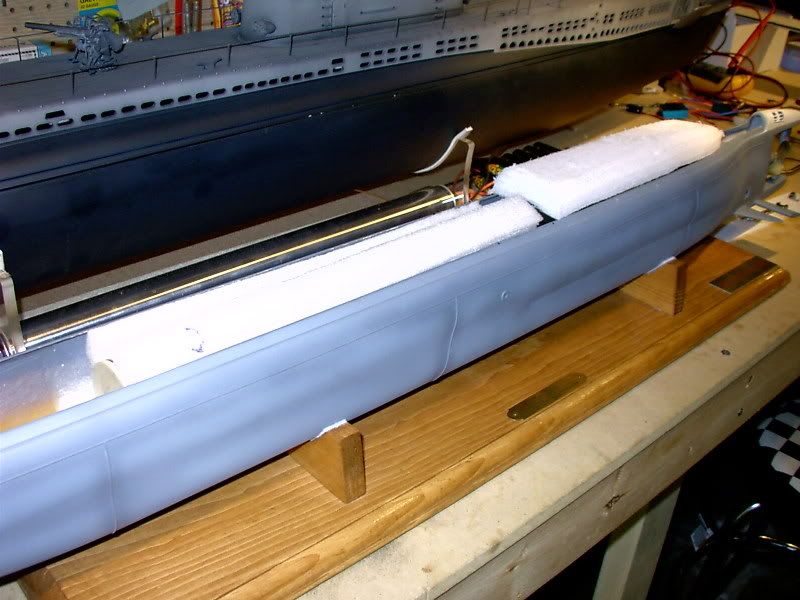

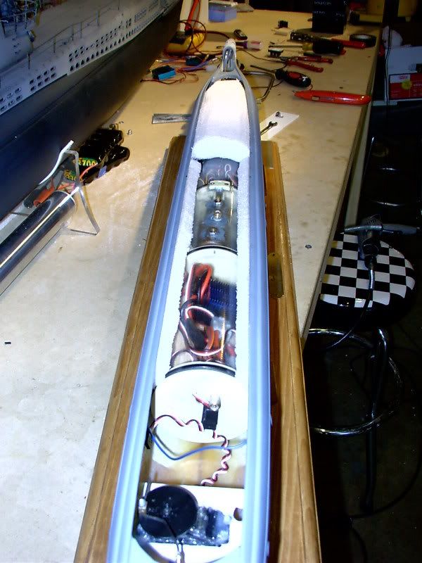

              http://i114.photobucket.com/albums/n253/spongjim/subs/projects034.jpg
              http://i114.photobucket.com/albums/n253/spongjim/subs/projects035.jpg
              Jeff ,I put a
              Jeff ,I put a servo in the nose of the XXIII in the wet section and waterproofed it.I run the wire through the end cap of the wtc and it works perfect for me .I have sealed several servos this way and only had one go bad . Its easy to do and saves space in the wtc also alot easier to adjust if needed.
              Oh yea I am going out right now to try the SWM wtc in the XXIII hull. I will keep you posted.

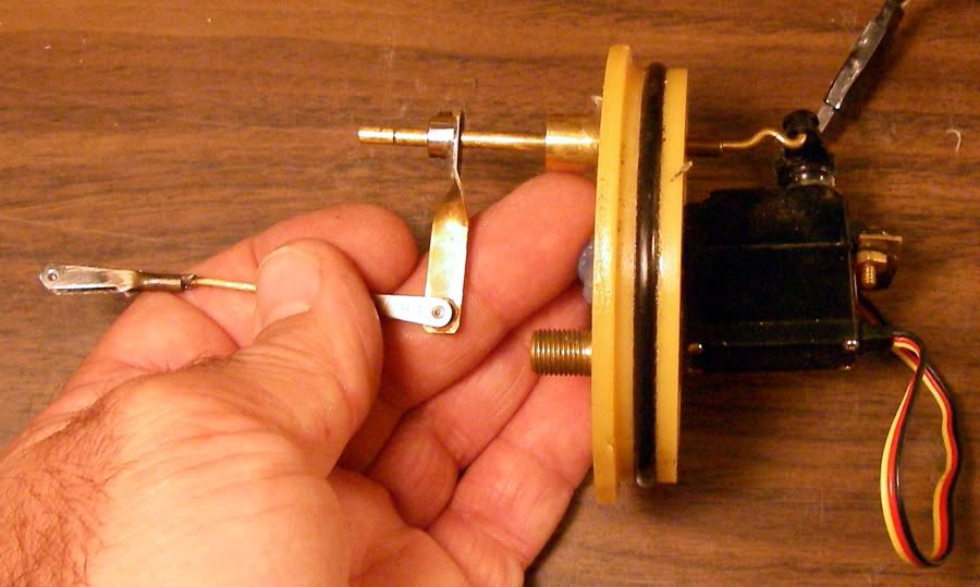

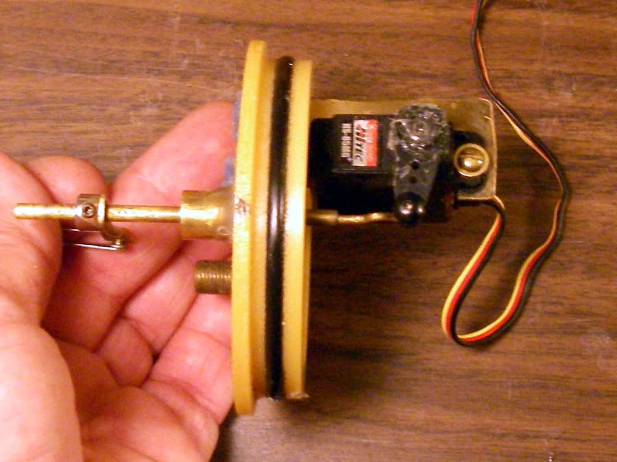

                      I mounted
                      Hi Jeff -
                      I mounted a mini servo on the forward endcap with a piece of brass bent into a mounting bracket. As Jeff L mentioned, you need to add a through-hull shaft seal for the push rod.
                      I control depth with the bow planes. The stern planes are just run by the APC leveller. Best working sub I have!

                        Thanks alot Tim and Jim for the detailed photos, I think I have enough spare parts for a complete sub minus the WTC itself. With all this info on this boat you guys provided, you may bring this kit back into production... lol . Will keep you posted on my progress. Jeff Jones
