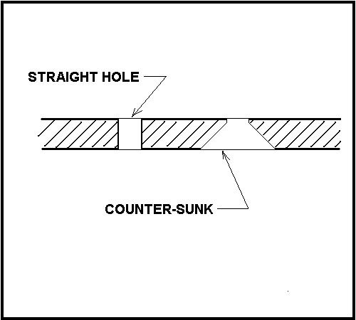

      Did you counter-sink the
      Dave,
      Did you counter-sink the holes from behind, or leave them at 1/8 all the way through? I enlarged those deck-edge holes from the rear, leaving only a very thin little bit at the original size. It made a big difference. The air just can't squeeze through a small hole in material as thick as that. I used a pin vise to hold my drill bit and did it by hand. A power tool would have made the larger bit grab the plastic and blast all the way through.
      I also have some 1/2 inch holes under the conning tower.
