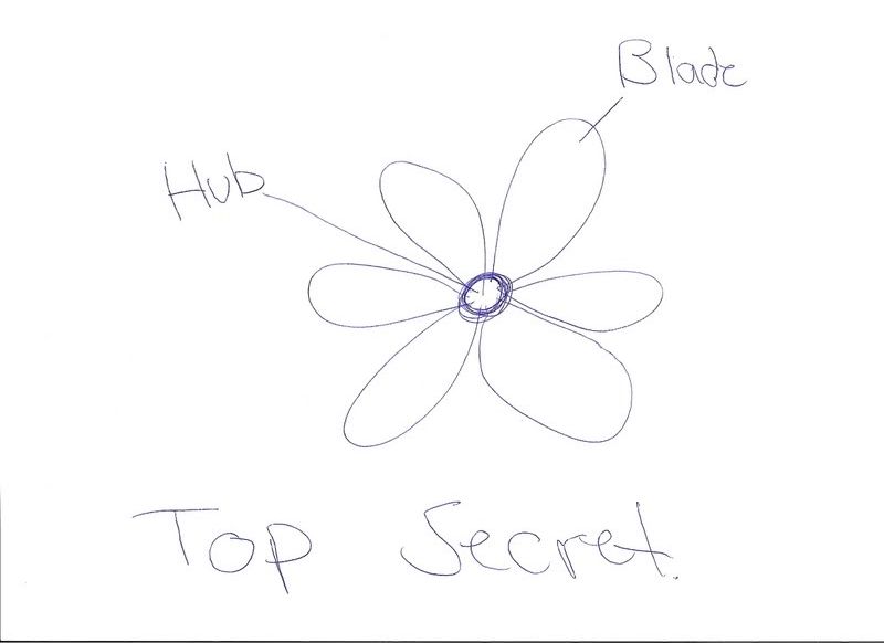

      I just got a report from one of our over seas operatives. They were able to smuggle the plan set for the top secret prop for the "wheelersub". As I speak, we are receiving the uplink data transfer for the schematic via quadruple encription. I hope this information was worth it, it cost us a good man in the field.
      .....stand by.........
      .....DATA upload COMPLETE !
      We have it gentlemen, we have the prop design for the wheelersub in our hands. Submarine technology and advancement is about to take a huge leap forward.
      BEHOLD ........... The WHEELERSUB PROP DESIGN.
      wheelerdealer ........couldn't resist. All in the name of ....getting a laugh at someone's expense when they were only trying to be helpful

        Ahh ...close but no cigar.
        Ahh ...close but no cigar. the prop design of the Wheelersub© is a closely gaurded design and will never be represented in drawings. Furthermore, to avoid copies of the revolutionary Wheelersub© turning up in 1/25 scale, all public plans will have the proportions randomly altered and shown rendered using Freeware and not AutoCad.
          I tell you what, you'll
          I tell you what, you'll have a heck of a time trying to get that prop balanced!

            wheeler figured it out......THAT is
            wheeler figured it out......THAT is why this prop is so special.
            At first glance, it may 'appear' unbalanced, but using the coificient of the negative inverse drag factor, combined with the thrust geometry of -.233405 coupled with the hydrodynasymbiology quotient, which according to the wheeler design, is 3453/12.34, we see that, in fact, the wheelerprop is a marvel of modern engineering as it's final result = 0 ....a PERFECT balance. Wheeler clearly is a hydromechanical genius.
            ....this prop is going to revolutionize underwater propulsion as we know it.

              According to the drawing, the
              According to the drawing, the prop appears to bend light, thus rendering it invisible.
              LOL
