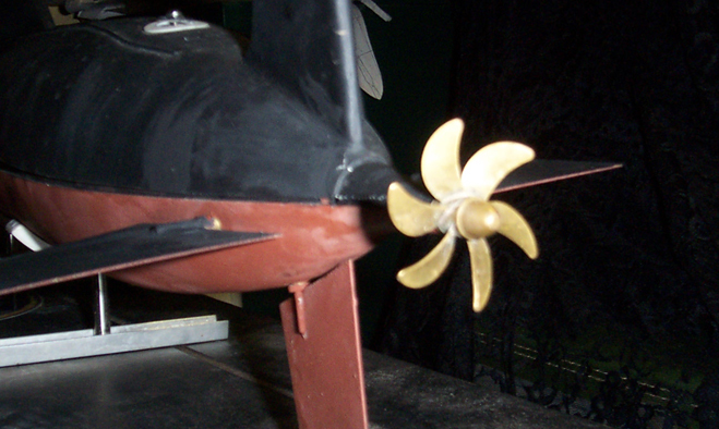

    Well after the last run I had it is very obvious that I need a better prop. Anyone have an idea what size and type works best for this model. I know a few of you out there have done this kit aswell.

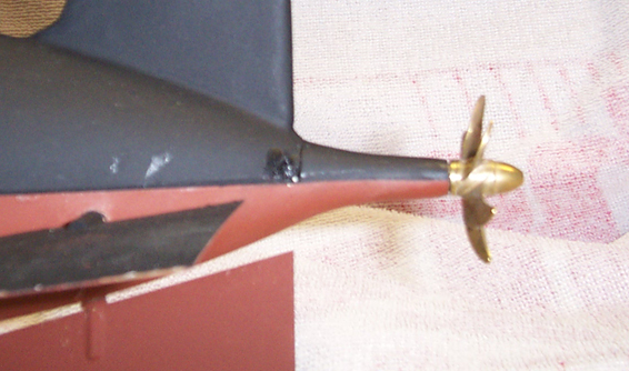

    Also anyone know a good way to fill in the cracks for flush mounting? I have tried this creen modelers putty but once it dres water makes it dissolve and crack. The real problem is that its a plastic hull.

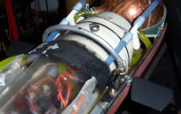

    I also want to activate the front planes because right now the thing looks pretty bad porpusing and trying to go under. Very unrealistic (i know its pool toy). Anyone have some tips for hooking up the planes? I was thinking a seperate wtc up forward with a micro servo?

    I did all my filling and filleting with Squadron White Putty. I know there is probably better stuff out there, but it adhered well, dried rock hard, and has held up fine to water. Only drawback is a tendancy for hairline cracks in areas where the hull may flex some. I just rout out the cracks and fill them back in with more.
    I run a 6 blade 40mm Raboesch brass prop I got cheap from Engel. The Akula hauls butt with it. It's just about scale for the boat and looks pretty good, especially if you extend the tail back a bit.
    Your task with the bowplanes will be easier if you mount them at centerline (as I believe the real thing has them) and fasten them to the lower hull half. If your innards are in the way, use an arched coupler to hook them together. Here is how I did mine on my admittedly highly modified Akula.

      I have been using squaron
      I have been using squaron green putty on mine and the cracks are kinda what im trying to get rid of..

          Just ordered the prop aswell. Not sure if i got a good deal though i just paid 40 including shipping. Started refilling the seems today aswell and I primered it to try and use ultimate bondo putty to fill the holes. Do you know where i can get some styrene board to make a level deck as you did aswell? what did you use to make the safety rails?

            If I recall, we got several of the props from Engel for around $12.50 apiece, including the overseas shipping. Of course, that was back in 2002. They did arrive in a matter of days, which seems typical of Engel.
