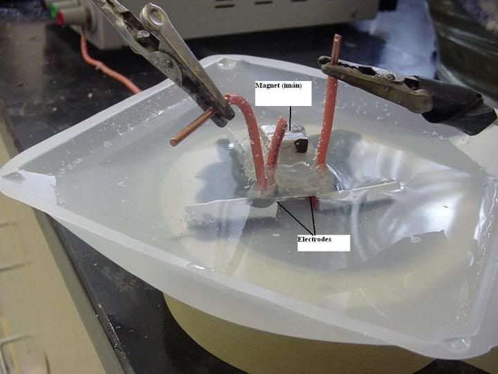

                      Well I finally find some
                      Well I finally find some time to experiment with this idea. I made a very rude device consisting in two copper electrodes (~1cm2) and two rare earth magnets. I used a sodium bromide solution (I had no sodium chloride at the lab!!) as the electrolyte and a variable power supply (DC). The good thing about the sodium bromide was that it produced bromine which is soluble in water (this is better IMHO than releasing chorine gas from a sodium chloride solution!). The water turned a blueish-green color due to the bromine and the dissolution of the dissolution of the copper anode.
                      And...It worked!!
                      Diagram]http://img.photobucket.com/albums/v393/Gerwalker/MagnetoH/magnetoschem.jpg[/img]
                      Video (sorry for the bad quality of the images but I think it shows the water flowing)]http://www.cashmoneyuploads.com/view/v7171/[/url]
                      14V (aprox) reverse direction]http://www.cashmoneyuploads.com/view/v7172/[/url]
                      Full power reverse]http://www.cashmoneyuploads.com/view/v7174/[/url]
