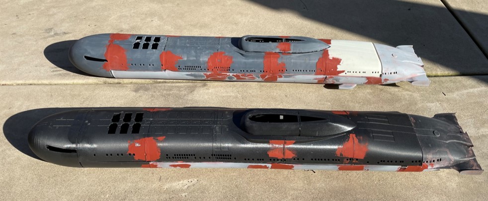

    I have completed printing out the hulls and put them together. Still alot of work to do on sanding and fitment but overall moving along. Resin is more brittle but easier to sand and FDM fit better but more work to smooth.

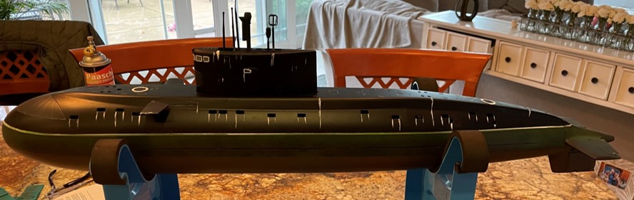

      Well I took a little break from sanding to almost complete my first RC sub.* Its a Kilo from Bob with all the bells and whistles.* Running gear is in and working just waiting on a package getting here on Friday to connect the prop shaft.

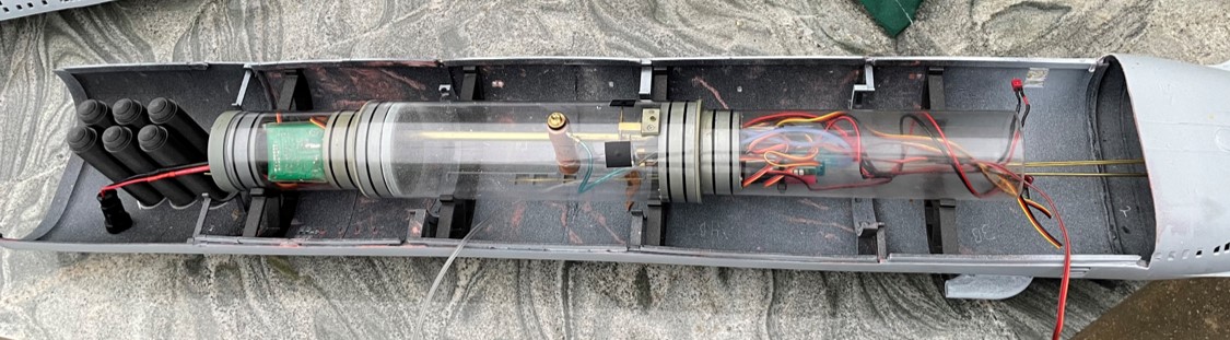

              Got some more work done on the FDM hull and printed some custom bulkheads for the 2.5/3/MSD from Bob. Now to determine the size of the ballast tank since the missiles have to go in the front section of the lower hull. Thoughts?

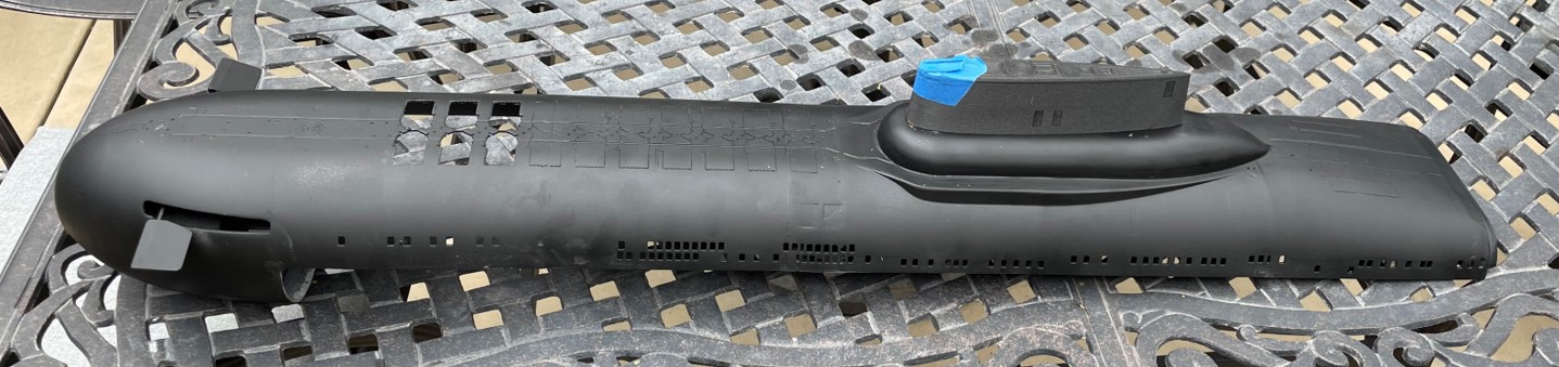

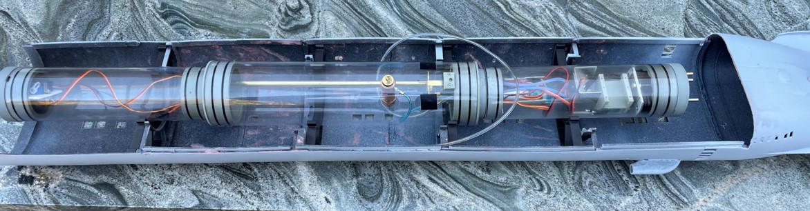

                Got some more work done on the FDM hull.* The MSD is just about the right size.* I thought I was going to have tons of room in this cylinder but the missiles cut that prospect short!* The battery will be in the bow and two servos will also be run wet in the bow.* The FDM hull is proving easier to work on and less brittle. For scale the ballast tank is 10inches long.

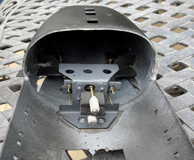

                  Got another chunk of work done on the FDM hull.* The upper is almost complete with the retract mechanism custom made in Bob's design.* I also got the connection complete around the missile tubes and the drive train is almost complete.
Name:	upper progess small.jpg
                  The upper retract mechanism also works!
