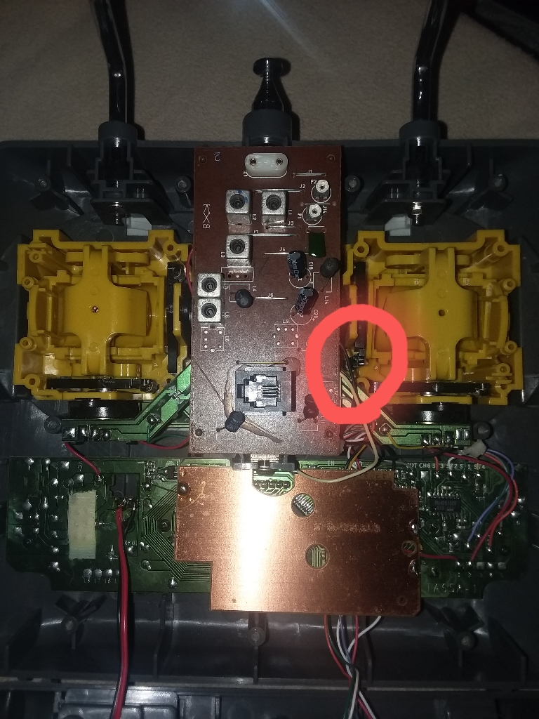

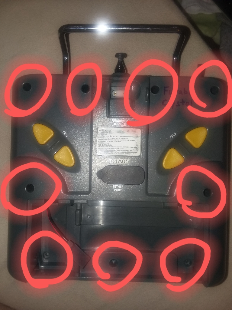

    Remove crystal,
    Battery cover,
    Remove 9 screws at the back.

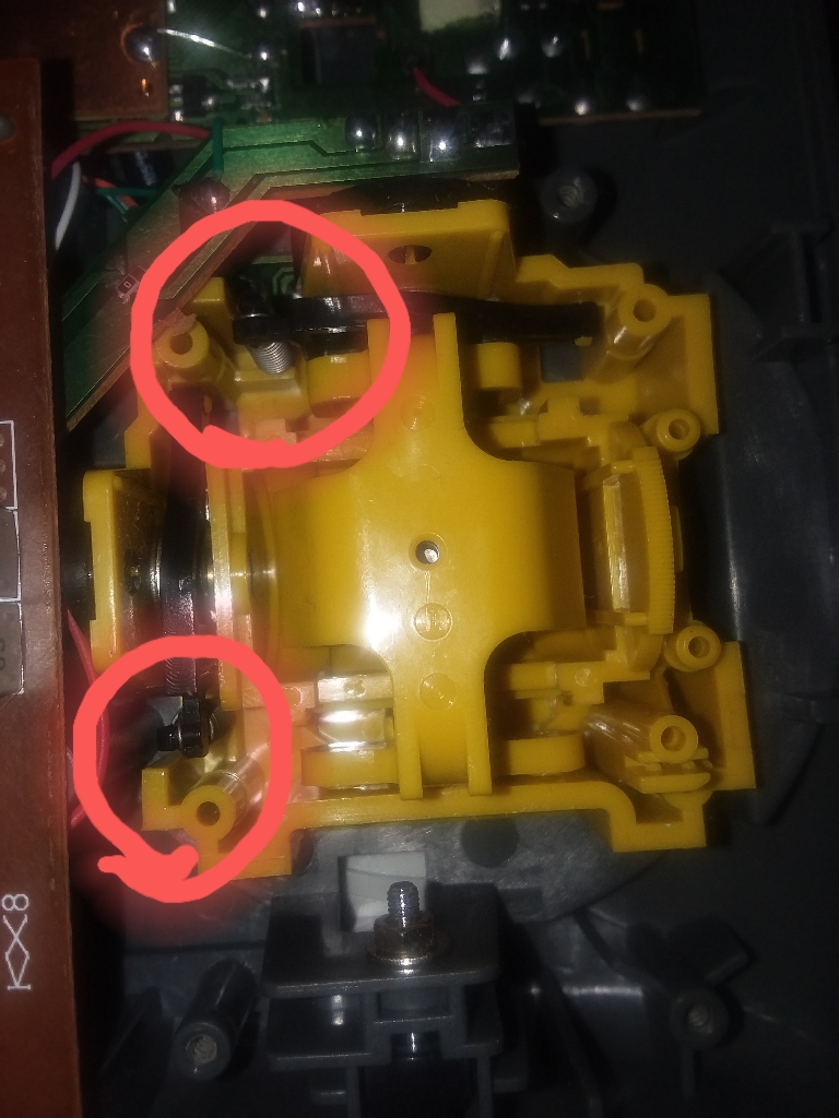

    Remove the spring you want. Click image for larger version

    • secrtwpn1
      • 269
      Thank you. That makes it clear
