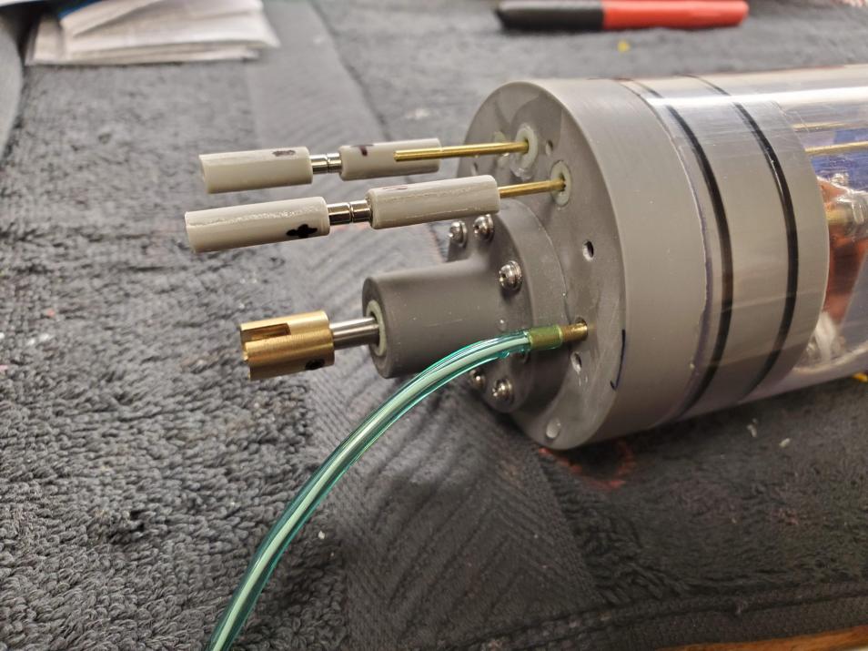

      I typically run them outside. This allows for full-length extension and maximum separation from any noisy electronics inside the cylinder. If you put it in a small diameter rubber tube, this also gives you a method to test the cylinder for leaks. You unplug the end, submerge your cylinder and blow into the tube. You can easily spot any leaks that are there, and precisely where they are.

        Bob,
        My builds all have a Schreader Valve on the front end cap.
        I have a hose with the threaded fitting on it to do exactly what you are doing.
        The Schreader has no inside parts.
        I also make a brass rod hook that I can reach through the Schreader to reach the on/off switch.
        The Schreader most importantly lets me take the valve cap off for transportation up and down the 5000' I have to travel to the lake.
        Forgot once and the end cap popped off and scared me while driving up the hill.

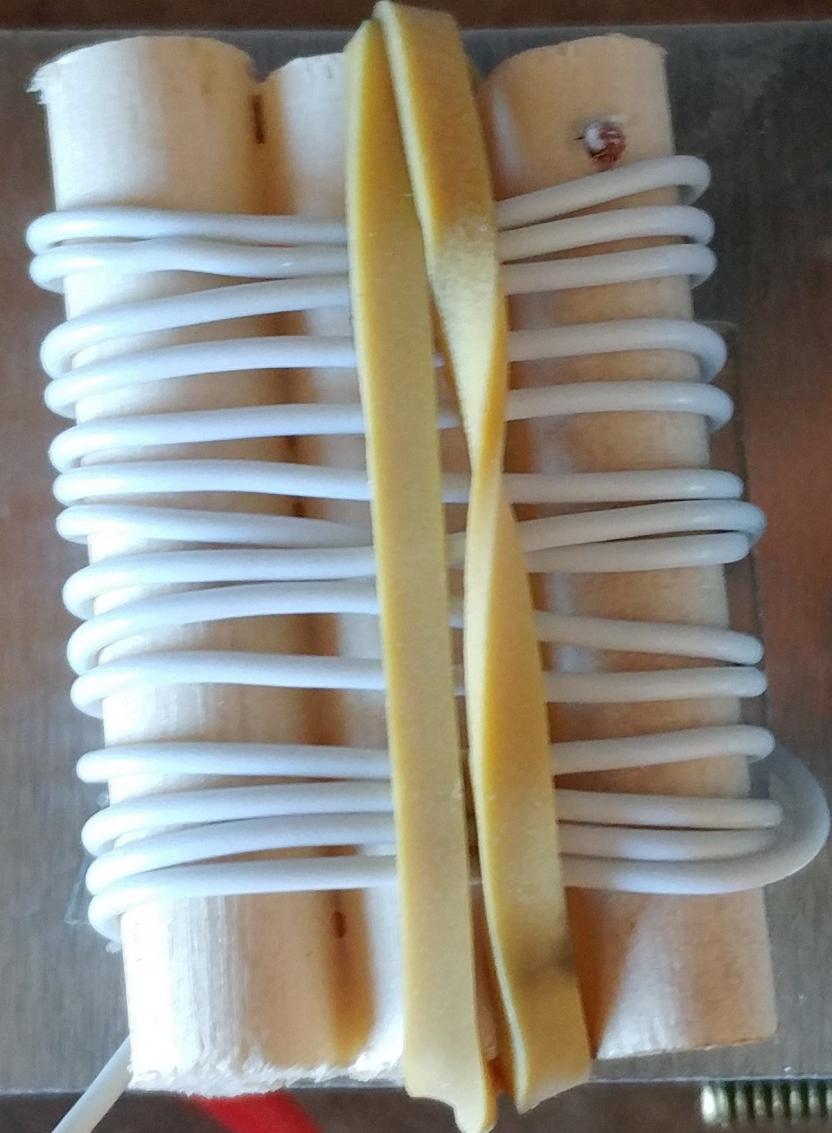

          So I glued together 3 pieces of dowel and wrapped the antenna around it........Could not attach the picture......
ID:	134052Figured it out...................

              I am not sure how it applies to our frequency, but in networking, wood (including books) can absorb or severely impact radio signals. Now to qualify that, it is in GHz range and not our MHz range. So, my point is I do not know how well the dowels ill or will not impact the frequency. However, in your testing, if range is poor, keep this as something to consider.
              Maybe on of our electronic experts can tell me I am full of stuff or corroborate what I am saying.

                    The wood dowels take up a lot of room in the cylinder.
                    I see three in your photo.
                    I also would consider the absorbtion of the sign by the wood.
                    My thought is this, I would try using 2 plastic ball point pen barrels.
                    They are easy to come by and sheap if you have to buy new.
                    The plastic pen barrels are lighter in weight than wood dowels.

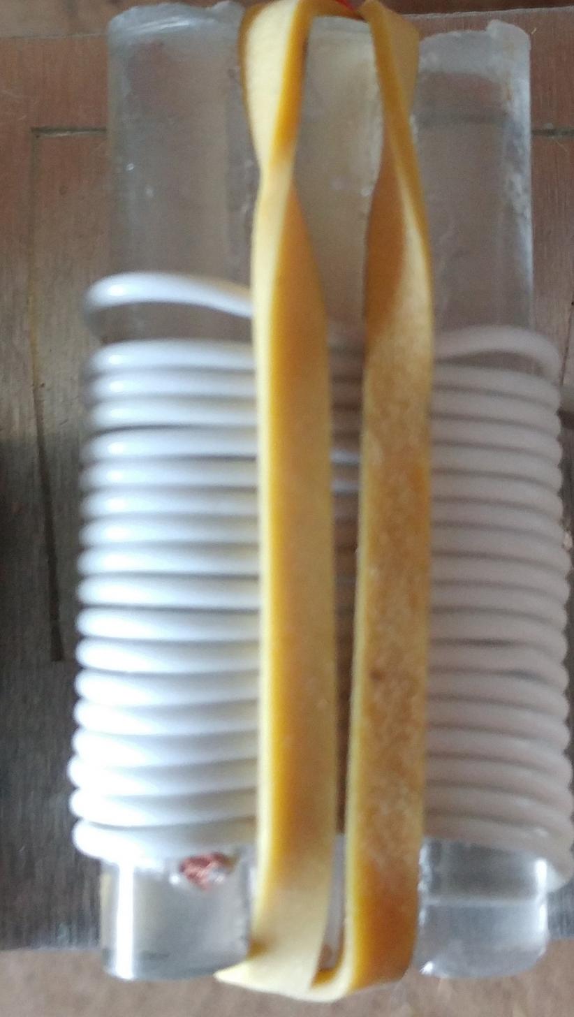

                        Same set up, but this time with clear acrylic rod I found in my workbench..................Click image for larger version
