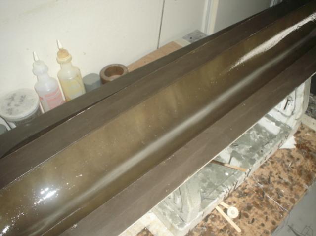

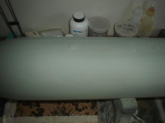

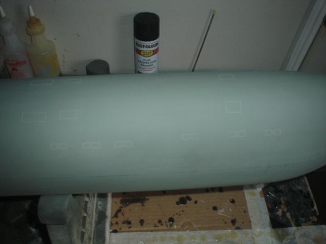

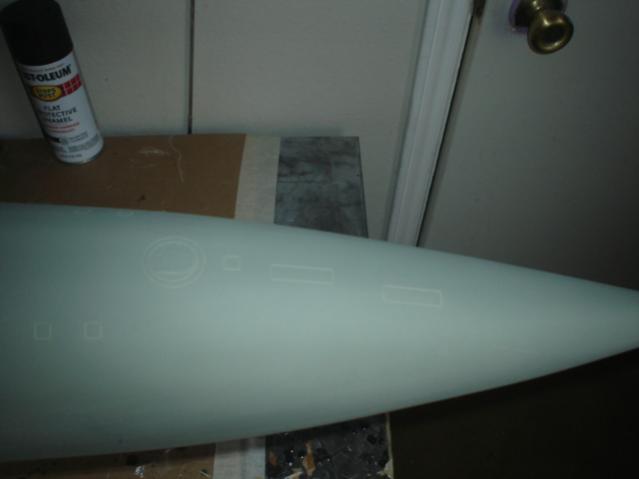

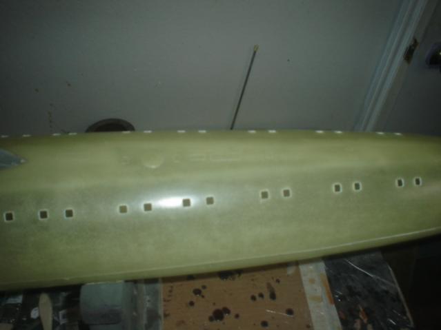

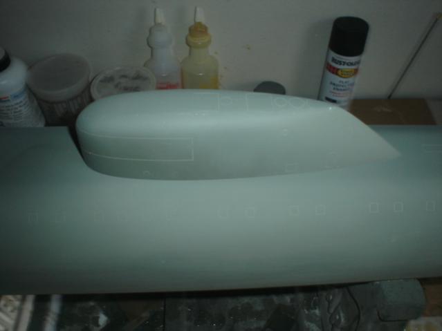

    Here is the last boat molds I am making. Getting out of sub molds. Getting too old plus I have too much else going on. Little over 5 years I made molds for a 1/72 Alfa, 1/72 Charlie I, 1/72 Charlie II, 1/72 Victor III, 1/72 Golf II, 1/96 Delta III, 1/96 Delta IV, 1/72 688. I am tired. Anyway Charlie II is 57" long with a 5 1/2" beam. Tons of detail scribed into hull and sail plugs. My boats are labor intensive. Mix West epoxy and fiberglass powder and put 2 coats in hull and sail molds. Like a jell coat. Then I start laying up multiple layers of 4oz and 6oz cloth. Bullet proof surface on the hulls. Only going to make a handle of Charlie II kits. Already have a couple of pre sales. Keep your eyes peeled as I will be listing a 688 kit, a completed 688 and the 688 molds.

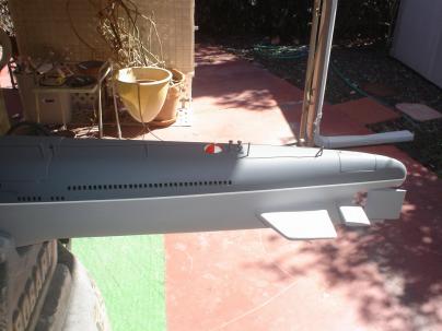

          Found some pics of the Golf II

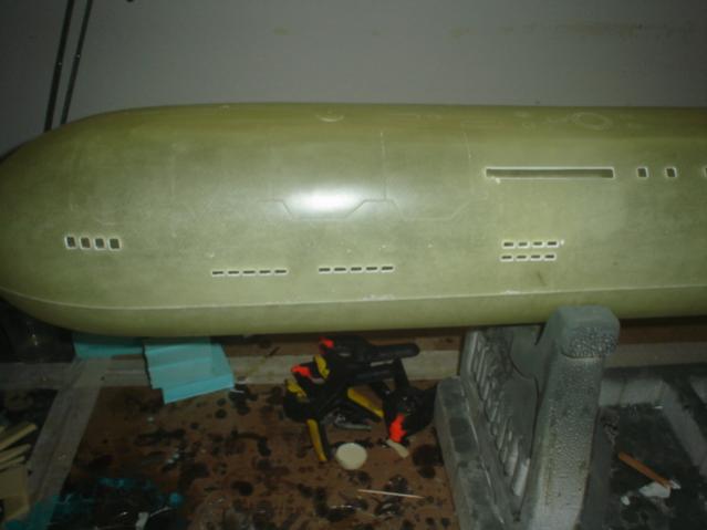

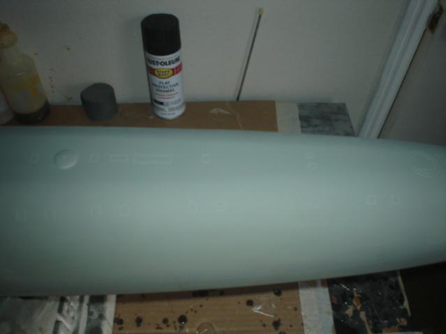

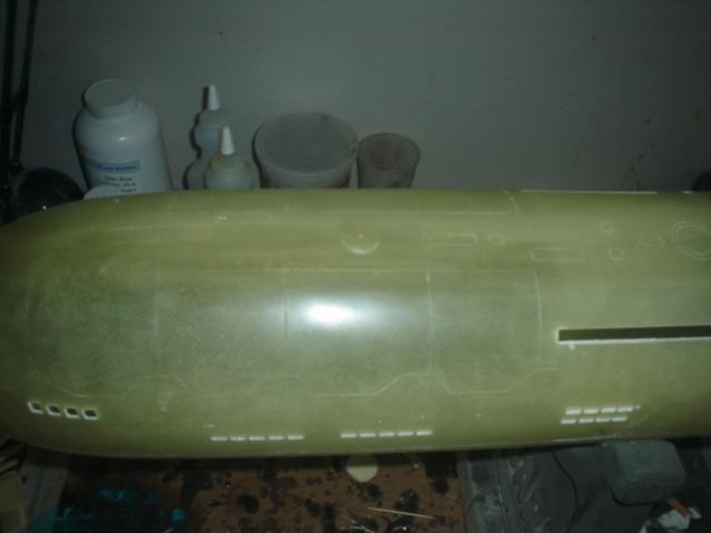

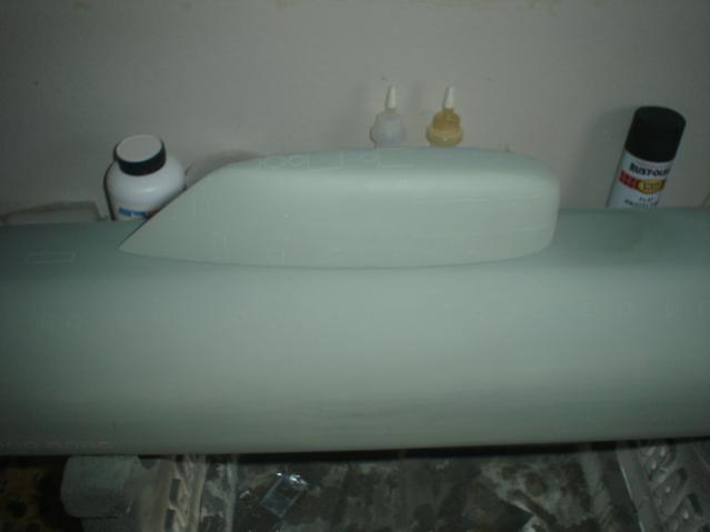

                  First Charlie II hull out of the molds. Don't have a sail made yet so I used the sail plug to show. Tons of detail. Old camera has a hard time showing details.
                    awesome looking model.
