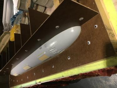

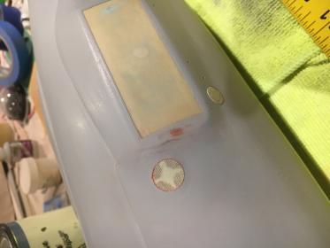

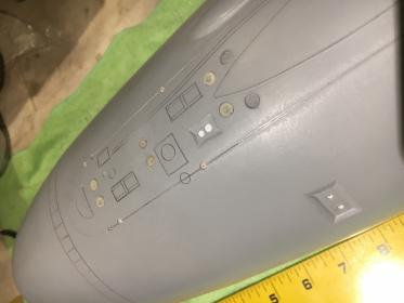

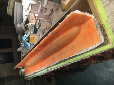

    SubmarineWorks Seawolf class retooled with full MIP coating details is almost ready.
    The master is complete and I’ve begun laying up the 4-part mold to cast hull kits available soon.

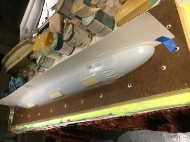

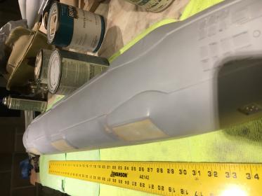

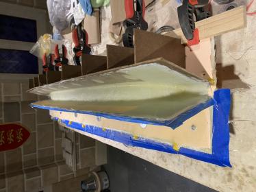

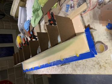

            Mold work continues on the Seawolf after a little redirection. Because of undercuts on both sides of the hull I’ve determined it will need a five piece mold with three sections on the top instead of 2. I’m glad I’ve taken the time between layups of the mold pieces or I was likely to have gone through a lot of time and money only to have the mold locked into the master.

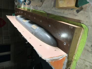

              Third piece and set up for fourth.

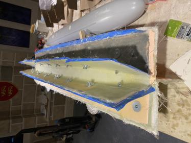

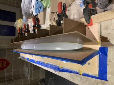

                Mold complete. Pulled from master successfully. Needs a little touch up and then it will be ready to start laying up hulls.
