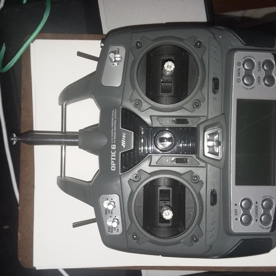

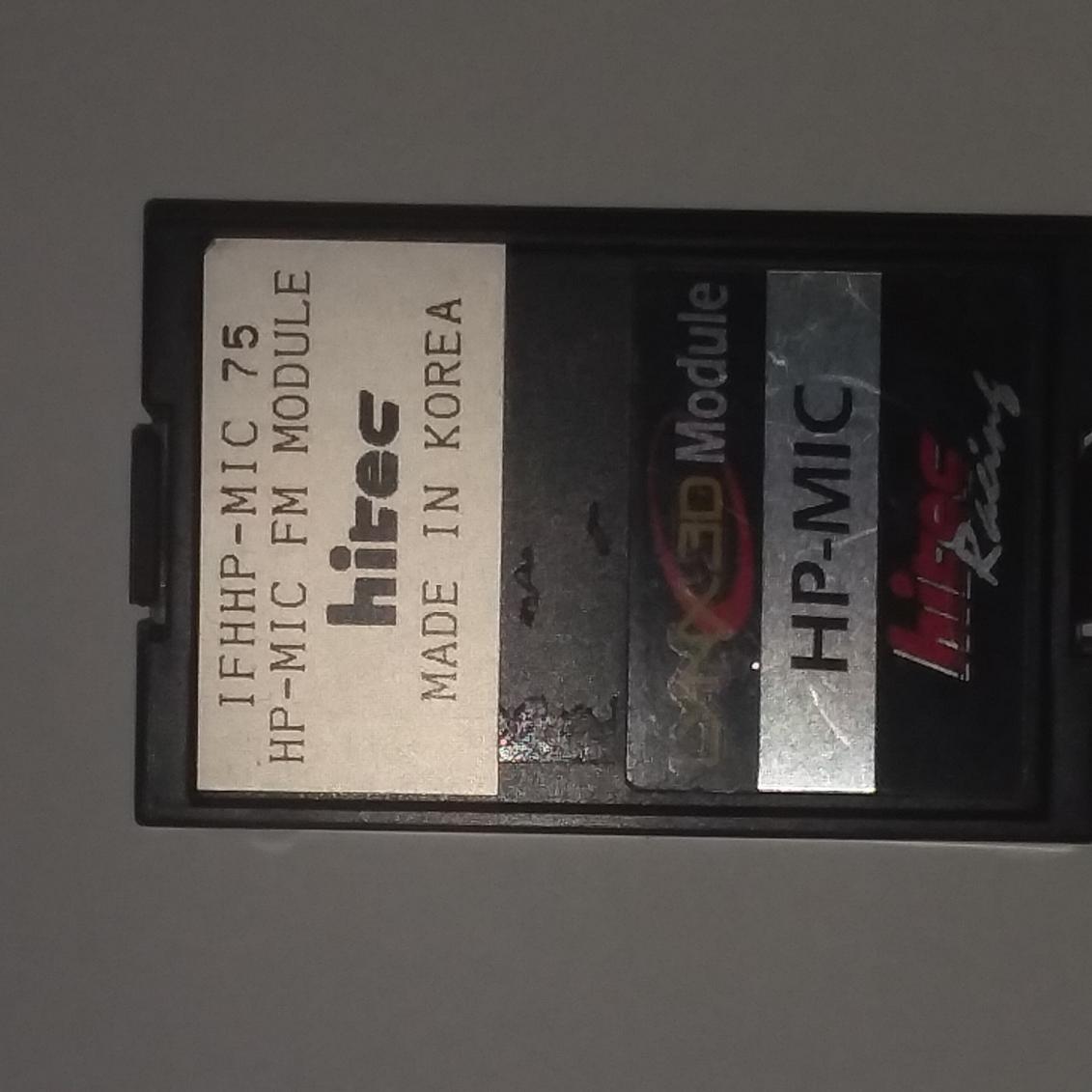

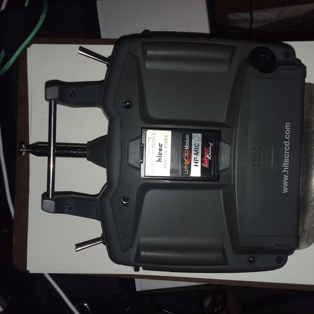

take/rip/remove out the RF module, FCC legal.
and jam this bad boy in to this. chuck the 72MHz module.
Hitec optic 6 (NOT SPORT models, NOT convered 2.4 GHz, no antenna!), dig one up at (what ever) your pick.
this transmitter good for Hitec, Futaba, (-)shift, AND JR, Airtronic (+)shift, that's all the receivers (433 MHz that's another story) . (don't look at me)
still FCC legal transmitter.
if you like your throttle auto center, no addition part to buy, just chuck the stopper and you are done.
