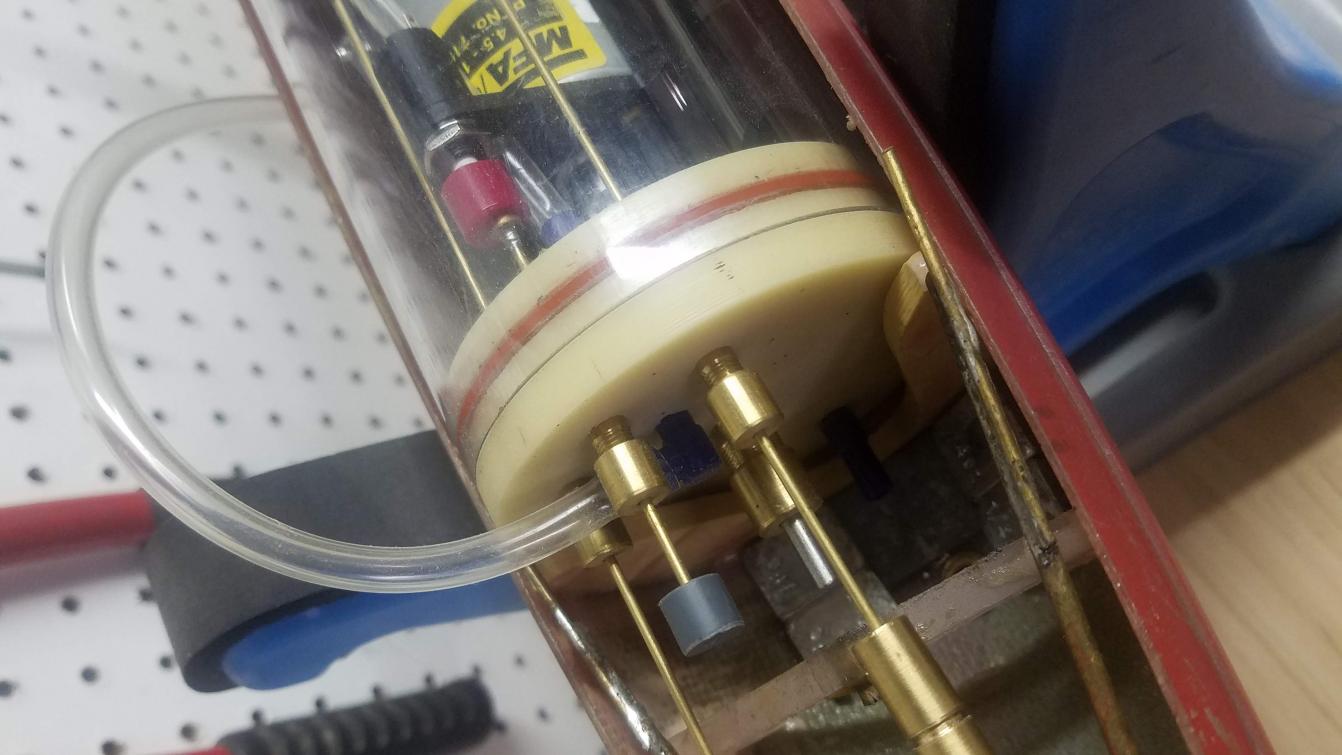

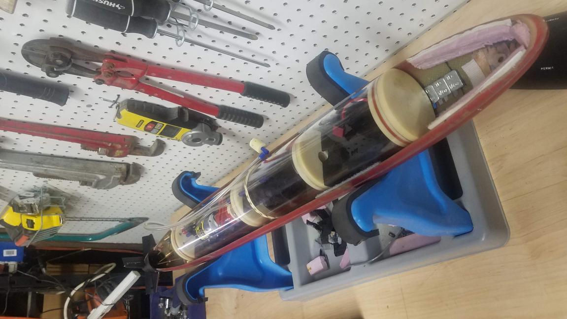

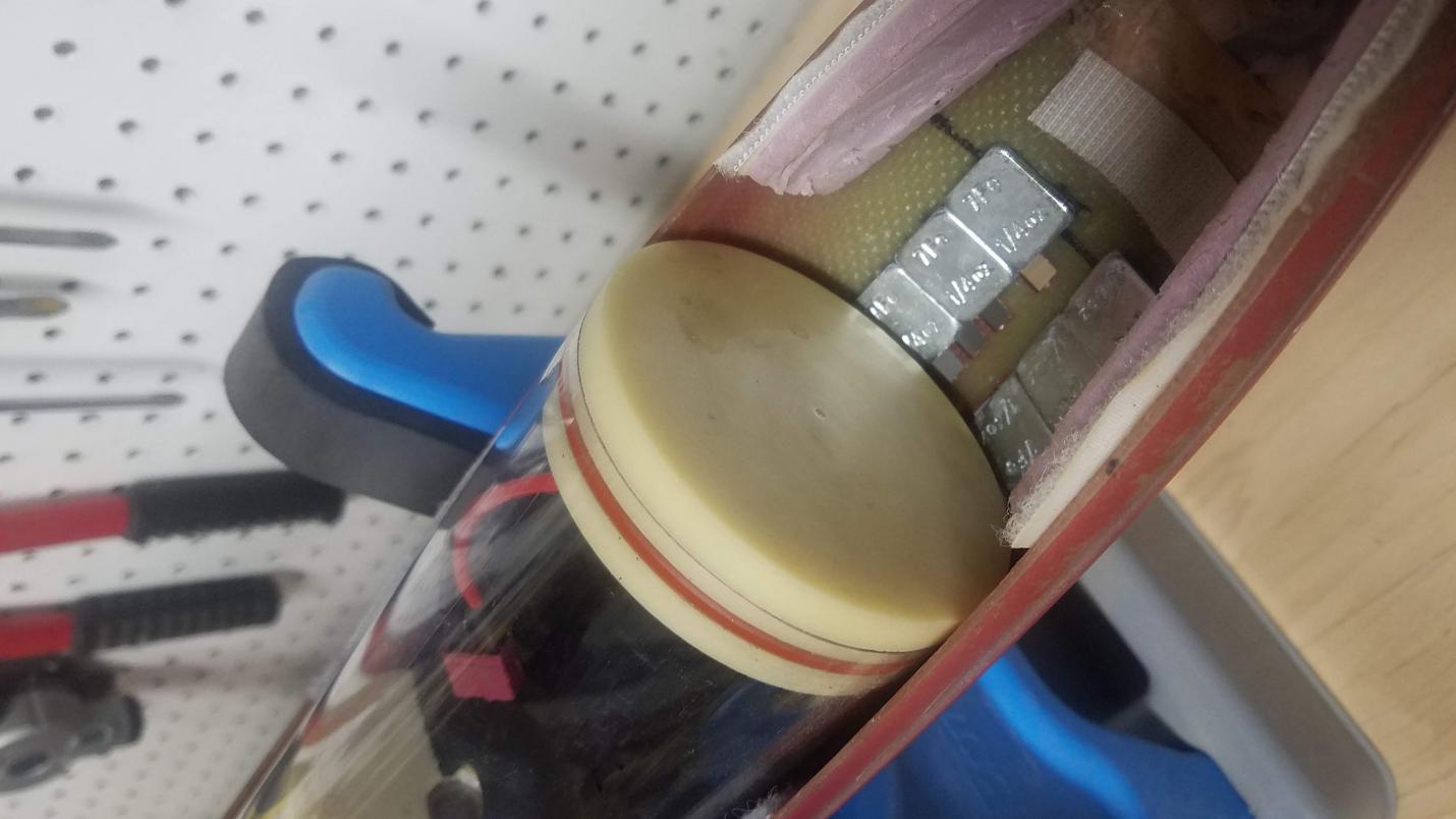

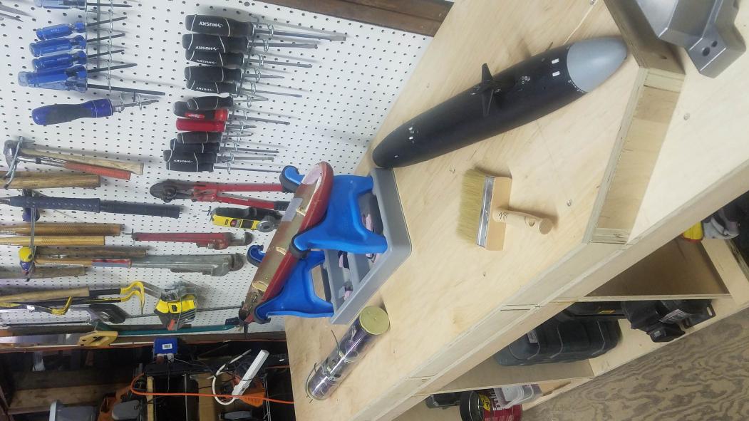

    1. How to index and secure the cylinder into the boat. The subdriver I had before used an index pin to locate the wtc, and then I used Velcro straps to hold it in place. The index pin is not an option for this WTC. I was thinking about epoxying a pin in the rear WTC cap, and modifying the bulkhead at the rear that they would index into. Then in the front drill a shallow hole into the foward cap, and install a bulkhead that I could slide a retaining pin through into the forward cap hole. However this WTC is a veryyy tight fit and I don't know if I have enough room to add a bulkhead. (I will also need to trim the existing saddles to an 80mm inner diamter to fit in).

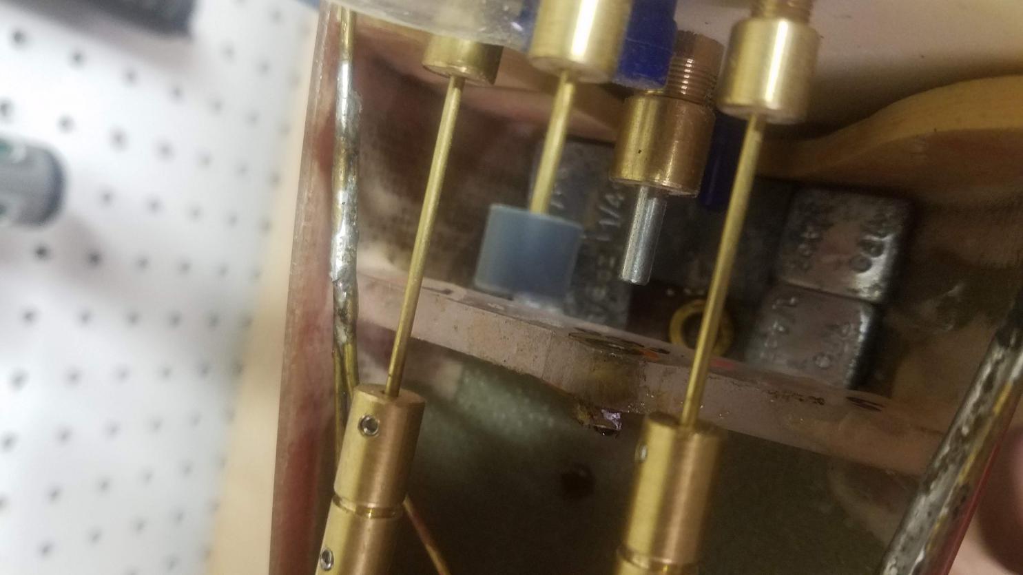

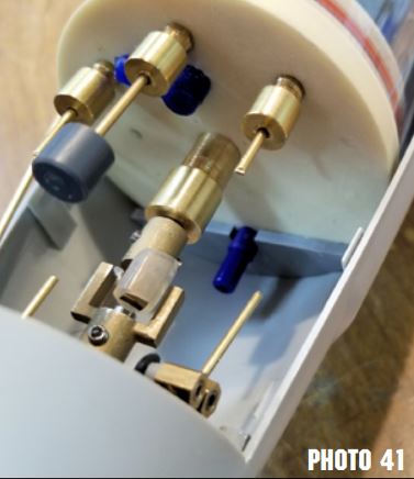

    2. The exit points for the servo pushrods are very high in the WTC and use 1/16" rods so I am concerned about both flexing as well as how to fit into such a small space.

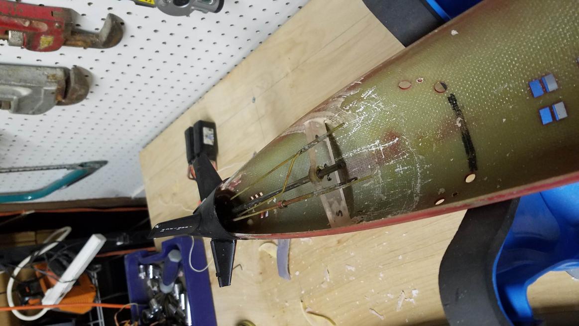

    3. The output shaft does not have an index to add a universal joint or dogbone set up, and also it is going to be very close to the existing rear bulkhead. So I need to figure out how to connect the output to the prop shaft.

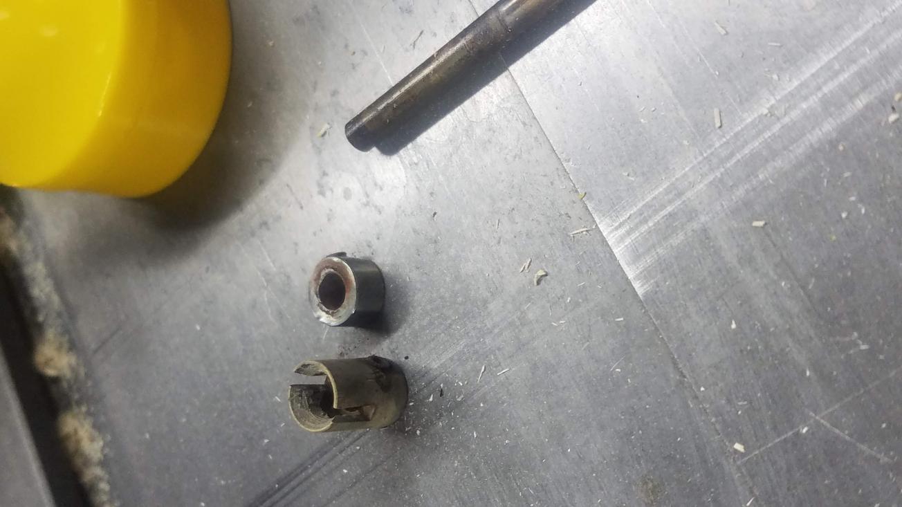

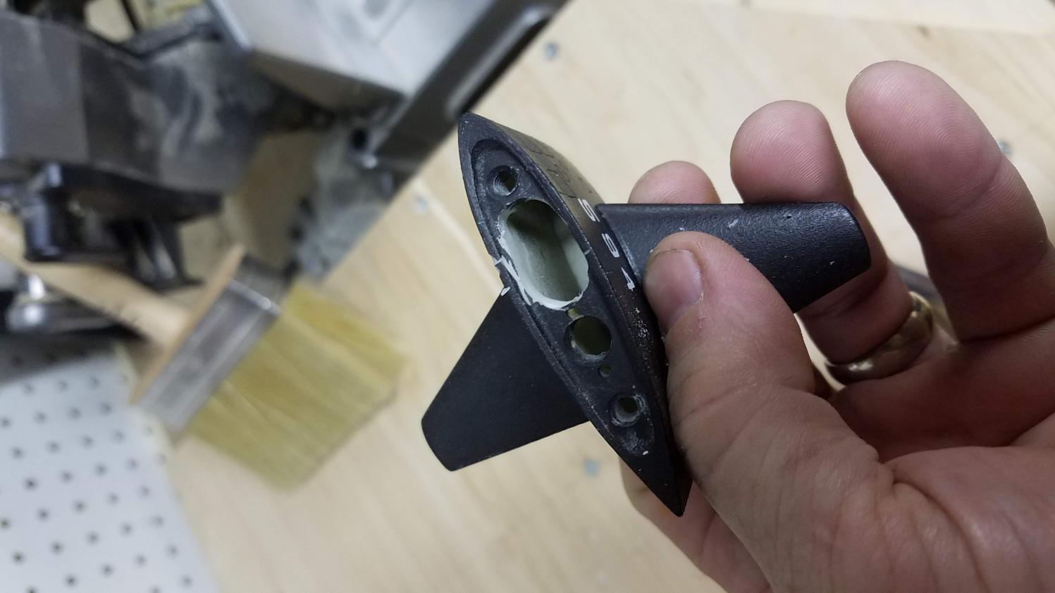

    On a fun note, the old dogbone interface and collar had been installed with regular metal grub screws so they were completely rusted on. Yours truly got the brilliant idea after stripping out the heads, that he would use a torch to get them off while the shaft was still on the boat. Disaster was narrowly avoided when I realized that was a really stupid idea right as the torch got to work. Luckily the prop was held in with a stainless grub screw so I was able to take the prop off, and then remove the shaft and get the old parts off.

    I would remove the rear bulkhead entirely. In it's place put either a small bulkhead or a pin in front of the dive module. This would provide something for the module to 'push' against while moving forward. If you only use a rear bulkhead, the module would likely creep forward resulting in the dog bone separating and the stern planes being out of adjustment.
    p.s. drop me a line if you'd like to get together before the 20th to work on your boat.
      I have never used pins to hold the wtc in place.
      I do make plastic blocks that are glued in to the hull on the keel line.
      1 goes in front and 1 goes behind the wtc once I fine the location I want.
      The blocks are usually about 1/4" wide, 3/4" long and tall enough to get 1/4" on to the end caps.
      The front block has a slight taper to it to push the wtc tiht against the back block.
      Lift the wtc cylinder up at either end by 1/4" and the wtc is free to move in either direction.
      No holes drilled in to the wtc or caps for pins.
      Wtc held down with velcro strap mid cylinder.
      I have never had a cylinder rotate in my boat but if it did, I would add 2 blocks to the front end cap to index the hull block.
      Takes me about 10 minutes to shape and glue the blocks in place.
        As you are seeing there are many ways to skin a cat (as horrible as the saying is [I like cats]), looking at what you have, All the above suggestions work. I have David Merriman's Sub-Driver, but I also have Big Dave's, Will Oudmayer's, and my own WTC (there are other's but that is not important).

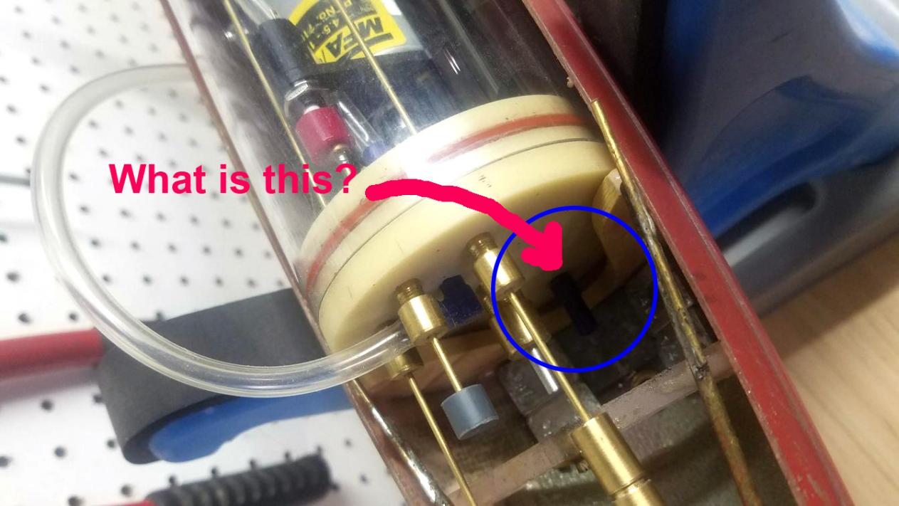

        Looking at your picture, there is something dark.
        Is that attached to the bulkhead?
        If so, you have a built in pin, build a wall on each side to prevent rotating.
        If you still need a pin, the rear bulkhead could have a small hole that does not go deep, but can accept a 1/16" pin from the bulkhead already there. The removal process would be lift the front over the small block you need to install and pull the cylinder forward, disengaging the small pin. Does that make sense, never sure if I am being clear as mud or not.
          • 684
          Mike,
          Tom has it nailed. The "dark thing" sticking out is the water inlet to the pump. Put a small, low bulkhead right behind the cylinder, with a notch in for that inlet tube to rest in to prevent the cyl from rotating. Take a look at the build article for the R&R Seawolf conversion in the June issue, it's quite clear there. Add another small restraint as Ralph has described in the front of the cyl and job done!

            Thank you everyone for all of the quick responses,

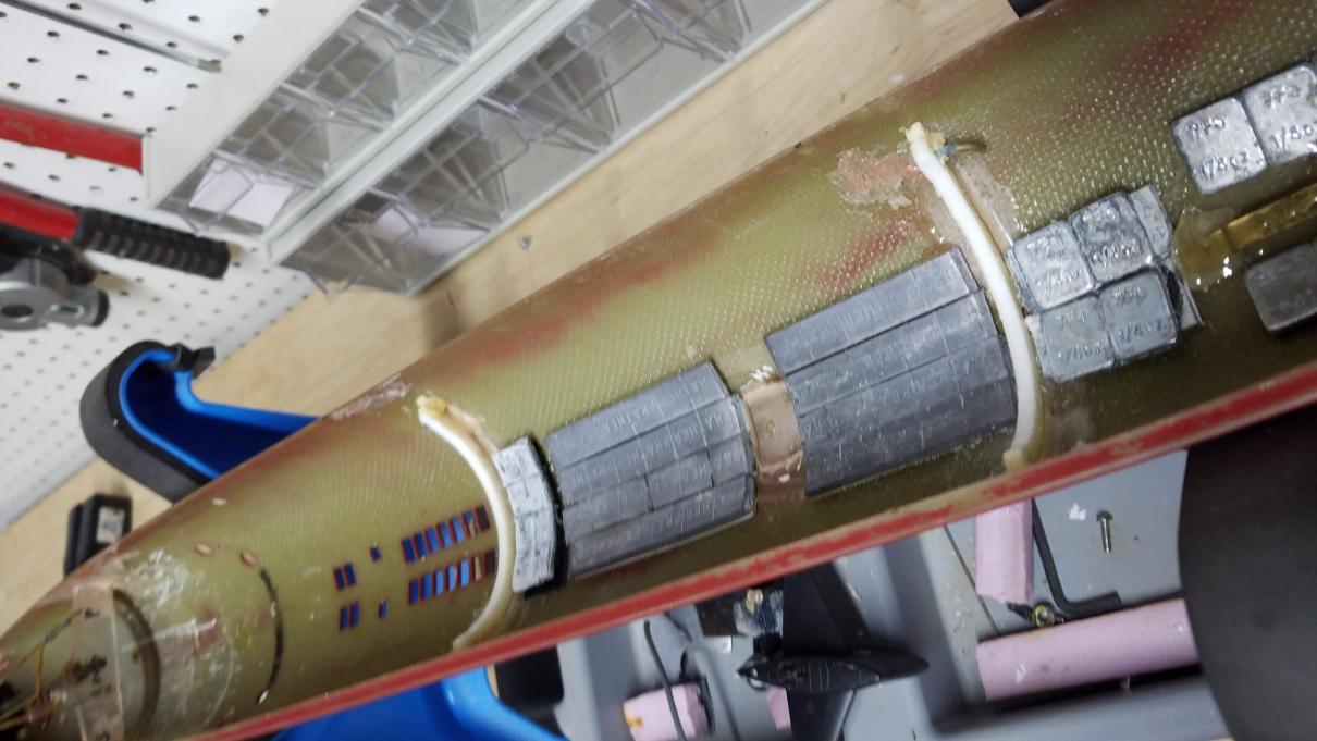

            Jeff I am taking all of the advice and got started last night, by taking out the old bulkhead, clearing out a lot of the old stuff that no longer serves a purpose. I'll def drop you a line asap to set up a time to meet. I just ordered a bunch of new electronics for the WTC, so I should prob plan for after they arrive.
            Ralph I like the small bulkhead idea, so I am going to do that with a Velcro strap. Tom I was worried that the plastic inlet might be to weak to use as an index, but it sounds like Jim has had no problem with it so I'll use that.
            Jim thank you so much for the build guide. That makes life on this so much easier, I wish I had read it sooner! And I would have never realized about cutting the lead on the second speed control.
            The only real issues are that my WTC did not come with the Drive shaft coupling, and I need to fashion a similar bulkhead set up for the dive planes. I am hesitating to replace the bulkhead that has the forward bearing for the shaft, for alignment reasons, but it prob needs to go as I need the space for the dogbone set up and dive plane assembly.
            I trimmed the existing saddles down, so now the cylinder fits very nicely in the hull (even if a bit tight bow to stern). I will add the velcro strap to the center, and I will need to relocate the weights up front to add the small bulkhead.

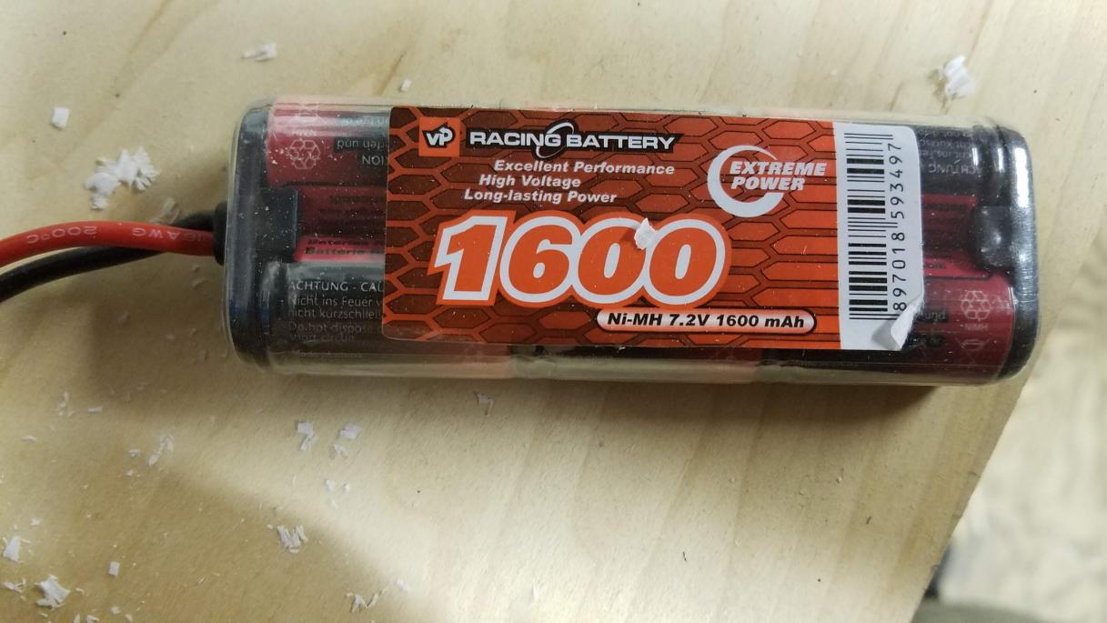

            The battery that came with the WTC is an odd 95 mm form factor for a 7.4v ni-mh battery but I wanted to get another one with more then 1600 mah. An 11v is a problem as I looked up the specs on the motor and it nearly doubles its rpm to 12000.
